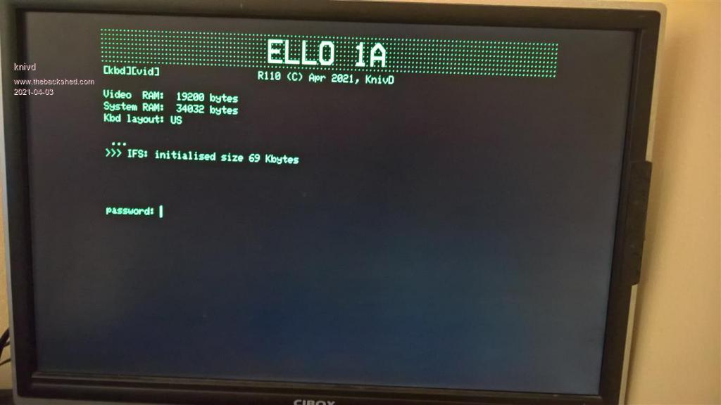

Just released on the website a new software update. This is a bigger one so it jumps straight to R110.
The most important change - the video is 80-column text now.
Here is the screen immediately after first programming.
Frank N. Furter
Joined: 28/05/2012
Posts: 1153
Posted: 03:50pm 03 Apr 2021
The screen output looks good!
My AUTOSTART no work anymore:
(ERROR 49) line1: unknown directive
#pragma LAYOUT1
".k DE" does the job, but upper and lower case is important...
CTRL-C no work anymore - I can no longer break a program! (But I get hearts on the screen - tested with your checkerboard pattern test program)
The arrow keys no longer work (I only get strange special characters displayed)
With terminal:
The arrow keys seem to work.
CTRL-C behaves even worse: the whole screen (of the external monitor) is filled with hearts and the program cannot be interrupted. (also tested with your checkerboard pattern test program)
:)Frank
knivd
Joined: 07/09/2014
Posts: 73
Posted: 04:01pm 03 Apr 2021
Ugh, sorry about the arrow keys. I know the problem and will fix it straight away
#pragma is not supported anymore (see the change log).
Did you by any chance use .^ ?
Try .^3 and see if that will fix the Ctrl-C situation
I don't understand the comment about upper and lower case. Can you explain, please?
PS. should be fixed now and the file is on the website
Edited 2021-04-04 02:15 by knivd
