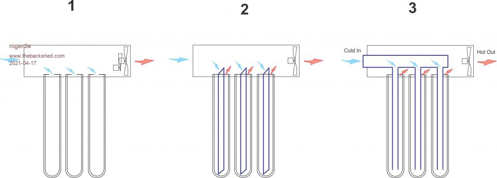

My parents had an evacuated tube water heater on the house for a number of years. A friend of my Dad was bringing them in from China so they ended up with it for cheap or free, I'm not sure.
The interesting thing is that it never had any heat tubes. The evacuated tubes were simply inserted in holes along the tank, and filled with water as the tank was filled. I guess it relied on a thermo siphon of sorts, as the water in the tube was heated it would rise out of the tube and draw cooler water in from the tank.
Although it did work, it wasn't as good as I thought it should be, given the reputation of evacuated tubes. I always figured having hot water rising out of the tube and cold water trying to get in at the same time couldn't be very effective. That being said, it was only pulled off the roof after a nasty hail storm smashed it up a bit, and insurance coughed up for a new one.
I'd never heard of heat tubes before reading this thread, so it makes me think that maybe it was supposed to have them but they were missing. I always though it would be better with a pipe run to the bottom of each tube, to force cooler water right to the bottom, without interfering with hotter water coming out of the top.
Its still tucked away here somewhere so I think maybe I should do some experimenting with some of the tubes.
All this is to say that maybe there's a way to heat water with the evacuated tubes, without the hassle of building 30 or more heat tubes.

  Jacob89 said  My parents had an evacuated tube water heater on the house for a number of years. A friend of my Dad was bringing them in from China so they ended up with it for cheap or free, I'm not sure.
Very helpful post thanks Jacob, I did wonder if they might work without heat tubes/heatpipes.
  Quote   I always figured having hot water rising out of the tube and cold water trying to get in at the same time couldn't be very effective.
That was my thoughts too.
  Quote  I'd never heard of heat tubes before reading this thread, so it makes me think that maybe it was supposed to have them but they were missing. I always though it would be better with a pipe run to the bottom of each tube, to force cooler water right to the bottom, without interfering with hotter water coming out of the top.
Yes, agreed 100%. And whether that is to heat water or air  ...  I think it would still have to work better with a pipe down the centre to deliver the colder fluid and allow it to collect heat on the way back out.
  Quote  Its still tucked away here somewhere so I think maybe I should do some experimenting with some of the tubes.
Yes, great idea if you have any ideas for getting some free heat. At least being free your initial experiments don't have to cost too much.
Having said that, if I do put plain 1 inch copper pipes down to the bottom of 30 tubes  ...  it's likely to cost me $700+ just for the copper  ...  so I have to be certain that is what's needed.
Of course I can use plain steel tubes and can get the price right down  ...  but not quite sure yet. Need more experiments first.
  Quote  All this is to say that maybe there's a way to heat water with the evacuated tubes, without the hassle of building 30 or more heat tubes.
Agreed again. I do have a gut feeling that heat tubes help provide the highest output for an evacuated tube system  ...  but in my research I've seen them built as you described  ...  and also with a continuous copper pipe that travels to the bottom of a tube  ...  does a 180 (very tight bend) and returns to the mouth and on to the next tube.
Disregarding the efficiency of heat tubes, they also have the advantage that you don't need to worry about sealing each evac tube against water leaks  ...  though obviously that has worked ok for your parent's heater.
In fact, being able to avoid dealing with seals between evac tubes and the tank may be the main advantage of heat tubes  ...  and not their efficiency
...  plus with heat tubes, the ends can plug into the mainfold without any risk of leaks, because the heat is transferred metal to metal and not metal to water. Makes building a heater so much easier and hopefully leak free

  Solar Mike said
You are correct, some very low pressure systems run the water direct into the inside of the glass tube. On these the tank usually lies on its side with a large connection manifold containing silicon rubber sleeves, the evac tubes push into the sleeves making a water tight seal. I have seen them used at dairy cow sheds sitting on a steel frame ground mounted as its not really recommended placing 300Kg odd of water tank on the roof. They don't last long, haven't seen one of those in years, suspect lying in sheds somewhere broken and unused.
Thanks Mike, that makes sense that it could work with low pressure otherwise with high pressure you could have leaks everywhere.
I also had considered having the evac tubes on their side but in a vertical stack  ...  all plugged into a manifold  ...  allow the cold inlet at the bottom and draw hot air off the top  ...
...  though as Jacob already pointed out, I think it needs a tube to the bottom of the tubes to allow cold air to travel in and gain heat on the way out.
I guess I should try that with a couple tubes.
Cheers,  Roger
Posted: 03:42am 17 Apr 2021
To conduct the heat out of the collector and into something else may only require a solid metal bar.
Not as efficient as a heat pipe, but it should work. Aluminium is cheaper than copper, but it might be worth a try. Solid metal bar is rather expensive though...

Perhaps a tube would be better and give more surface area?
I think a hex is best of all.
From memory, the heat conduction of ally and copper are very close anyway.
rogerdw
Joined: 22/10/2019
Posts: 957
Posted: 07:20am 17 Apr 2021
Yeah, still trying to work all that out.
I know if I stick my finger in the open end of the tube it can feel nice and warm  ...  but if I touch the inner surface my finger comes off real quick. There is certainly a lot of heat in that inner surface. I've seen 200 degrees C on a warm day using a traditional glass cooking thermometer.
Of course if there was a lump of metal in contact with it, it probably won't be able to maintain that temperature  ...  depends on it's mass  ...  and how quickly the heat can be bled away.

Doing a bit of mental arithmetic wrt the tubes on their own...
If they were filled with water and nothing else in them then i see the water heating up. It will have to rise, convey the heat to cooler water or it will heat till it turns to steam... which I dont think is at all likley.
Given the assumption of one of the other 2 scenarios, once the heat is in its going to be difficult to get back out through the tube which is the reason its vacced. Like the window scenario Mike explained, semms oncenthe heat is in the tubes,its in and the water is warmed one way or the other.
It the water is stagnant, the only way it can dissapte its energy i can see is one of those 3 ways. In that, the water can only get to 100c and then the energy is passed on. The tubes may run hot but the temp is limited and the losses as such can only be the amount of energy it takes to heat the waterbin the tubes to a max of 100c.
Other than that, the energy has to go somewhere and if there was colder water circutating past the end of the tubes I feel it would end up there one way or the other.
Thats my theroy anyway.
Thinking it through with air, a quandry. On one hand i see the working medium being little different as i believe thats the scientific principal. Air could get much hotter but is also a lot less dense so the " retained" energy in the tubes would probably be similar. At some point I see the air reaching a critical temp where it either thermosyphons or conducts the heat away. I cant see it sitting stagnant indefinantly.
Using tubes within the tubes might be as simple as bevel cutting the ends on opposite sides.
If  the top of the insert tube was faced toward the incoming airstream, ti sgould cause a positive pressure inducing the air down the centre of the tube to the bottom.  The heated air at the bottom would want to rise creating a negative pressure like a chiminey pulling cool air down.
The area at the top of the tube behind the bevel cut would also be a negative pressure zone further aiding the warm air rise from the bottom of the tube.
The bevel cut at the bottom end of the insert would keep it off the bottom of the gas tube so the air could flow and may help seperate the airstreams to each side. The angles may want to be at 90o so the top facesvthe incoming air flow  and the bottom bevel is to the top of the tube where gteatest heating and natural rise will be.
Hope that is understandable.
Both the water and air heat paths seem Would seem viable in my tiny brain.
I have setup Themosyphoning systems on engines and it is far more powerful than i would have ever given credit for previous to doing it. With a bit of aerodynamics thrown in to aid the gas flow scenario, I see it as a creditable  working soloution.
Interested to hear what the knowledgeable people think.
I'm sure air and water would have similar flow patterns, just don't know what they'd be.
  Quote  Using tubes within the tubes might be as simple as bevel cutting the ends on opposite sides.
I hadn't thought of the beveled top, that's a good idea.
I started off thinking that maybe the venturi effect might come into play, but that seems quite different to what we have here  ...  especially seeing we cant open up the bottom end and let air in from there.
  Quote  The area at the top of the tube behind the bevel cut would also be a negative pressure zone further aiding the warm air rise from the bottom of the tube.
Again, that does sound feasible.
  Quote  The bevel cut at the bottom end of the insert would keep it off the bottom of the gas tube so the air could flow and may help seperate the airstreams to each side. The angles may want to be at 90o so the top facesvthe incoming air flow  and the bottom bevel is to the top of the tube where gteatest heating and natural rise will be.
I'll attach some diagrams below.
  Quote  Interested to hear what the knowledgeable people think.
Haha  ...  me too.
Cheers,  Roger
