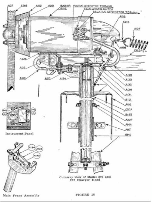

This picture is a parris dunn 1950's era. The generator lifts up in a strong wind to furl.

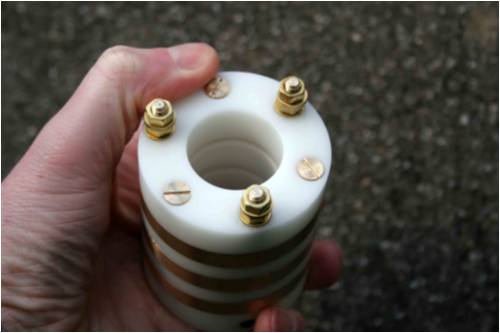

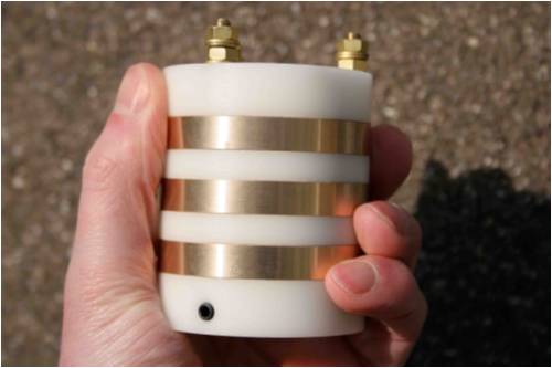

I used delrin for the insulator in my slip rings and my brushes are a custom blend of carbon, graphite and copper. I never found off the shelf brushes to transfer power efficiently, last a long time and and self lubricate without leaving residue and scoring on the ring surface. Brushes are a science all of their own.
