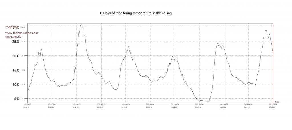

rogerdw
Joined: 22/10/2019
Posts: 957
Posted: 03:52pm 06 Jun 2021
Some encouraging results Dave, well done. I know winter's supposed to be cold and gloomy, but I am surprised how many good days we do get. Cold maybe, but still a reasonable amount of light.
The dark days are almost enough to put you off  ...  but the good days keep you going.
  Quote  I have also seen somewhere these little plastic standoffs. The ones I have in mind were white, about the size of 2 Bob and had 3 or 4 legs like a table.
They're not the little spacers they use in pizza boxes to keep the lid from sagging onto your pepperoni and cheese?
Aaron, since you mentioned the air temp in your roof cavity being worth harvesting, I put a datalogger in my ceiling about 30cm under the peak to see what ours was like. We have black tiles, so would have thought it would be reasonably high.
After 6 days I took it out and downloaded the results. Definitely a dead loss for our house. Temps were very poor.
Cheers,  Roger

  Quote  After 6 days I took it out and downloaded the results. Definitely a dead loss for our house. Temps were very poor.
And you have black Tiles? Sarking under them I presume?
Can't get near my roof in summer, Mt recollection of winter temps up there were not promising as well. I'll check again but given your results tie in with what I remember....
Like Inverters. Get hot enough to fry eggs on if uncooled but it winter with very similar power running through them they are barely warm.  The temp difference is in no way Linear to the ambient difference that's for sure!
I thought about putting a couple of them in the laundry which is right behind them last year  but when I looked at the temps they were running at, no heat to be had.... when you want it of course!
I expect the en suite will be cold as ice tomorrow morning.  Zero here atm and I can feel the place cooling despite having the diesel heater going.... which I just kicked up a notch.

  Quote  The test setup was working today in the clear warm sun, the first since last weekend I think. Most of the days here have been cold and overcast with a couple not reaching Double Digits.
Sounds like we're a bit luckier than you. We had one dud day this week and a couple that had a slow start but came good at least for a while  ...  but today was an absolute ripper.
From 10:15 - 15:45 it stayed above 30 degrees and reached 39.2 at the peak. That's 5 and a half hours with the fan on its highest speed. Got almost uncomfortably warm inside  ...  but I'll take that.
Can't wait to hear your results with the next lot of tests. Good luck.
