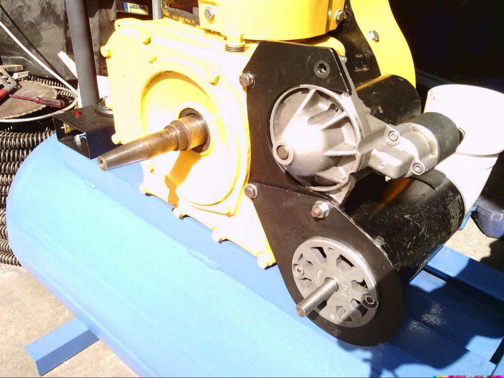

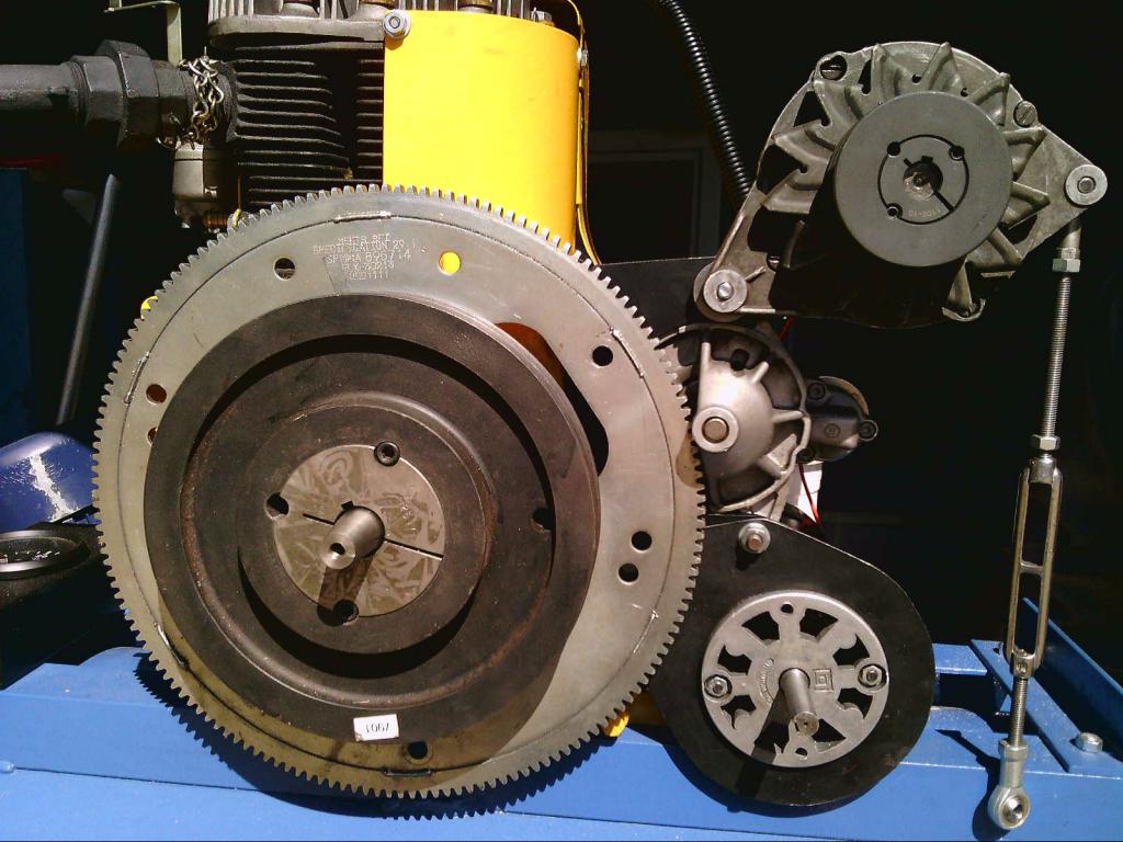

What I did on the Wisconsin was fit a second heavy flywheel to the output shaft of the engine. It really needs the extra flywheel mass at only 1,000 rpm, but it also gave me something to bolt an automatic transmission flex plate onto.
The business end of the engine block also had some convenient threaded bosses and holes to which I could bolt my starter motor and alternator.
The original flywheel and cooling blower at he other end, with its evil rope start, does not offer much in the way of solid attachment points. Its just a light sheetmetal cover for the cooling blower to direct air around the barrel and cylinder head.

Never seen a taper lock pulley on an alternator before. Thats a great idea. I have a strong preference for the internal fan alts because I have done every torture test I can think to the things and never been able to break one. They have 2 fans, one for the windings and one for the electronics cooling.
So looking at the pic, did you sandwich the flexplate and Flywheel on with the Taper lock and I assume make up bushings to locate them with the engine keyway??
I see we use the same idea and method for belt tensioning. The Turnbuckles work Great though I have to wire the ones I use to stop them coming loose.

The Wisconsin has a reasonably long section of one inch parallel shaft with a taper on the end.
The original 230v alternator shaft had an internal taper to jam it solidly to the end of the crankshaft as a very solid extension, with a very long draw bolt to keep it all up tight. There was then just a pretty small ball bearing at the extreme end of the alternator shaft. Cheap and simple, but it seemed to work.
That is a two groove nine inch pulley, and much heavier than the original Wisconsin flywheel that is still there at the other end of the crank.
The taper lock fitting grabs pretty tight, I did not bother to take the crank out to cut a suitable keyway, although I will if the engine ever has to come to pieces.
Looking at the picture of your diesel, the flywheel should come off if you remove the big nut. Then set it up in a lathe along with a suitable flex plate so it all runs true.
Then re drill the three holes in the bosses right through both flywheel and flex plate. Bolt it all together, problem solved.  If you are lucky there may be a means of spigoting the flex plate onto the flywheel at the back. I did not bother, just three  6mm bolts, and the flex plate runs within just a very few thousandths of both eccentricity and run out.
The starter can then project outwards like a sore thumb.
For correct rotation you will need a starter off something that has the starter fitted on the engine side of the original bellhousing.
