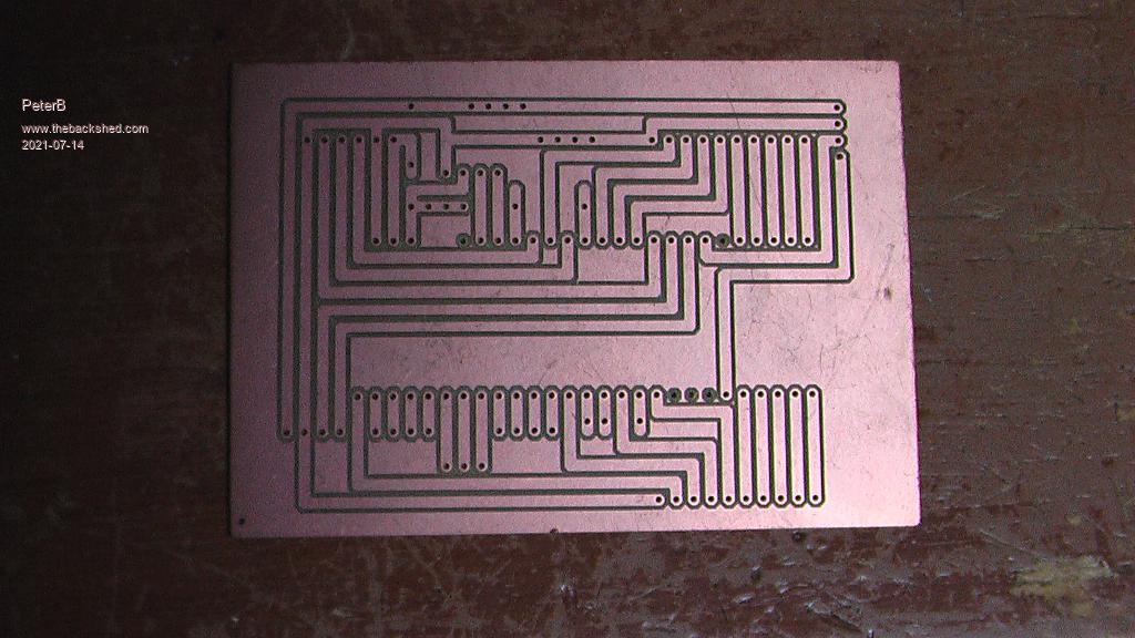

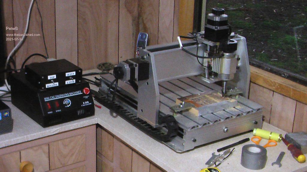

Posted: 07:54am 14 Jul 2021
I have been using this system for quite some time with no real problems after the initial "OH DEAR"s
It was fairly expensive at the time although Nancye promised to pay for it, She never did.
It's the sort of thing I can sit and watch for hours.

PeterB
Joined: 05/02/2015
Posts: 669
Posted: 11:32am 14 Jul 2021
G'Day Plasma & Aaron
My CNC cost several hundred dollars several years ago so I think yours is better value however I can claim that mine is bigger than yours
Also, it was very wrong of you to mention 3D printers because I am a very old, weak, man and have been resisting buying one for years. Just think of the damage you may have done.
