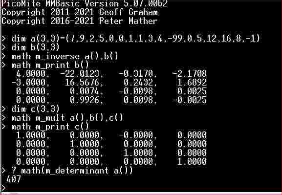

V5.07.00b2
PicoMiteV5.07.00b2.zip
Added maths goodness
function MATH(M_DETERMINANT array!())
command MATH M_INVERSE inarray!(), outarray!()
Posts: 4398
