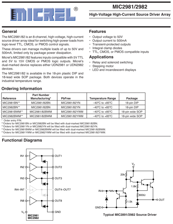

Tinine

PeterB

Posted: 10:13am 24 Jul 2021
G'Day Tinine et al
That is a bit light on for current but other than that it comes down to cost / convenience / availability / personal preference / etc.
Peter

Solar Mike
Joined: 08/02/2015
Posts: 1252
Posted: 11:18am 24 Jul 2021
  PeterB said  G'Day Tinine et al
You can parallel the inputs\\outputs for extra current.

PeterB
Joined: 05/02/2015
Posts: 669
Posted: 11:35am 24 Jul 2021
G'Day Mike.
Yes you can but I have always been a bit nervous of connecting things in parallel because you can never be sure how the current will share unless you install an R in each leg and determining the value leads to insanity.
I do think using an opto-coupler is a good idea when connecting micros to the outside world.

Tinine
Joined: 30/03/2016
Posts: 1646
Posted: 12:44pm 24 Jul 2021
  PeterB said  G'Day Mike.
Peter
Hi Peter,
It's common practice to parallel the channels of these devices; it all boils down to the total dissipation.
I would probably use 4 channels for the 900mA and just because they are available, 2 channels for each of the 100mA loads.
Bearing in mind, also that; these are flashing lights and so, presumably, 50% duty cycle?
If opto is a a requirement then there is the TLP350H which will accomplish everything (2A).
