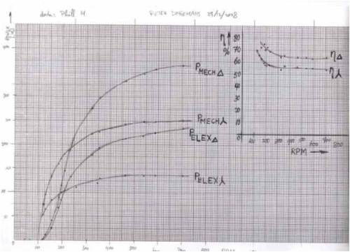

You've obviously spent a lot of time building your nice setup and then making accurate measurements. So I'm surprized you didn't make the next logical step by graphing the data and interpreting the results. I don't know about you, but the table with numerical values that you 'barfed out' in your last post is pretty useless to me. A shame, after all that effort you've put in.
It left me dissatisfied enough to decide to graph the data myself for my own benefit. After I did so I figured I might just as well post it here for the rest of the forum.
Based on your original data I calculated mechanical input power for both star and delta, electrical output power (using a constant voltage of 52V) for star and delta, and a smaller extra graph showing efficiency in both the star and delta configuration. See below.
(high-resolution graph can be found here: http://picasaweb.google.com/motorconversion/Temp#52852022292 81633810)
It's immediately obvious that efficiency in delta is much higher than in star, by about 10 percentage points. Not a little... Also, efficiency remains basically constant at the higher RPMs, as opposed to my induction conversions, where it seems to keep on falling as speed increases.
Also the (what I assume to be) inductive-reactance limiting effect is very clear, as the curves flatten at increasing RPM. If we look at the situation in star for example, then both the mechanical shaft input power and electrical output power are constant above ~550RPM. In delta the real flat area seems to fall off the graph, it must be above 700RPM. Because of this inductive reactance limiting it's very important to make sure the windturbine furls in time, as otherwise it will overspeed.
The graphed results should also be a big help in deciding (based on your local windsituation) whether to connect it in star or delta.
Curious as to what the others have to say about the results.

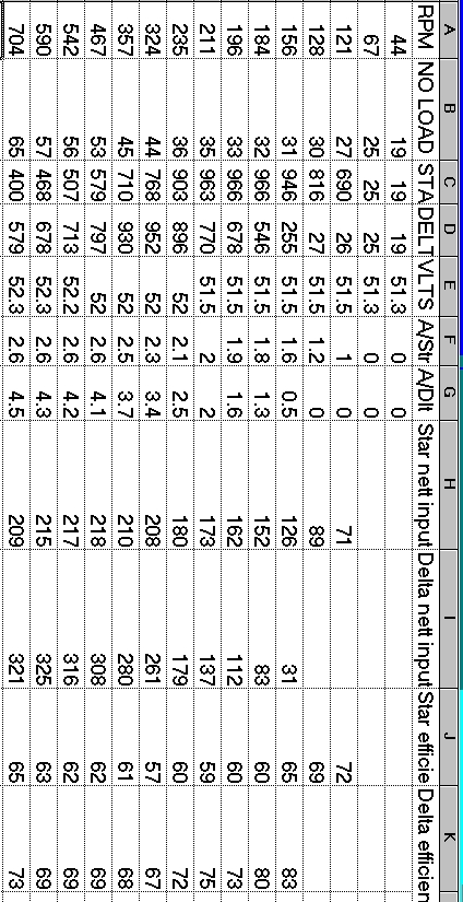

So there we have it, my effort with Phill's numbers.
I have calculated the nett input as the difference between the loaded and unloaded conditions which excludes things like bearing friction and windage.
The efficiency is the ratio between this nett input and the DC output. As you can see these are not very high though you will note Peter D's earlier observation that delta is much higher.
Where does all that lost energy go?Edited by KiwiJohn 2008-12-31

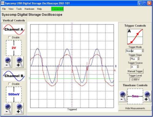

I have done some testing of the "current" output waveform.
I had to insert a series resistor and measure the emf across it, in a single winding, to avoid complications from the other phases.
There is a significant distortion to the current phase in relation to the voltage. The blue trace is the current. I have not seen any real changes to the waveforms yet in cap testing.
Gordon.
become more energy aware
KiwiJohn
Joined: 01/12/2005
Posts: 691
Posted: 04:50am 30 Dec 2008
Gordon, it looks like the voltage is pretty severly distorted by something? I think the current has a much better shape due to the smoothing effect of the stator inductance. However your readings are of great interest as the current and voltage does appear to be in phase so power factor is actually pretty good!
Do you have capacitors in this circuit? If not, there goes the theory that capacitors bring improvement by improving the power factor.
I suppose adding capacitors would help the voltage wave shape, using the simple theory that inductors smooth current and capacitors smooth voltage.Edited by KiwiJohn 2008-12-31
