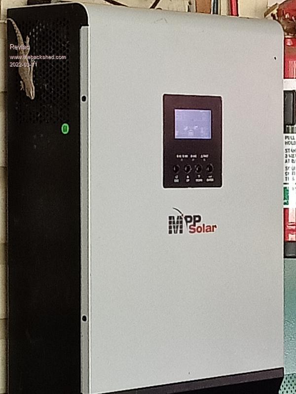

On your inverter, the direction of airflow from the fans, do they force the hot air out the bottom (most did) or out the top?
Most people have changed the fans so the hot air exits out the top.
Can see the little monster on the fan vent enjoying the heat, best not to let them get into the inverter.

revlac, if those things were gone, most grubberment contracted Eleccys would be out of a job... they destroy thousands ( dare say way more) in electronic equipment every day... sooo many times we would lose a air con etc from a fried gekko or their poop..
I think it works !!

They have been responsible for burning a hole through someones inverter board (despite the conformal coating), they can fit through the power in/out hole on these units, I do my best to plug any holes, keep the buggers out.
Had a few of them whacked by the fan in the aircon......Damn things stink like hell...and some....for something so small.

What is the benefit of exhausting the heat out the top and reversing the fans?
Is that for convection?
I have  radiator fans on my GTI's blowing from the top to the bottom because it goes against convection and I think the resistance, as nothing as it may be will help pick up heat.
The fans are solar powered and direct connected to panels so as soon as there is any worthwhile power the fans are blowing. Even though these are essential sealed units with no internal venting, having the fans blowing over the whole casing as well as the heatsink at the back makes for a huge difference in inverter temp with and without the fans.

Mostly for convection, The top left side is the hot spot, has the choke and IGBT heat sink, at least for the older models, the newer version I expect it would be similar perhaps.
One old one in the shed the fans are very slow and I put a fan on the top outlets to help, the fans on the inverter that runs the house they rev up as the load increases and remains quite cool.
