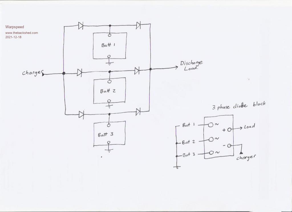

Posted: 10:30pm 17 Dec 2021
I think this would be a real challenge even with brand new batteries.
With a mixed bag of batteries in unknown and possibly questionable condition, the odds are really stacked against you.
Batteries in parallel mean that if one dies, it will likely kill its neighbors too.

Posted: 11:58pm 17 Dec 2021
You could always do something like this :
Three batteries in parallel, but they cannot discharge into each other if one craps out.
It could be done very easily with a standard six diode three phase rectifier diode pack.
Six, nine or any number of batteries could be connected up this way.
Edited 2021-12-18 10:02 by Warpspeed

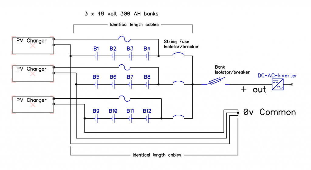

This is how we have wired our 48 volt 900 AH bank:
Each bank has its own 60 amp charger, all cables back to the inverter bus bar common connection are same length.
When I worked installing large banks of telecom batteries at micro-wave sites, where there were maybe 6 x 48 volt banks all in parallel, this was the method of wiring; never had any issues with uneven charge\discharge.

Warpspeed I think you would need some bleed resistors across the input diodes so the charge regulator can measure the battery voltage, and get power, after dark. Plus the diodes would need to dissipate some serious watts.

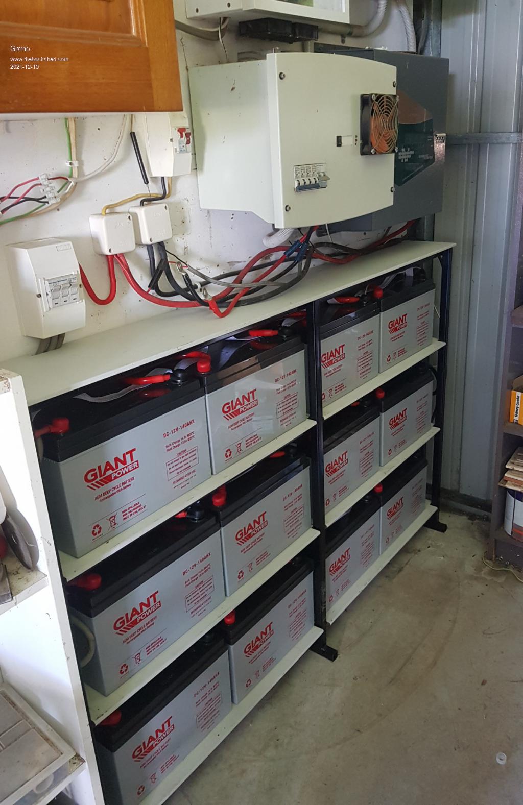

My batteries have arrived and its all assembled. The leads are equal lengths for each series. I have a 100amp circuit breaker per series.
I'll keep an eye on it and check the currents for each string under charge and under load. A difference in current between strings will be a good indicator of uneven batteries, something a microchip with wifi could monitor.
Posted: 03:48am 19 Dec 2021
  Gizmo said  Warpspeed I think you would need some bleed resistors across the input diodes so the charge regulator can measure the battery voltage, and get power, after dark. Plus the diodes would need to dissipate some serious watts.
With my system the inverter is fed from three diodes, from three separate sources.
Straight from the panels, from the battery, and from a grid powered rectifier (when its switched on).  Yes the particular diode doing the work gets hot, but its only about 1% of the total power being lost in the heat sink.
I only have one battery, and the solar controller is connected directly to it, so the problem does not arise. If I had multiple batteries, I would probably fit multiple solar controllers fed from the same panels and no charging diodes.
But you are quite right, the charging diodes could (should?) be shunted with resistors.
The current required to run the solar controller at night will be very small, and voltage measurement not of any importance at night.
