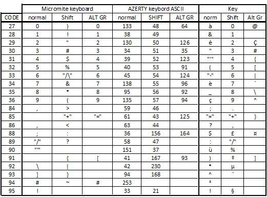

Posted: 04:22pm 31 Jan 2022
  matherp said
  Quote  it is ascii 156  (pound key)
MMBasic only supports code up to 127 so pound symbol has never been supported even in the UK
ok no pb
I found also problems with key code 84 and 86
in 84 it must be ascii 59 and 46 for "+Shift"
in 86 it must be ascii 63 and 44 for "+shift"
keyboard.zip
Edited 2022-02-01 02:25 by goc30
