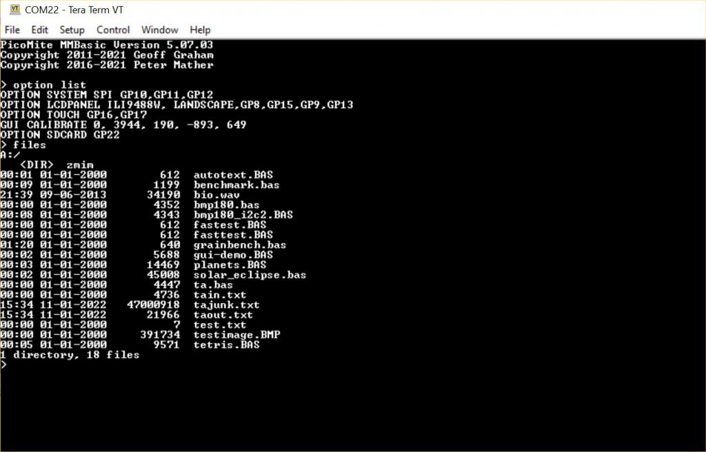

I am trying v5.07.04b1 (non VGA) with the Waveshare PICO-ResTouch-LCD-3.5
LCDPANEL and TOUCH work fine, but I've had no luck with FILES from SD.
Have not yet tried with prior versions, so could be a defective panel.
Microcenter 32GB, FAT32, default block size, grain.bas already there.
My PC gave no trouble formatting/writing/reading with a generic reader.
OPTION SDCARD GP22
OPTION LCDPANEL ILI9488W,L,GP8,GP15,GP9,GP13
OPTION TOUCH GP16,GP17
I tried this first, but FILES finds no SD card.
OPTION SDCARD GP22,GP5,GP18,GP19
As suggested by @flasherror, but also not working.
This pinout may assume shunts in position B, SDIO?
Though mine were factory soldered in position A, SPI.
Socket feels good, clicks in and out properly. Oriented pads toward board.
I haven't yet buzzed from Pico to SD to confirm how pins actually route.
PC still reads/writes this card fine, so Waveshare hasn't burned it out.
Windows puts one hidden system folder, that's not the problem is it???
I read that folder can be scrubbed from a CMD prompt if necessary.
Is there a way to reset or update SD options, without resetting all options?
Thanks,
Ken KD5ZXG
Edited 2022-02-08 06:47 by KD5ZXG
Posts: 8981
Posted: 08:45pm 07 Feb 2022
try
OPTION SDCARD DISABLE
and, if necessary,
OPTION SYSTEM SPI DISABLE
Also, I bought 2 microSD cards a while ago and couldn't get them to work (with an adapter) in the socket on the ILI9341 display. That has series resistors on the data lines, which is not a good thing with some cards.

KD5ZXG
Joined: 21/01/2022
Posts: 53
Posted: 04:32pm 08 Feb 2022
Continuity between PICO and MicroSD on Waveshare Pico-ResTouch-LCD-3.5 with shunts in factory default [A SPI] position measures consistent with OPTION SYSTEM SPI GP10,GP11,GP12 and OPTION SDCARD GP22. I find no diode forcing LCD chip select high ILI9488 Diode Problem , so the MISO conflict probably doesn't apply.
And though this takes me full circle back to my original settings, FILES now works?!? I don't know why or what fixed it. Still on b1, not yet tried b2. Flash had been cleared and options reset before without resolving anything. The only thing I did different this time maybe was OPTION SDCARD DISABLE (not in the manual) instead of OPTION RESET before OPTION SDCARD GP22. Can't say for sure that step was relevant, but SD works.
If MISO and BLIT are there, what problem disallows use as console? I have not disconnected MISO. I see legible text displayed during touch calibration. I've been able to send some of my own text now too. If this were a console, there would be no human problem reading BASIC code from it.
From the PicoMITE 5.07.03rev#3 manual "Option LCDPANEL CONSOLE can be used with SPI displays that support BLIT (ILI9341, ST7789_320, ILI9841 if MISO wired) but scrolling of text on the screen will be slow." "BLIT and BLIT READ will only work on displays capable of transparent text (i.e. using the SSD1963, ILI9341, ST7789_320, or ILI9488 with MISO connected)." Quoted sections do not seem to agree which panels support BLIT read. I assume this feature would be required for the scrolling console?
Testing if my ILI9488W's BLIT can or cannot scroll, BLIT complains "Error: Invalid on this display" and doesn't even appear to try. Is that because ILI9488 <> ILI9488W, or MISO is disconnected somewhere I haven't traced yet, or something else entirely?
Experimental misconfiguration as ILI9841 (not my display) produces a Syntax Error when tried. By that logic ILI9481 (also not my display) should also fail, but is strangely is accepted syntax. I suspect 9841 may be transposed in the manual.

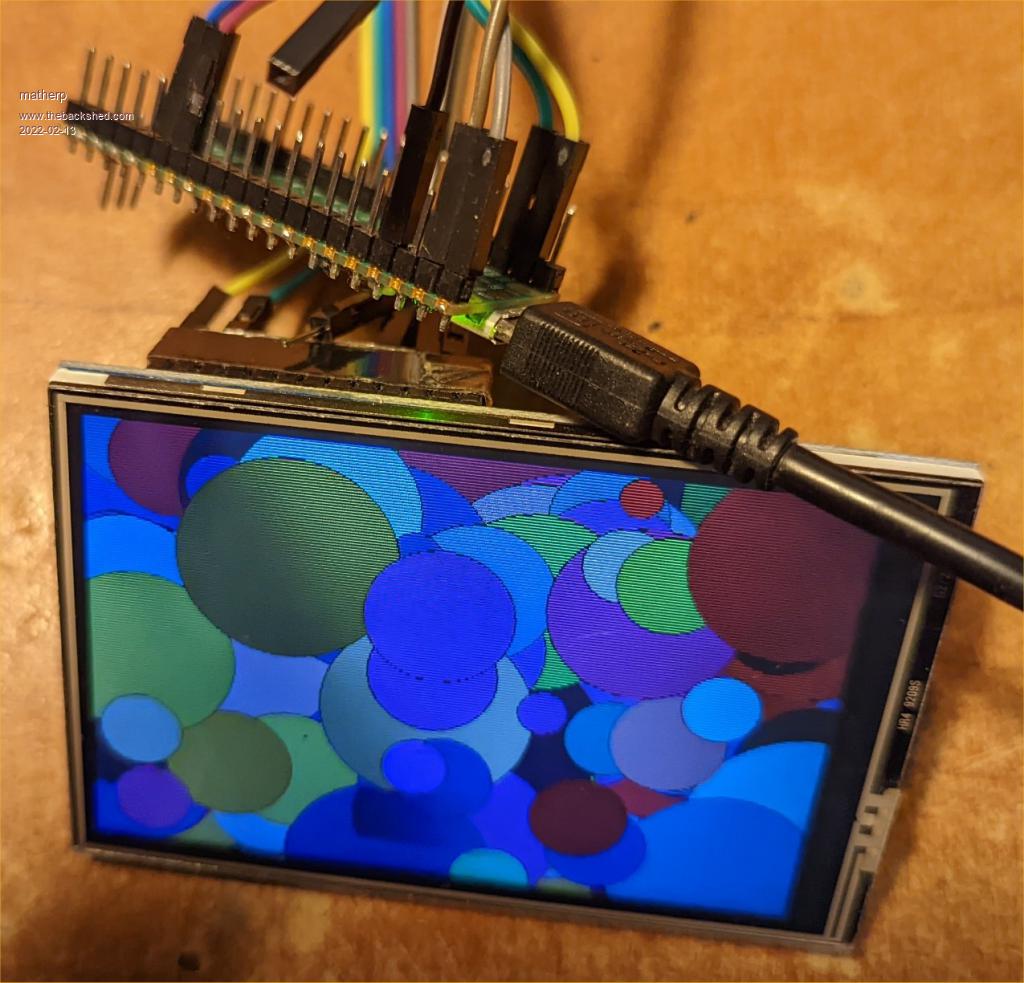

Posts: 11673
Posted: 07:11pm 12 Feb 2022
Just tested this display on the PicoMite and it works perfectly. See this post for correct connection details
My test options
OPTION LCDPANEL ILI9481, LANDSCAPE,GP0,GP1,GP2
OPTION TOUCH GP3,GP4
GUI CALIBRATE 0, 3928, 220, -1304, 867
