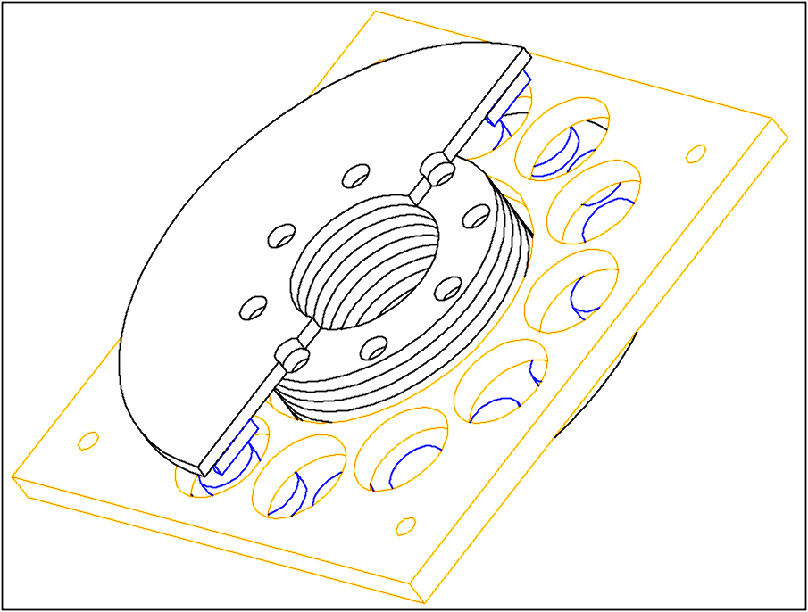

I didn't get far with it. Sorry I can't find it any more on my computer. I started with this (Sorry it's big on screen but the file is small):
And I had started layering in a cross-section so that the flux through the gap could be seen in each of the "holes" in the stator. Of course the colourful picture of gap flux was terribly hard to build and now it seems I only have the FEMM models, not the solutions nor the output numbers, so reconstructing it would take a long time.
To do it, I did not use "hoop" shaped cross-sections around the ring of magnets, but instead "slices" through the axis of the machine. Interesting way to cut it because then FEMM thinks the flux return path goes through the hub! Since the purpose was to get a pretty gradient, not an accurate model, this didn't matter.
I referred to "stacking" because I also wanted to show the density of flux near the magnet faces, in a cross section through the magnets, and yet another in the steel rotor plate.
It never occurred to me at the time to make animated GIF's so I doubt my graphics would have equalled the flair in yours.

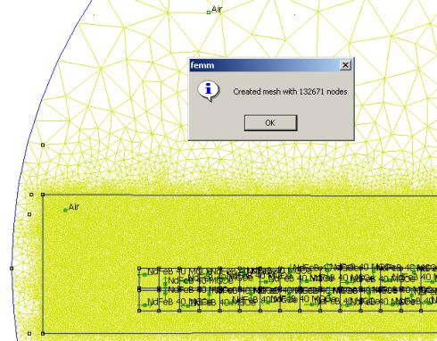

BTW, nice trick with the tiny little gap between magnets and rotor plates. I was about to ask how you got FEMM to make the mesh so fine, then as I was drawing my own I realized that the gap raised the number of nodes throughout the model from 500 to somewhere like 20,000.
How many nodes was your computer chewing on in each of your frames?

[quote=Steven] I was about to ask how you got FEMM to make the mesh so fine, then as I was drawing my own I realized that the gap raised the number of nodes throughout the model from 500 to somewhere like 20,000.[/quote]
There's an easy way to modify mesh density; when adding a property to your model (pressing 'space') you can let FEMM generate a mesh itself (automesh) or you can overrule and specify a minimum mesh density. I normally overrule the setting and set mesh to '1' (in the case of the Halbach array it was even set to .4 for better resolution). This of course drastically increases the number of nodes and calculation time. Most of the models had between 100.000 and 200.000 nodes. I've modeled the 10hp conversion in the past and that one had over 300.000 nodes, IIRC. I usually let the PC work overnight on these things. Recently I've begun differentiating a bit more between areas that I want full resolution and those that can stand lower resolution. This usually drastically reduces number of nodes and computation time. The final model (Halbach array) was optimized for this and had 'only' 132.000 nodes:
For most animations there were 90 (some 130, others 75) frames (and thus simulations) that were made. So all in all it took quite a bit of computing time. Glad I didn't have to do it manually using a slipstick...
One thing I've found is that when FEMM is computing all this stuff, it's best to leave the PC alone; any activity (browsing, accessing the HDD) can cause FEMM to stop saving the data... i.e. it computes (and takes all of the times that goes with that) yet instead of saving 4+MB .BMP images of each frame, it saves tiny empty files of 58 bytes... Not sure what is the cause of this problem (FEMM or Windows), but it has taken me by surprize a few times. So I normally start the script, verify that everything is working properly and then leave the PC alone till it's finished.

Two years ago I put together a "how it works" paper on these axial flux alternators. More as a means to fix the facts in my own mind, but in the end it was easy enough to illustrate and make the text "readable".
AXIAL_FLUX_HowItWorks_V1a.pdf (780 kB)
I like to pass it on to new members on Otherpower, and it's also made the rounds on the internet. I've found it in Dutch and Italian. (The Italian is a teacher who asked for permission to translate it and use it in his course material; I was totally flattered).
While illustrating it, I almost got totally side-tracked with the 3D simulation. I had a picture in my mind where I could show the intensity of the field, seeing "inside" those holes for the stator coils. Looking at the bright magenta colours in some coils would show peak flux linkage in those coils, where the other coils, between poles, would have increasing or decreasing flux. Then I could go on about peak voltage, etc., etc. It just became too complicated to draw.

Wow 300,000 nodes. Apart from making the picture pretty, (smooth curves etc.) do you get significantly different results over, say a 50,000 node mesh?

[quote=Steven]Wow 300,000 nodes. Apart from making the picture pretty, (smooth curves etc.) do you get significantly different results over, say a 50,000 node mesh?[/quote]
Not really, mostly the only improvement is prettier pictures. In rare cases (e.g. simulating for cogging) the high resolution is actually needed to make the noise smaller than the actual signal (cogging) we want to see. But that's just about the only task that really needs it. I'm prepared to pay the price (computing time) just for prettier pictures though.
