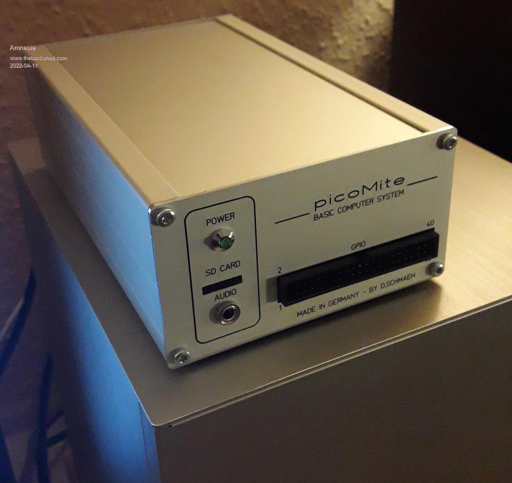

Amnesie
Joined: 30/06/2020
Posts: 763
Posted: 08:21pm 10 Apr 2022
  matherp said  ON ERROR isn't going to be removed. I just think it is often overused in a lazy way and my polemic was always intended to stimulate discussion.
I love to hear that, and you are absolutley right that a second device for the SD card task is the best solution for maximum safety.
  Quote  The CMM2 has never been designed as a process control or monitoring device but the original Micromite and now the PicoMite are/will be used in this way.
Yes I am planning a lot of projects in this way and CNC-milled some cases for this purpose and made a whole new set of PCBs. I LOVE the PICO :) Our laboratory at university got one, too ;)
Edited 2022-04-11 06:23 by Amnesie
Posts: 3879
Posted: 09:12pm 10 Apr 2022
Neat case. Glad to see the 2x20 connector. What's it look like inside?
