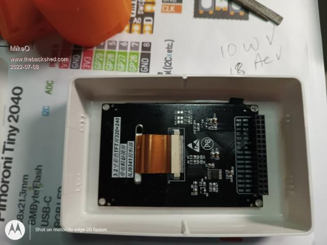

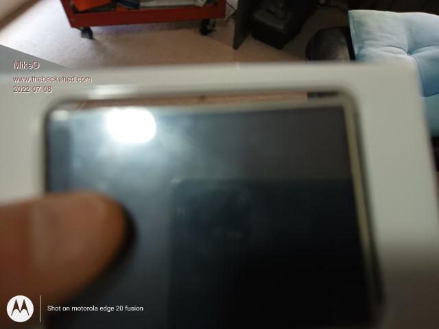

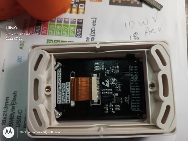

I don't have a 3.5" LCD to hand but I do have a 3.2 ILI9341 (from an F4) whose overall dimensions are very near to a 3.5" lcd (except the screen are is larger of course) So I did a few pics sort of hanging in a Deta raised mounting block cover and it looks as though it could fit its just getting the actual visible screen area inside the nice bezel of the cover, it may be easier to make a 3d printed "filler" to hold the display between the bezel cover and the actual mounting block. To mount on the wall the "block" is screwed to the wall board and then the cover, display/electronics would clip on. Power/data cables could also come through the wall as required.
If there is real interest I could have a go to make an enclosure using the wall plate, if so what actual display are people using and CPU , Pico I imagine, Anyway let me know.

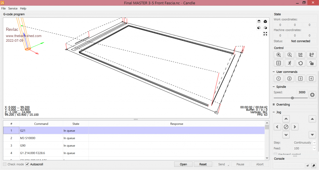

@Mick
Thanks, had another look at the NC file and managed to zoom in and see the corner cuts, had to use an external mouse to zoom in because the laptop one was not working.
I notice the Command M3 S10000, I take it is to start the spindle, That should be flat out.
The M3 command is missing from the Gcode converter program I have been using, will have to sort that out later, often do a test run in a piece of foam, saved me from snapping a new bit.
