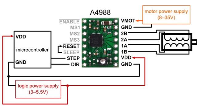

  lizby said  Is there something about those stepper motor driver modules that makes it doable with python but not with MMBasic?
Only thing about Python Is I've seen some sample code and setups to "Barrow" from smarter PEOPLE
  lizby said
Do you have a circuit, as in picomite to module and module to the world? Even a rough sketch.
(Oops, Mick got in there before me. In the circuit he linked, do you need any of the grayed-out pins on the circuit diagram?)
FIRST THANKS Mick
if we look at the Diagram Mick found, the First working Module I'm hoping to plug in to the GPIO port and have 3 or 4 drivers each step and Dir to a gpio pin the Grayed out MS Pins I'd like to see go to Header pins to provide Logic hi and low to configure micro stepping. pins 1A,1B and 2A,2B out to  Screw Terminals  for the stepper, and Screw terminals to access the free pins not used by the steppers

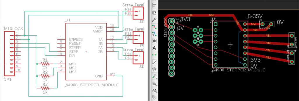

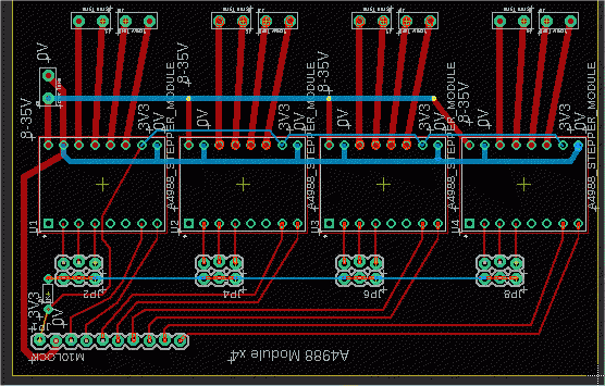

I've played with your A4988 module. Here is a daughter board which would plug into or solder on a board I already have that breaks out 8 I/Os plus 3V3 & 0V--that's the 10-pin header on the left:
If you like it, 3 more A4988 modules can be added below. There are pads for 3 optional pullup resistors to adjust the resolution of the steps.
Anybody else--please point out errors or omissions.

  lizby said  I've played with your A4988 module. Here is a daughter board which would plug into or solder on a board I already have that breaks out 8 I/Os plus 3V3 & 0V--that's the 10-pin header on the left:
Not to be too demanding but the pull-up resistors are SUPER GREAT, but could they be Switched or Jumpered to Switched with the likes of
total of 3 Steppers should be OK per Pico, but it would be more Gooder if we could breakout any free pins to screw terminals for things like end stop switches and rotary encoders or even IR Pairs, stuff like that BUT That is way too GOODER Thanks Lizby
Posts: 3833
Posted: 09:37pm 14 Jul 2022
Rick--If I understand the way it works, I could put a single inline resistor in the lead from 3V3 to what I had as 3 resistors, replace those pads with a 3x2 header, and the shorting plugs would work.
The PCB I have has plenty of pins broken out. If this proof of concept works, I can make a single PCB instead of having this as a daughter board. (You're not intending for this to be a VGA PCB are you?
Otherwise, looks OK to you? I'll wait until tomorrow to add additional A4988 modules to see if anyone else has comments.

  lizby said  Rick--If I understand the way it works, I could put a single inline resistor in the lead from 3V3 to what I had as 3 resistors, replace those pads with a 3x2 header, and the shorting plugs would work.
Yes that should work, so you set micro stepping depending on the Project of the day
I know I'm asking  for the world and all but it would be nice to keep the VGA SD Card, and KB pins open in that order of rubbing the Genie's lamp. (example End Project would be to drive a Leadscrew on a Drill Press, and have the VGA Display attached to Drill Press like a Digital Readout. The SD Card would be nice just for loading and saving programs. and if the KB could be added then so much the better to have 88 more input Switches and a full self contained Dev Environment :) but those are just wishes that can be planned for and built with daughter boards, but it's easier to wish for the whole thing and cut down features than add features unexpectedly :)
  lizby said  Otherwise, looks OK to you? I'll wait until tomorrow to add additional A4988 modules to see if anyone else has comments.
Looks like a winner :) thanks for working on this with me :) and take all the time you no Rush I've been waiting since 1976 for something like this :) I can hold out until the Tricentennial LOL :)

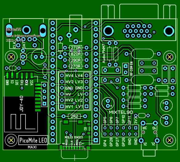

Coming up very soon now - PicoMite LEO Maxi
If you only wanted it for this project you could leave off the JDY-40, all the audio stuff and the linear regulator. This is a baby board - 72x54mm - there's no case. You'd probably have to either have the SDcard internal or 3D print one to fit.
Alternatively, I could soon do something based on this, with the clever bits removed and , if I can route the traces, do a bigger GPIO connector that includes the extra five pins. I can't do a lot with the JDY-40 side, but the other side can be mostly spare space once all the audio stuff is gone.
Using a SSD1963 would be nice, but they are quite expensive to have near a drill and you don't get many spare pins when they are driven from a PicoMite.
Posts: 5999
Posted: 08:44am 15 Jul 2022
@Mick,
Would it be an idea to make 1 thread in which you put all your board designs Mick ?
This is Leo Maxi, but I can't remember where Leo was, and it was also called a different name before right ?
Simply 1 thread with the designs, and links to the (when available) gerbers or construction packs.
Posts: 8981
Posted: 09:17am 15 Jul 2022
Actually, I was considering just that. You aren't the only one that loses track. lol
I might put them on my Dropbox link too. I need to get round to sorting them all out.
Details for this one *won't* appear here, this info is just for guidance and the board isn't quite ready yet. It'll be on the LEO thread.

Ok, Rick, I just ordered these from JLCPCB:
Slow boat shipping (which is about 14-20 days now, about back to pre-pandemic times) for 5: $6.38 with PayPal.
Even if it's wrong, it shouldn't be too hard to fix it with wires and then remix.
I can mail you some when they arrive, or I can post the gerbers and you can order your own (I'll mail you the picomite board that this would plug into).

  Mixtel90 said  Coming up very soon now - PicoMite LEO Maxi
MICK
That is a Thing of Beauty and a Joy forever but for my Purposes I would like to see just a header for the SD Card as I have been playing with the example circuit and just 1 of the 100's of micro SD adapters I got in my junk box and I can integrate that in to my case no need to waste the board space! same thing with the JDY-40, the JDY isn't really a "Need". but what would be cool is to also route those pins to the GPIO Connector so if needed the JDY-40 and or SD Can be not used. Alsoall the audio stuff and the linear regulator can go completely away. Is there a way to add a Regular USB- B to power the board w/o taking up a ton of space ?  it would be 99 kinds of cool if it had the PS/2 KB and 3 Steppers :) or the PS/2 Port AND 4 Servos :) <3, ohh and not to be a Wally but can it be 4-6 mm smaller so we can get 2 boards out of one 100x100 PLEASE
As soon as I can get one of those boards to build I will design a 3d printed case for it and post it :)
