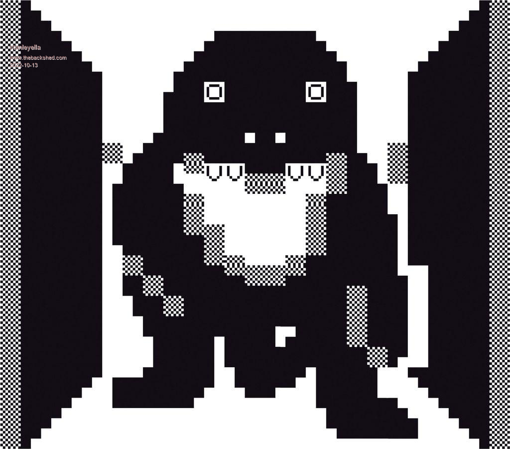

That gives me the idea to write a "ASCII ART Version" for VT 100 Terminal.
Somehow ZX81 like but with Colors
Excited / inspired - but I dont need another side project battling with the day job ;-)
N
Posts: 2807
Posted: 01:48pm 13 Oct 2022
Posts: 2807
Posted: 02:43pm 13 Oct 2022
@ Martin H. char set for graphics? nostalgia?

3D Monster Mace   ... The problem is, that on VT100, you have not charset with those "Quarterpixels" like the ZX 81 had

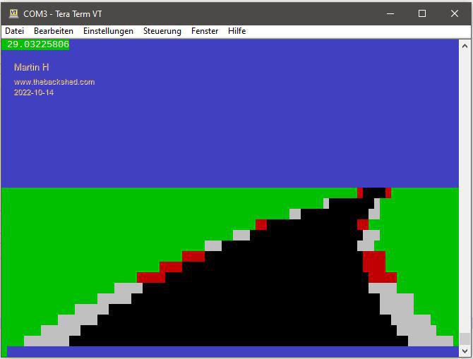

Martin H.
Joined: 04/06/2022
Posts: 1573
Posted: 03:33am 14 Oct 2022
More Like this:
For PicoMite nonVGA
in Terminal..
(runs on a bare Raspberry Pico with MMBasic in VT100 Terminal)
CPUSPEED (KHz) 252000 (13.8 FPS @ 127000 KHz)
(will also run on PicomiteVGA in Terminal but much slower when the Line "Option Display SH%/8,SW%/4" is deleted and Prints garbage on the VGA Screen because it cannot process the VT100 escape sequences)
realy Nightly Build, as i woke Up at 3 AM
quick and dirty translated to VT100, sure there is room for improvements and optimizations
'VT_Road
Cur_off

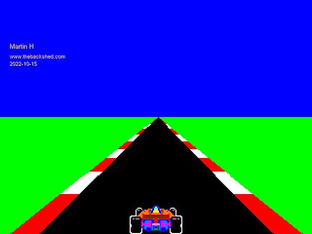

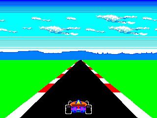

Martin H.
Joined: 04/06/2022
Posts: 1573
Posted: 07:37am 14 Oct 2022
back to the original listing.
The empty road is a little boring.
For this reason I've done some Pixelwork and designed a car which can be integrated into the original listing.
Data uncompressed for better readability
MODE 2

Posts: 2807
Posted: 02:47pm 14 Oct 2022
Sprite read needs to be blit read for non vga mmb. I will try but it is a big sprite.
Martin H.
Joined: 04/06/2022
Posts: 1573
Posted: 03:14pm 14 Oct 2022
  stanleyella said  Sprite read needs to be blit read for non vga mmb. I will try but it is a big sprite.
actually this are 2 Sprites in one... The right Side is a little different from the left Side.
Since the car is symmetrical, I only read half of the car with each sprite and then draw them once mirrored and once normal
I was too lazy to draw the sprite 2 times
Both Programs in combination it looks like this
Edited 2022-10-15 06:41 by Martin H.

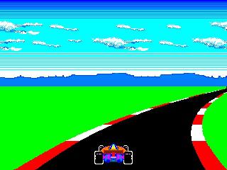

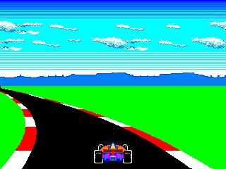

Martin H.
Joined: 04/06/2022
Posts: 1573
Posted: 04:34pm 21 Oct 2022
next evolution
added the Car and painted a Background
CPUSPEED 378000
Dim Col%(15),Xofs%(2,160)

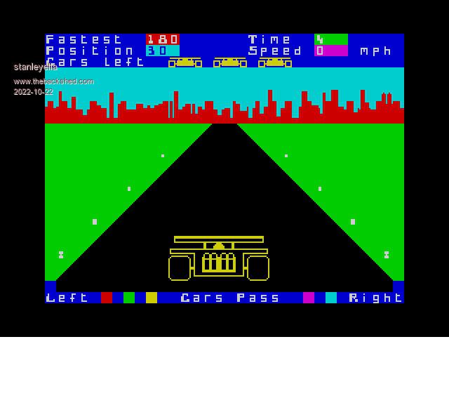

Posts: 2807
Posted: 05:20pm 21 Oct 2022
I like the way you are going with this.
I knew some guys in the 80's doing it for zxspectrum.
Posts: 2807
Posted: 05:50pm 21 Oct 2022
Not easy to convert to lcd mmb but am trying.

What fun!
Here's a modification to include a track.
At the very end is a data block that encodes the track. You can change it for any course you might like.
I'm not sure if I have the sky movement correct. I don't have an SD card connected, so I can't load the sky graphic to test.
autosave

Posts: 6626
Posted: 09:06pm 22 Oct 2022
  stanleyella said  I get errors like
RUN
[100] Blit write #2,132,200,1
Error : Syntax
when usibg blit instead of sprite.
The available commands are:
BLIT READ #b, x, y, w, h
BLIT WRITE #b, x, y, w, h
BLIT LOAD #b, f$, x, y, w, h
BLIT CLOSE #b
In the VGA firmware, you can flip the sprites. This is not available in the TFT version so you will have to create the flipped side of the car as an additional sprite.
Posts: 2807
Posted: 12:16am 23 Oct 2022
RUN
Error : Syntax
BLIT CLOSE #b

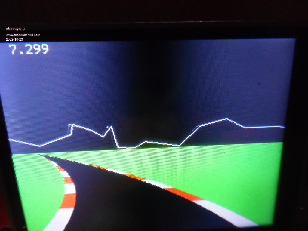

A lot more to do to convert to non vga but the road works and I can redo the car as any sprite.. sorry blit.
Nice road code. Lots of maths to learn. I am impressed.
My version of scrolling was slow using blit but that was lcd.
Using blit read blit write was faster than using blit x1,y1,x2,2,w,h

Hi Stanley
RUN
Error : Syntax
BLIT CLOSE #b
ok, if the Version cannot Flip the Sprite/Blit you can modify the Read procedure and Flip them while creating:
Sub read_Sprites
Local nr%,p%,n%,byt$,m$
'--- Read/Create Sprites
Restore car
 For p%=1 To 31
  Read Byt$:Byt$=expand$(Byt$)
  For n%=1 To Len(Byt$)/2
   m$=Mid$(Byt$,n%,1)
   Pixel n%-1,p%,COL%(Val("&H"+m$))
   Pixel 56-n%,p%,COL%(Val("&H"+m$))
   m$=Mid$(Byt$,Len(Byt$)-(n%-1),1)
   Pixel n%-1,32+p%,COL%(Val("&H"+m$))
   Pixel 56-n%,32+p%,COL%(Val("&H"+m$))
   Next
 Next
Sprite read #1,0,0,56,32:Sprite read #2,0,32,56,32
Pause 5000
End Sub
so you have 2 fullsize Sprites.
with little Changesin the do_car sub
Sub do_car
 If dist% Mod 2 Then
    Sprite write #1,132,200
 Else
    Sprite write #2,132,200
 EndIf
it should do the job
Mart!n
'no comment
