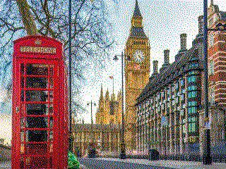

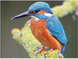

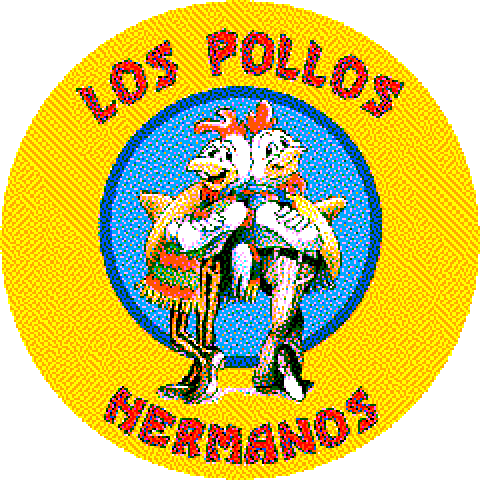

Hello,

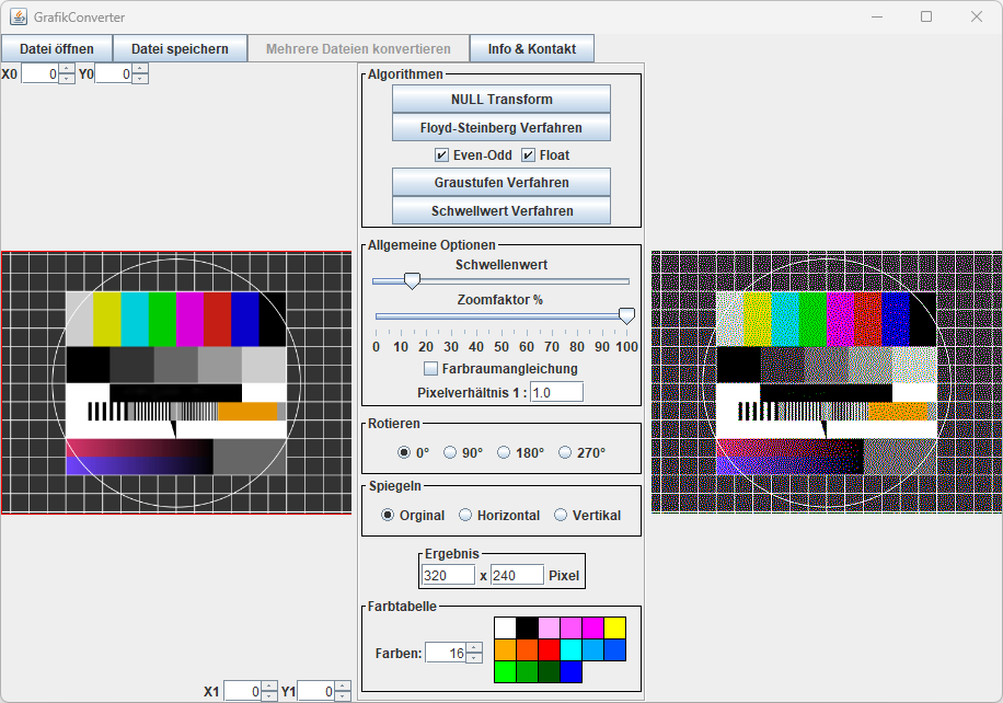

I have found the following tool: http://christoph.laeubrich.de/files/uploads/19/grafikkonverterv1_4.zip
Detail here: https://www.mikrocontroller.net/topic/92623   or also here https://github.com/laeubi/grafikkonverter-tool
Unfortunately you have to enter the 16 colors once as a palette at the beginning, this can also not be saved :-(
Maybe someone can do something with the sources ...
Results see attached.
London extracted from the input post. The bird and a test picture of me ...

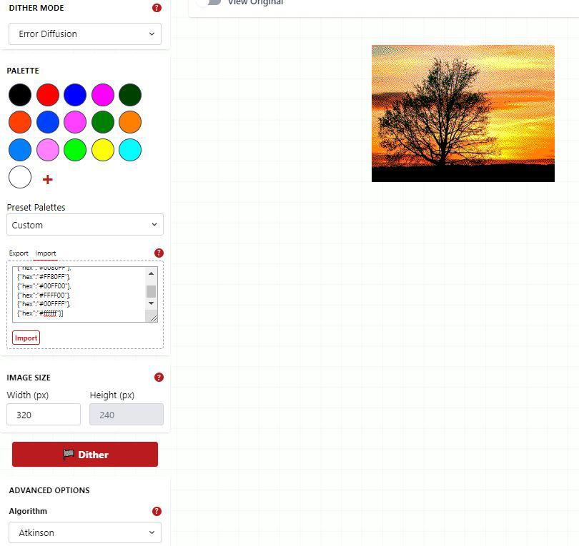

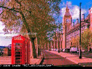

  homa said   _
I Think I've found the(by now) best solution.

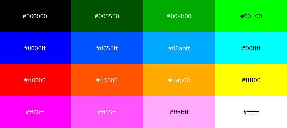

Here is an Online Ditherer, where you can save (copy and Past) a Custom Color Palette and it dithers in many different ways:
https://ditherit.com/
the Custom Palette for the Pico to past in looks like this:
[{"hex":"#000000"},
{"hex":"#FF0000"},
{"hex":"#0000FF"},
{"hex":"#FF00FF"},
{"hex":"#004000"},
{"hex":"#FF4000"},
{"hex":"#0040FF"},
{"hex":"#FF40FF"},
{"hex":"#008000"},
{"hex":"#FF8000"},
{"hex":"#0080FF"},
{"hex":"#FF80FF"},
{"hex":"#00FF00"},
{"hex":"#FFFF00"},
{"hex":"#00FFFF"},
{"hex":"#FFFFFF"}]

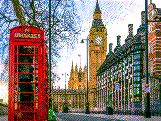

Here the london png with Atkinson dithering looks like this
Mart!n
Edited 2023-01-03 01:25 by Martin H.

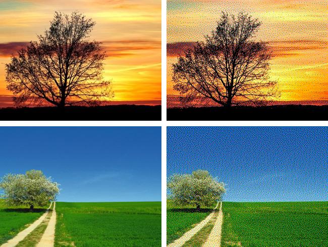

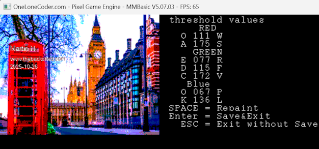

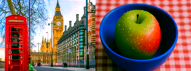

Posted: 08:46pm 13 Oct 2025

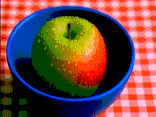

Working on the illustration for Colossal Cave Adventures has resulted in significant changes to my MMB 4 Windows tool.
The program now determines the color thresholds itself.
First, the statistical mean for each color (RGB) is calculated for 8x8 pixel blocks, then the median of this list is determined from all the values.
These values are used as the threshold values.
These values can be changed later using buttons.
becomes

sub ui
Font 2
px=w+6
do
Print@(px,0);"           threshold values"
Print@(px,20);"      RED       GREEN        Blue"
Print@(px,40);"    Q ";make$(LR);" W    E ";make$(LG);
PRINT " R      O ";make$(LB);" P"
Print@(px,60);"    A ";make$(UR);" S    D ";make$(MG);
PRINT " F      K ";make$(UB);" L"
Print@(px,80);"               C ";make$(UG);" V"
Print@(px,100);
Print@(PX,120);" SPACE = Repaint"
Print@(PX,140);" Enter = Save&Exit"
Print@(PX,160);"   ESC = Exit without Save"
do :k$=inkey$:Loop while k$=""
k$=Ucase$(k$)
select case k$
case "Q"
if LR>0 then inc LR, -1
case "W"
if LR<UR then inc LR
case "E"
if LG>0 then inc LG, -1
case "R"
if LG<MG then inc LG
case "O"
if LB>0 then inc LB, -1
case "P"
if LB<UB then inc LB
case "A"
if UR>LR then inc UR, -1
 case "S"
 if UR<255 then inc UR
  case "K"
if UB>LB then inc UB, -1
 case "L"
 if UB<255 then inc UB
   case "C"
if UG>MG then inc UG, -1
 case "V"
 if UG<255 then inc UG
     case "D"
if MG>LG then inc MG, -1
 case "F"
 if MG<UG then inc MG
 case " "
 load png FN$+".png"
  Scan
case chr$(13) ,chr$(10)
  Exit SUB
 case chr$(27)
  End
end select
loop
end sub

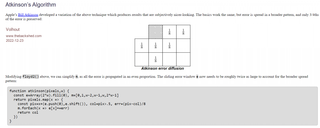

Maybe I'll give Atkinson a try after all.
 Martin

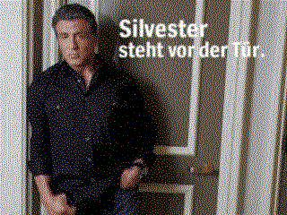

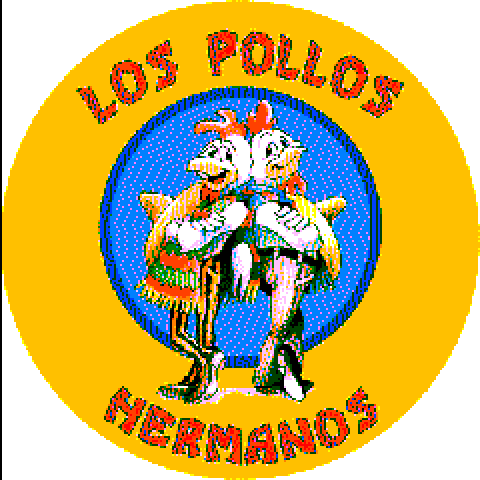

Fantastic thread, thank you all! I'm new to grafics and didn't have an idea how to get into that.
Special thanks @scruss:
  scruss said  A couple of other ways to make pre-dithered images using the venerable (okay, maybe just old) Netpbm toolkit:
1.) Ordered dither
djpeg london.jpg | ppmdither -red=2 -green=4 -blue=2 | ppmtobmp > london_ordered.bmp
Result:
Under Linux all there is to do:
apt install libjpeg-progs
djpeg bird_orig.jpg | pnmremap -floyd -mapfile=<(echo P3 16 1 3 0 0 0 0 2 0 0 2 3 3 3 3 0 3 3 3 0 3 3 0 0 3 1 0 3 2 3 3 2 0 3 1 3 0 3 0 3 3 0 0 1 3 0 0 3 0 1 0) | ppmtobmp > bird_orig_FS.bmp
to have that wonderful result and that is exactly how it look on my unmodified VGA:
load image "b:bird_orig_fs.bmp" :  save image "pico_org.bmp"
Thanks a lot!!

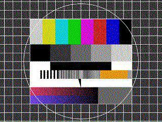

Posts: 12059
Posted: 11:11am 14 Oct 2025
Please don't take this the wrong way....
Here is an image on PICOMITE VGA RP2350 Mode 3 so 640x480 RGB121 standard palette
using the new command
timer=0:load dithered "b:/tiger640":?timer
As you can see it took 1.3 seconds to load and draw.
Here is the genesis of the command using CLAUDE

Atkinson Dithering
During the mid-1980’s, dithering became increasingly popular as computer hardware advanced to support more powerful video drivers and displays. One of the best dithering algorithms from this era was developed by Bill Atkinson, a Apple employee who worked on everything from MacPaint (which he wrote from scratch for the original Macintosh) to HyperCard and QuickDraw.
Atkinson’s formula is a bit different from others, because it only propagates a fraction of the error instead of the full amount. This technique is sometimes offered by modern graphics applications as a “reduced color bleed” option. By only propagating part of the error, speckling is reduced, but contiguous dark or bright sections of an image may become washed out.
https://tannerhelland.com/2012/12/28/dithering-eleven-algorithms-source-code.html
FN$="testapple"
' Atkinson Dithering v 0.94 - Korrigierte Randbehandlung
' Converts PNG Source Files to RGB121 BMP
' by Martin H. 2025 (with the help of the AI assistant)
Mode 1

in case anyone's interested
Further improved version, green is now also dithered in 7 steps
g≤LG    Fixed color 0    Level 1: Black
LG<g≤LG_MID    Dither between 0 and G1    Level 2: Very dark green
LG_MID<g≤MG    Fixed color G1    Level 3: Dark green
MG<g≤MG_MID Dither between G1 and G2    Level 4: Medium green-dark
MG_MID<g≤UG    Fixed color G2    Level 5: Medium green
UG<g≤UG_MID    Dither between G2 and G3    Level 6: Light green
g>UG_MID    Fixed color G3    Level 7: Full green

Hi Martin,
That last picture you posted looks "darker" than earlier dithering examples.
Any reason why ?

@Martin,
I have a problem when transfering the pictures back to the PC when saved with PicoMiteVGA (colors/brightness change, maybe similar to your above darker picture).
But I will try to put them here anyway. However you should try it yourself on 6.01.00RC7
LOAD DITHERED "london.bmp",,,2
london_bmp.zip
The result (again, try on picomite + monitor, it looks much better that this).
Atkinson gives better result on smaller screens than Floyd. On a larger screen Floyd may be better.

  Volhout said  I have a problem when transfering the pictures back to the PC when saved with PicoMiteVGA (colors/brightness change, maybe similar to your above darker picture).
The prescan sub attempts to determine the average value for red, green, and blue. First, it adds the values from 8x8 pixel squares, then sorts the determined values and uses them to determine the threshold values. In other words, it uses the median.
If the result appears too dark, too light, or the wrong color, you can use the keys to adjust the threshold values.TIf i Like to avoid dithering, I set both values directly next to each other, i.e., the upper and lower thresholds to the same value.
However, it always depends on the source material which you work on.
For photos, I would prefer Atkinson, but for other images, such as graphics, I would prefer direct conversion with possible dithering, as with the conversion of PetsciRobots tiles and sprites.
Martin
