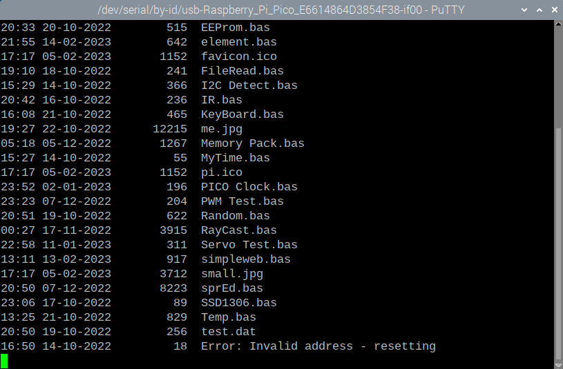

  TassyJim said  MMEdit terminal seems to talk to it OK but there is a problem with the file manager.
XMODEM works but does not conclude reliably. The file list is OK provided there are not too many files to list.
Both problems look like a timing issue that I will track down in time.
The usual "load and run" program transfer seems to be reliable.
They take 10 times longer than USB but will be much quicker than removing a device from service (up a gum tree) to update software!
Yes same here, it will list a full page worth of files and crashes with "ERROR: Invalid address - resetting" on the key press to continue listing files on the SDcard.

Posts: 11847
Posted: 08:33am 15 Feb 2023
V5.07.07a16
PicoMiteWebV5.07.07a16.zip
This fixes XMODEM. Apparently if you want to send 255 over telnet you have to send it twice. So my driver now sends it twice and when it receives it twice strips one. XMODEM is pretty slow over telnet but I just transferred 69KB successfully
Also fixes crashing if you have OPTION TELNET ON set but don't have a telnet connection - forgot to block the telnet transmit in this case - trivial one line change

Posts: 11847
Posted: 09:35am 15 Feb 2023
Fixed the crash with LIST ALL

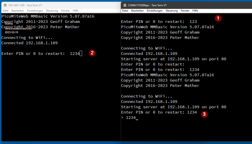

@peter, hint for a  glitch:
to protect the Telenet console I tried to set OPTION PIN 1234.
The incorrect input via USB leads to a reboot! (1)
But when reconnecting via Telnet no access with correct PIN works! Also restart! (2)
Only with access via USB and correct PIN I get back into the Picomite. (3)
Posts: 11847
Posted: 10:43pm 15 Feb 2023
It would be better to keep things simple to start with and not use things like OPTION   PIN. Bugs like that are for a MUCH later day
