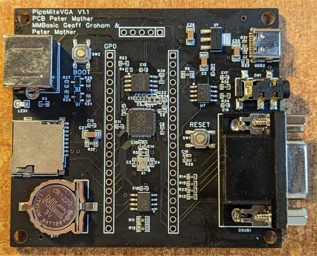

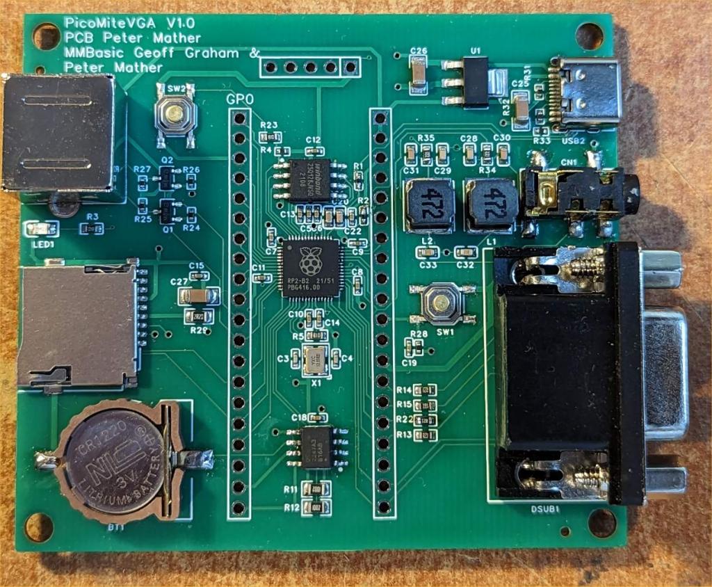

Here are the completed boards as received from JLC. Both the filter and DAC versions work perfectly for all functions with no errors.

Er... why is one V1.0 & the other V1.1?
I'm guessing the files would be for V1.1 - right?
Posts: 11842
Posted: 06:52pm 26 Apr 2023
  Quote  why is one V1.0 & the other V1.1?
V1.0 has Volhout's inductor filter
V1.1 uses the MCP4822 DAC
I will make both sets available - not much cost difference. The DAC has better high frequency response but uses a bit more system resouerce

I'm trying to order the V1.1.
After uploading the gerbers, then BOM & CPL, on processing BOM & CPL I get some errors (in red):
1 parts inventory shortfall, which I guess means they don't have them LOL
looks ike it means the J1,J2; shows 8 shortfall (of 10)
3 parts not selected
which are:
BT1
USB2
H1
Am I doing this right / what do I do next?
Posts: 11842
Posted: 05:43pm 27 Apr 2023
J1 and j2 are the 20 pin headers and you don't want these from them - too expensive as hand soldered.
You also don't want H1 which is the 5-pin header
The rest should be there. let me check the BOM and see what has happened
Posts: 11842
Posted: 06:02pm 27 Apr 2023
UPDATE
Seems like a glitch on their system as it is doing the same to the file I had the prototype built from.
Recommendations
edit the BOM and CPL files. Remove the lines for J1, J2, and H1
Then load up as before
In the JLC screen for the two "missing" components hit the search icon on the component line.
The battery holder comes up with the correct part so select it
The USB connector cones up with a selection of parts select the top one:
KH-TYPE-C-16P
The proceed to the board viewer - it all looks OK to me.

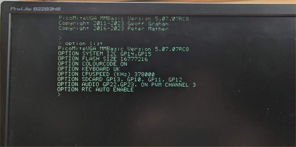

One note for configuring the boards.
The underside has silkscreen details for setting up the required options. However, both the boards use GP23 for audio and V1.1 also uses GP24. In order to configure this they need setting to OFF before executing the option command.
i.e.
for V1.0
SETPIN GP23,OFF:OPTION AUDIO GP22, GP23
for V1.1
SETPIN GP23,OFF: SETPIN GP24,OFF: OPTION AUDIO SPI GP24, GP22, GP23
Posts: 6103
Posted: 08:10am 01 May 2023
@Peter,
Do these boards run CPUSPEED 378000 ?
Posts: 11842
Posted: 08:28am 01 May 2023
  Quote  Do these boards run CPUSPEED 378000 ?
Mine do but no guarantees any more than any other RP2040 variant
Edited 2023-05-01 18:30 by matherp
