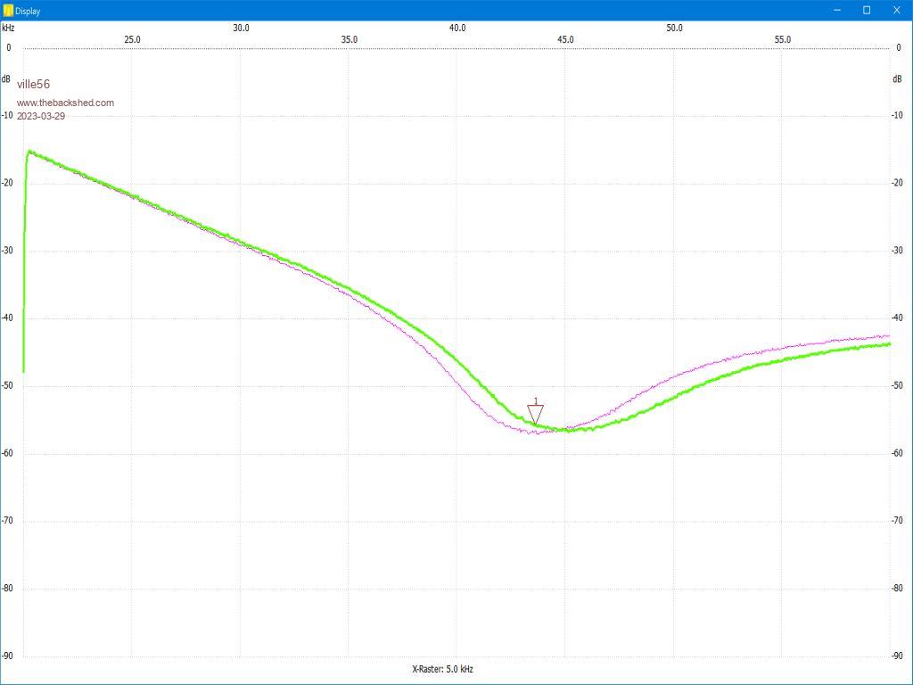

just soldered together what was at hand. Changed L to about 4 uH and the C parallel to it to 3,3 nF Styroflex. Closely hit 44 kHz resonant frequency. Output load is 47 kOhm. Input impedance is 50 Ohms into the 220 Ohm resistor. 33nF and 68nF as per circuit diagram.
In the attached graph you can see the transfer function of the filter. The lines differ by 200pf in the resonant circuit which represents a tolerance of +6% (cap in/cap out).
line color           red        green
frequency [kHz]      43,6       45,0
insertion loss [dB]  56,1       55,6
To me this means a difference in insertion loss of 0,5 dB at the frequency in question. Interpolated linearly this would mean about 1,5 dB for +20% tolerance. So the worst case (+/- 20% for L and C) could be 3 dB which in voltages means a factor of 1,4.
If we assume 3,3V carrier amplitude then after -56dB we have about 6mV left. The worst case difference then would be 6mV to 8,4mV.
I think this is not too bad for this simple filter and the as the notch is not very pronouned, component tolerances will not effect the characteristics much.

IMHO notch depth is not effected by tuning, at least not in this type of filter. It is given by component characteristics (values, Q, tan(delta)) of the LC resonant circuit and the damping on input and output.
I think you only can tune the notch to better match the carrier frequency, but the results are rather marginally as can be seen from my last post.

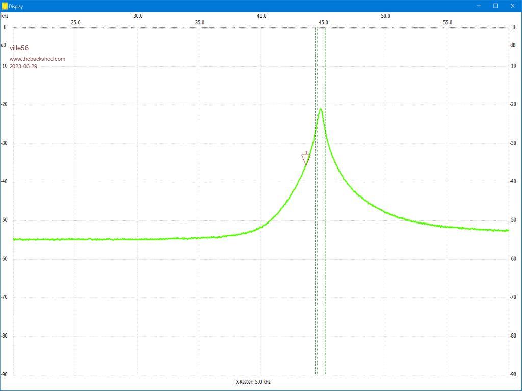

just out of curiosity i measured the Q of the LC circuit i was using. It is a mere Q of 86. I think this is rather mediocre for 44 kHz. Generator coupled with 22pF, Load is about 1 Mohm//30pF. Should not dampen too much.
So the ferrite core inductors seem to be not the best choice for that. Pot cores may be a different story with the right ferrite mixture.
73 de OE1HGA, Gerald
