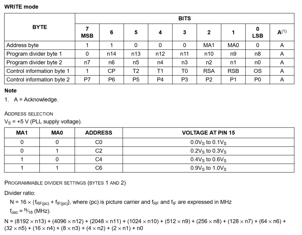

It's a modified Philips FI121 tuner so the output instead of an audio signal is a voltage
What I am not understanding and this is using the tuners datasheet is how to convert the Program divider byte 1 and Program divider byte 2 into Hex
I REALLY am not getting this
PROGRAMMABLE DIVIDER SETTINGS ( BYTES 1 AND 2)
Divider ratio:
N = 16 × {f RF(pc) + fIF(pc) }, where (pc) is picture carrier and fRF and fIF are expressed in MHz
fosc = N⁄16 (MHz).
N = (8192 × n13) + (4096 × n12) + (2048 × n11) + (1024 × n10) + (512 × n9) + (256 × n8) + (128 × n7) + (64 × n6) +
(32 × n5) + (16 × n4) + (8 × n3) + (4 × n2) + (2 × n1) + n0
The frequency I want is 383Mhz
The IF frequency for that frequency is 33.40Mhz
Can anyone explain how I get the N numbers for the program divider and convert it to a Hex number for both Program divider byte 1 and Program divider byte 2

Hi Lew,
Remember you asked me before to propose tuner settings for a TV tuner for 383MHz. Try those settings. Philips tuners typically have the same I2C register map.
If you want more detailed help, please provide schematics of the circuit, and a datasheet for the tuner. That would help. It is possible the AD8307 output is coupled back to the tuner AGC pin to extend the dynamic range of the circuit.
P.S. if you need me to write the code for the full project, provide me with a tuner for loan. I can get access to a signal generator and make sure it will work.
P.P.S. there is benefit in using the audio output. It has 200kHz bandwdth, versus 5-6MHz for the video output. That lowers the noise floor, thus the measurement range.
P.P.P.S. the PLL's crystal is typically 4MHz, so the values n0...n13 are multiples of 4MHz/16 = 250kHz, which I find strange. But it could with n0..n13 (14 bits = 2^14 = 16000. This could tuner to 4GHz. That is why I expect the step frequency on the PLL is 1MHz/16 = 62.5kHz. That would tune to 1000MHz. Better for a analog TV tuner.
So each step is 62.5kHz. With 383MHz tuner and 33.4MHz IF you need to tuner the PLL to 416.4MHz, that is a divider set up for 416.4/0.0625 = 6662
This is binary 1 1010 0000 0110. n0=0, n1=1, n2=1, n3=0, n4=0, n5=0, n6=0, n7=0, n8=0, n9=1, n10=0, n11=1, n12=1, n13=0

You add the IF frequency to the desired frequency and divide it by the step size to give you a decimal number?
You then convert that to Binary and then you read the binary from RIGHT to LEFT
or do you read it left to right wnen filling this out
Program divider byte 1 n14=1 ,n13=0 ,n12=0 ,n11=0 ,n10=0 ,n9=0 ,n8=1
Program divider byte 2 n7=1 ,n6=1 ,n5=1 ,n4=1 ,n3=0 ,n2=1 ,n1=1 ,n0=0

As I read the datasheet, n0 is the least significant bit, n13 the mist significant.
If you want to use the full 6MHz bandwidth, then you should know that TV signals where AM modulated, single sideband.
the lowest frequency is the video carrier (15.625kHz), and higher the color carrier (4.43MHz), then at 5MHz, the video band stops, and at 5.5MHz the sound carrier is.
So the tuner has a IF that goes from (see datasheet) 38.9MHz down to 33.4MHz (38.9-33.4 = 5.5MHz = audio carrier).
The centre of this IF band is 38.9 - 2.75 = 36.15MHz (2.75 = 5.5 / 2)
In case 383MHz is your desired centre frequency, then you should tune the tuner to 383 + 36.15 = 419.15MHz. Now your tuner will cover the band from roughly 380 to 386 MHz. It will have a shallow slope at 380MHz, and a sharp slope at 386MHz.

So using your logic my N number for the tuner is 348.25Mhz*16 =
6148
Converted to Binary this is 1100000000100
How do I do this from that binary number?
Program divider byte 1 n14= ,n13= ,n12= ,n11= ,n10= ,n9= ,n8=
Program divider byte 2 n7= ,n6= ,n5= ,n4= ,n3= ,n2= ,n1= ,n0=
is n0 the number on the left of the binary number or the right of the binary number?

382.5 + 36.15 = 418.15 MHz (you must add the frequencies, not subtracts.
Binary numbers have MSB left, LSB right. n0 is the rightmost bit.
Other registers:
CP = 0 (your tuner is fexed, does not change channel
T2=T1=0, T0 = 1
OS = 0
RSA = RSB = 1 (62.5kHz PLL)
Use mid band:
P4=1
P5=0
P6=0
P7=1
P3=P2=P1=P0=0

  Volhout said  382.5 + 36.15 = 418.15 MHz (you must add the frequencies, not subtracts.
Does this look correct (I know 6148 is the wrong number but this is just an examplse so I can try and understand)
6148 Converted to Binary this is 01100000000100
Program divider byte 1 n14=0 ,n13=0 ,n12=1 ,n11=1 ,n10=0 ,n9=0 ,n8=0
Program divider byte 2 n7=0 ,n6=0 ,n5=0 ,n4=0 ,n3=0 ,n2=1 ,n1=0 ,n0=0
Or is it
Program divider byte 1 n14=0 ,n13=0 ,n12=0 ,n11=0 ,n10=0 ,n9=0 ,n8=0
Program divider byte 2 n7=0 ,n6=0 ,n5=0 ,n4=0 ,n3=0 ,n2=1 ,n1=1 ,n0=0

Looking at your extract from the data sheet I don't think you need the individual bits. Just cut the divider number into 2 bytes.
First byte = 6148>>8
Second byte = 6148 And 255
I think that will have the bits in the right order.
> ? bin$(6148>>8,8)
00011000
> ? bin$(6148 And 255,8)
00000100
