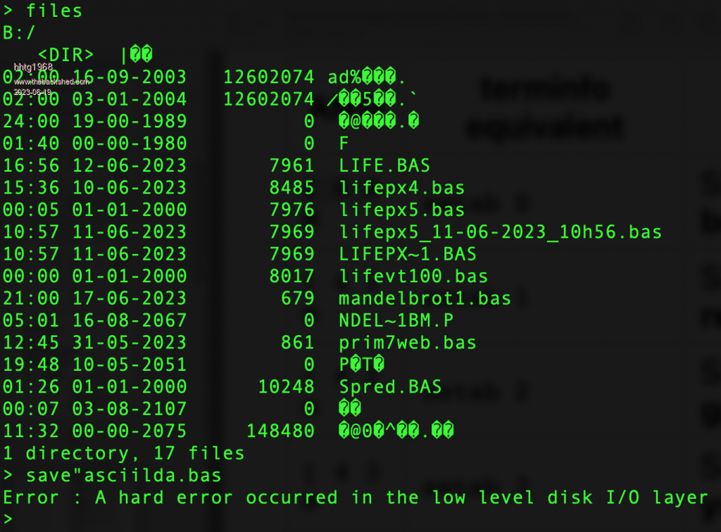

hello again.
meanwhile the sd card reader runs.
but not always. from time to time occur errors like "sd card not found" etc. if i restart the picomite or eject an enter the sd card it mostly functions.
sometimes occurs a "hard error" and it is more complicated to save data (via pc or mac)
here is an image...
hhtg1968
Joined: 25/05/2023
Posts: 206
Posted: 06:51am 19 Jun 2023
... and there are strange symbols in the directory, and strange files and filesizes...
hhtg1968
Joined: 25/05/2023
Posts: 206
Posted: 06:52am 19 Jun 2023
on my mac you cannot see this strange data!
IanRogers
Joined: 09/12/2022
Posts: 152
Posted: 07:10am 19 Jun 2023
That's exactly what mine was doing.
I just bridged out the inline resistors.  Check if your SD slot has any inline resistors.  Any bought from the web normally have 1k (102) but mine had 10k (103) and was far too large for the application.
Posts: 8973
Posted: 07:11am 19 Jun 2023
Have you got the 3V3 power supply to the card reader filtered? They can be very fussy sometimes. Use 2R2 resistor then 10uF and 100nF capacitors in parallel to GND.
If the power is good then I only have two suggestions: bad contacts on the breadboard or a bad/incompatible SD card.

Posts: 5998
Posted: 07:43am 19 Jun 2023
Put the capacitors (10uF+100nF) right at the SD card contact pins.
Sometimes people wire SD card header to a breadboard through patch wires.
You should keep the capacitors as close as possible to the connector, and the patch wires < 10cm.
And in case this is a "shared" SPI bus with LCD and Touch, minimize the total length of SPI wires. The "shared" SPI bus (used in the normal PicoMite) is not as forgiving as individual connected SD cards (like in PicomiteVGA).

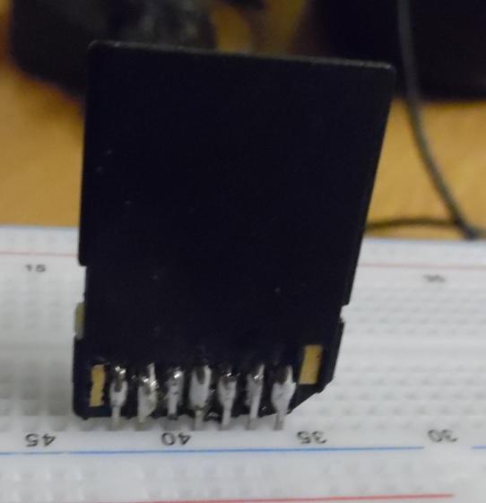

hhtg1968
Joined: 25/05/2023
Posts: 206
Posted: 12:28pm 19 Jun 2023
the reader is shown in this topic above. here a smaller image...
it is connected via breadboard with long cables - 20-30cm -...
i have the problems at all picos, picomiteVGA and "normal" picomite (here is only the sd-card reader connected (the picomiteVGA has VGA, SD card reader, ps/2- keyboard, rtc etc...
the problems occur more often at the picomiteVGA...
i have tested the connections several times, mostly all is running but not always.
Posts: 8973
Posted: 12:51pm 19 Jun 2023
I've just compared it to the ones I've been using, and which I've proved to work, and it's not the same. Both *seem* to have 4x 10K pullup resistors (but mine are separate, not in a pack) and supply decoupling capacitor (but mine only has one rather than two).  It might be an idea to check that those resistors actually are pullups and aren't in series with the data lines. If they are in series then you are lucky that the adapter is working as well as it does now!
Long cables are no use at SPI speeds. No more than about 10cm absolute maximum from the pico to the card holder IMHO. You may get away with it for a LCD display, but just a single bit error on a SD card gives corrupt data.
If you're having problems with more than one PicoMite then I'm starting to wonder about your power supply, although if it's USB from a PC it *should* be ok. Have you got a powered hub that you could use to feed it? Or you could feed a separate 5V into VSYS via a diode to isolate it from the USB power. That would make sure that that problems with the  USB power supply wouldn't cause a problem. Note that some USB leads are truly horrible when it comes to volt drop!
Edited 2023-06-19 23:02 by Mixtel90

hhtg1968
Joined: 25/05/2023
Posts: 206
Posted: 03:59pm 19 Jun 2023
first i change the power supply. from a 5w to 10w adapter (picomiteVGA with many features...)
after intense testing... no errors or mistakes until now!
i will continue to tell about my experiences...

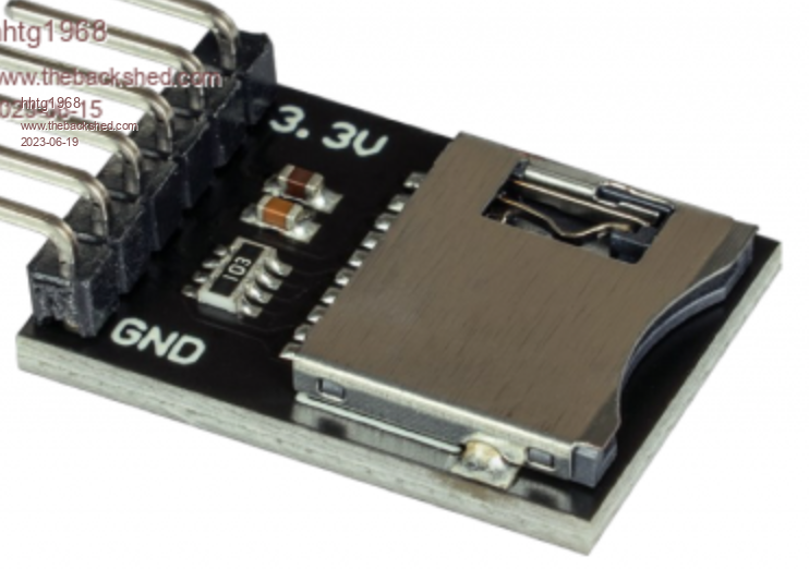

palcal
Joined: 12/10/2011
Posts: 2039
Posted: 07:37am 20 Jun 2023
Like  THIS
Posts: 9996
Posted: 07:49am 20 Jun 2023
TOTALLY 100% agree.  That board is ideal.
Although, the price is a bit high for what it is, but it IS directly connected, which is what we need.
Perhaps we should design a PM, PM VGA or PM WEB SD/uSD board that does the job and is then the recommended thing.
The number of times that 3rd party SD/uSD boards from eBay or AliExpress etc have shown up here and users complain that they don't work, would suggest that perhaps we here develop and release a free-CAD design for a carrier board that DOES work.
Thoughts?
