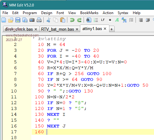

Coming not quite as soon,
MMEdit for ATTiny
Automatic line numbering.
One button, instantly switch from 'normal' readable code to the crunched version required to fit the tiny, and back again.
It will be a couple of weeks before I have the ATTiny85 to test with but I should have it released well before then. Weather and life matters permitting.

  TassyJim said  Coming not quite as soon,
MMEdit for ATTiny
Looks great Jim,
I'm sure you caught the note about the "speed limit" when sending code to the ATTiny85 due to the echo of each character blocking the next incoming character.
Also a byte count would be very helpful, especially in "crunched" mode.
I'd offer to send you an ATTiny85 chip, but I see you are in Australia and I have found the postal service to be extremely slow to that part of the world.
Please let me know IF I can be of any help with testing etc.

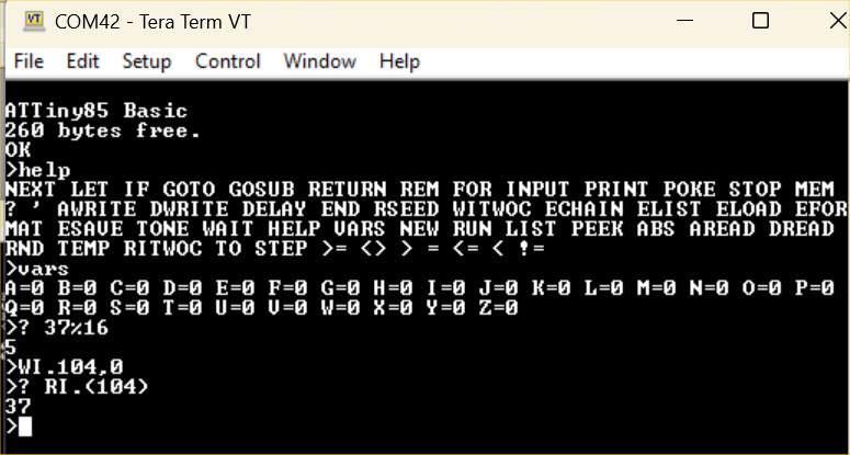

Here is the latest (final?) version of the firmware. Simplified the source and sone performance improvement.
ATTiny85.zip
New commands
VARS 'list the values of all variables (code from Volhout)
HELP 'list all valid commands, functions, and operators (code from Volhout)
WITWOC addr, data
e.g. WI.104,0 'write to DS1321 RTC to point to the seconds register
New Function
RITWOC(addr)
e.g A=RI.(104) 'read the register on the DS3231 previously set up
New Operator
e.g.
B=A%16 'B = A MOD 16
Source
ATTiny85.zip

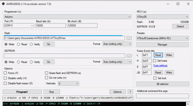

For those that don't like using the command line, I have successfully used this GUI front end for AVRDUDE. It sets all the fuses so just read them in before you set/change the ones you want to actually change.
I did a portable install into a directory and placed the ATTiny85.hex in there as well.
AVRDUDE GUI interface

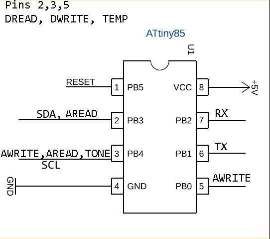

Is this right?

I think that's right, CG. For now anyway. By next week?
