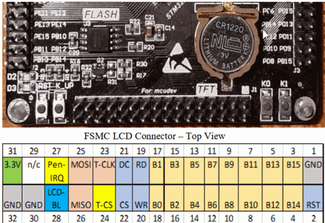

I think the LCD Panel looks corrected. The pins you have on the processor side don't look correct. Further up in this thread there is a link to the manual. Get the latest it has a view of the 34 pin FSMC connector in the Display Panels section.
Looks like this.

Thanks again. you're right.
I checked and what I ordered as per recommended showed OLD-TFT and
looks like your pin-out....but what I actually got showed New-TFT with different pinout.
I think some cable cross-overing will fix it, but it is a nuisance.
Out of interest (in case this is a trend) I ordered mine 8th Aug and received today...maybe it was just me.

Just to confirm what flip noticed with the OLD-TFT and the New-TFT I had a similar experience posted in https://www.thebackshed.com/forum/ViewTopic.php?FID=16&TID=16131.
It's a challenge to order unless you get a matched pair.

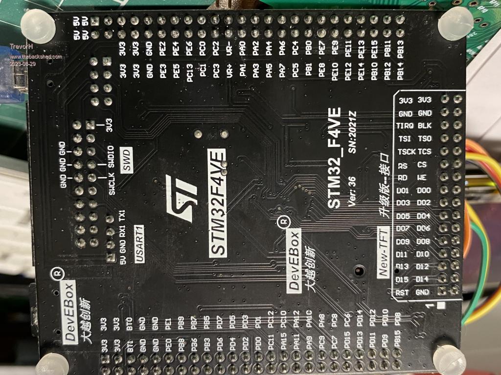

Just to confirm flip's findings, my processor is a Version36 and has the display pinout differences shown. will try to upload a picture (not used this facility yet)

Mina says OLD TFT (not just TFT) on top and bottom of the board and the pin layout is the same as the above manual diagram. The version is V33.
