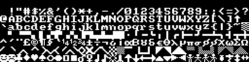

PET Style Fontset
' font_ PET Style Martin Herhaus
' Font type    : Full (160 Characters)
' Font size    : 8x8 pixels
' Memory usage : 1280

Hi Martin...
Nice... You have mapped the characters on the ASCII related numbers, not the PET screen codes. (in the PET the @ABCD... are mapped to codes 0...32) But that is not important since 6502 code won't run on MMBasic anyway, so using these characters is a new MMBasic program anyway.
As far as I can see you implemented the lower case character set, and added 32 missing graphics characters from the graphics/full set at the end.
If you want to use this for "PETCII ROBOTS" you also need the inverted graphics characters, and some inverted text characters.... David used almost every character in the set on his PET version (fixed upper/graphics characterset).

on the PET, you don't have the option to choose the foreground and background color,
as is possible on the *Mites.
So If we need a inverted graphics character, we can simply swap fore- and background.
You can occupy the remaining 64 chrs (higher than 191) with a selection of the required inverted characters. This would have the advantage that you could store it in a string and output it without interrupting the output.
Like they ve done with the  Apple II Font Port of PETSCII ROBOTS
Another option would be to store the entire character set inverted again as another font.
AFAIK, David uses a special Character Rom for PETSCII ROBOTS

Martin H.
Joined: 04/06/2022
Posts: 1572
Posted: 07:09am 23 Sep 2023
  Volhout said  Hi Martin...
I was thinking about how to Display a 256 character font on the Pico, because it can only display characters starting from 32. The good old GUI BITMAP seems to be a clever solution.
dim gfxfont$(255) length 8
open "gfxfont.bin" for Input as #1
for f=0 to 255:gfxfont$(f)=input$(8,#1):next
SW%=256 'Screen
close #1
cls:ox=0
'test output
for f=0 to 255 step 32
 for n=f to f+31:tn$=tn$+chr$(n):next:GText 0,ox,tn$:tn$=""
 inc ox,8
next
print @(0,128),
'output of this font
sub GText tx%,ty%,text$
local integer c,tl
for c=1 to len(Text$): tl=asc(mid$(text$,c,1))
GUI BITMAP tx%,ty%,gfxfont$(tl),8,8,1,rgb(white)
inc tx%,8:if tx%>=SW% then TX%=0:Inc TY%,8
next
end sub
Font Rom File:
gfxfont.zip
Edited 2023-09-23 21:41 by Martin H.

Posted: 07:28am 05 Aug 2025
This font is a convertion of the original Amstrad CPC character set, perfect for giving a projects a retro, 8-bit feel
' cpc
' Font type    : Full (224 Characters)
' Memory usage : 1792
DefineFont #9
E0200808
00000000 00000000 18181818 00180018 006C6C6C 00000000 6CFE6C6C 006C6CFE
3C583E18 00187C1A 18CCC600 00C66630 76386C38 0076CCDC 00301818 00000000
3030180C 000C1830 0C0C1830 0030180C FF3C6600 0000663C 7E181800 00001818
00000000 30181800 7E000000 00000000 00000000 00181800 30180C06 0080C060
D6CEC67C 007CC6E6 18183818 007E1818 3C06663C 007E6660 1C06463C 003C6606
98583818 003C18FE 3C60627E 003C6606 7C60663C 003C6666 0C06467E 00181818
3C66663C 003C6666 3E66663C 003C6606 18180000 00181800 18180000 30181800
6030180C 000C1830 007E0000 00007E00 0C183060 00603018 0C06663C 00180018
DEDEC67C 007CC0DE 66663C18 0066667E 7C6666FC 00FC6666 C0C0663C 003C66C0
66666CF8 00F86C66 786862FE 00FE6268 786862FE 00F06068 C0C0663C 007EC6CE
7E666666 00666666 1818187E 007E1818 0C0C0C1E 0078CCCC 786C66E6 00E6666C
606060F0 00FE6662 FEFEEEC6 00C6C6D6 DEF6E6C6 00C6C6CE C6C66C38 00386CC6
786666FC 00F06060 C6C66C38 0076CCDA 7C6666FC 00E2666C 3C60663C 003C6606
18185A7E 003C1818 66666666 003C6666 66666666 00183C66 D6C6C6C6 00C6EEFE
38386CC6 00C6C66C 3C666666 003C1818 188CC6FE 00FE6632 3030303C 003C3030
183060C0 0002060C 0C0C0C3C 003C0C0C 187E3C18 00181818 00000000 FF000000
0C183000 00000000 0C780000 00768C7C 667CE0E0 00BC6666 663C0000 003C6660
CC7C0C1C 0076CCCC 663C0000 003C607E 7830361C 00783030 663E0000 7C063E66
766C60E0 00E66666 18380018 003C1818 060E0002 3C666606 6C6660E0 00E66C78
18181838 003C1818 FE6C0000 00C6D6D6 66D80000 00666666 663C0000 003C6666
66DC0000 F0607C66 CC760000 1E0C7CCC 6CD80000 00F06060 603C0000 007C063C
307C3030 001C3630 66660000 003E6666 66660000 00183C66 D6C60000 006CFED6
6CC60000 00C66C38 66660000 7C063E66 184C7E00 00007E30 7018180E 000E1818
18181818 00181818 0E181870 00701818 0000D876 00000000 33CC33CC 33CC33CC
00000000 00000000 F0F0F0F0 00000000 0F0F0F0F 00000000 FFFFFFFF 00000000
00000000 F0F0F0F0 F0F0F0F0 F0F0F0F0 0F0F0F0F F0F0F0F0 FFFFFFFF F0F0F0F0
00000000 0F0F0F0F F0F0F0F0 0F0F0F0F 0F0F0F0F 0F0F0F0F FFFFFFFF 0F0F0F0F
00000000 FFFFFFFF F0F0F0F0 FFFFFFFF 0F0F0F0F FFFFFFFF FFFFFFFF FFFFFFFF
18000000 00000018 18181818 00000018 3F000000 0000003F 1F181818 0000000F
18000000 18181818 18181818 18181818 0F000000 1818181F 1F181818 1818181F
FC000000 000000FC F8181818 000000F0 FF000000 000000FF FF181818 000000FF
F0000000 181818F8 F8181818 181818F8 FF000000 181818FF FF181818 181818FF
C66C3810 00000000 0030180C 00000000 00006666 00000000 F860663C 00FE6660
A2BA4438 003844BA 7474F47E 00343434 6C38301E 00F03038 000C1818 00000000
4C44C040 00041E54 524CC040 001E0844 166210E0 00020FEA 7E181800 007E1818
7E001818 00181800 7E000000 00000606 30180018 003C6666 18180018 00181818
DE730000 0073DECC FCC6C678 00F8C6C6 3C666600 003C6666 3C60603C 003C6666
301E0000 001E307C FEC66C38 00386CC6 3060C000 00C66C38 66660000 60607C66
FE000000 006C6C6C 7E000000 0070D8D8 663C0603 C0603C66 660C0603 C0603C66
183CE600 00C66C38 C3660000 007EDBDB 183066FE 00FE6630 C6C67C00 00EE6CC6
C0603018 00000080 03060C18 00000001 01000000 180C0603 80000000 183060C0
C3663C18 00000000 03060C18 180C0603 81000000 183C66C3 C0603018 183060C0
C1603018 180C0683 83060C18 183060C1 C3663C18 183C66C3 3C7EE7C3 C3E77E3C
180C0703 C0C06030 3060C0C0 03070C18 3333CCCC 3333CCCC 55AA55AA 55AA55AA
0000FFFF 00000000 03030303 03030303 00000000 FFFF0000 C0C0C0C0 C0C0C0C0
F8FCFEFF 80C0E0F0 1F3F7FFF 0103070F 0F070301 FF7F3F1F F0E0C080 FFFEFCF8
55AA55AA 00000000 050A050A 050A050A 00000000 55AA55AA 50A050A0 50A050A0
A854AA55 8040A050 152A55AA 0102050A 0A050201 AA552A15 A0408000 AA54A850
FF99FF7C 7EFFC3BD FF99FF7E 7EFFBDC3 FE38387C 3810FEFE FE7C3810 0010387C
FEFEFE6C 0010387C FE7C3810 003810FE C3663C00 003C66C3 FF7E3C00 003C7EFF
66667E00 007E6666 7E7E7E00 007E7E7E 780D070F 78CCCCCC 6666663C 187E183C
0C0C0C0C 387C3C0C 1B1E1C18 78F87818 C3245A99 995A24C3 38383810 D67C3838
FF7E3C18 18181818 18181818 183C7EFF FF602000 002060FF FF0E0C08 080C0EFF
3C180000 00FFFF7E FFFF0000 00183C7E FEF8E080 0080E0F8 FE3E0E02 00020E3E
7C923838 28282810 FE103838 82442810 7C123838 22242890 7C903838 88482812
3C183C00 00183C3C 18FFFF18 1830180C 187E3C18 183C7E18 FF662400 00002466
End DefineFont
Have Fun
  Martin
