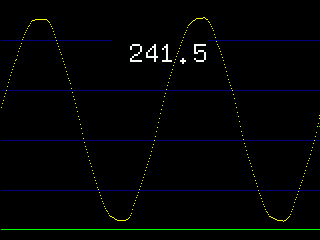

This is a demo of getting power from captured volts and amps.
yellow = volts
cyan = amps
green = power.
It was tested on an armiteF4 but should run on a picomite with any resolution display.

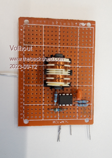

Posts: 5998
Posted: 08:15am 12 Sep 2023
  Volhout said  Simulation shows that something like this should work to measure mains voltage. I will try to prototype (build actual circuit) tomorrow.
It actually works....
Using a small common mode choke to measure 230Vac. The 2x 47kohm resistors are not on this board, but connected in the power plug.
Edited 2023-09-12 18:16 by Volhout

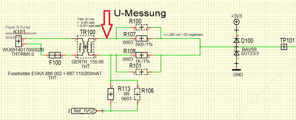

Posts: 3324
Posted: 08:49am 12 Sep 2023
Frank, the waveform you showed on the previous page seems to show significant capacitive coupling between the two windings. The output of Jim's transformer shows the 'flat top' distortion you should see, not the peaks in yours.
If you must use that transformer it's possible to reduce the effect of the coupling.
1) Swap active and neutral and check the waveform again. Getting the active end of the primary away from the secondary should help.
2) Put a large capacitor from the voltage reference end of the secondary to ground and a smaller one from the other end to ground. These may swamp the primary / secondary capacitance. If this causes a phase shift subtract it in software. Trial and error will determine the values of the caps.
3) Swap the secondary connections. It might give a small improvement if it gets the measurement end of the secondary further away from the primary.
Frank N. Furter
Joined: 28/05/2012
Posts: 1143
Posted: 09:39am 12 Sep 2023

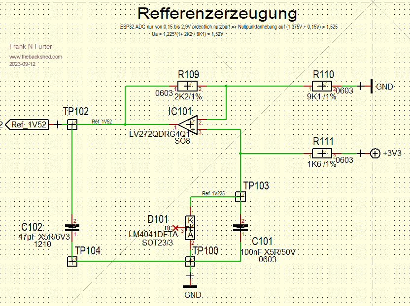

@Pluto:
You are right! I didn't look at the picture thoroughly enough - those who can read are clearly at an advantage...
@phil99:
1) Swapping N and L has no effect on the curve.
2) This is my reference voltage generation:
There I used a 47µF for stabilization. Do you think I should make it bigger?
You mean I should connect the second capacitor here?
Frank

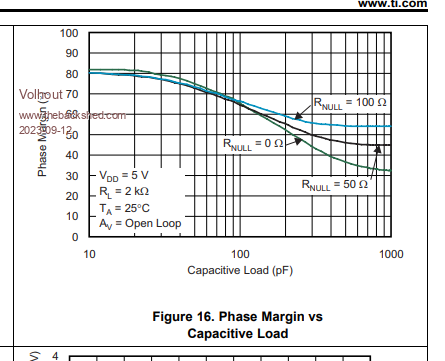

Posts: 5998
Posted: 10:03am 12 Sep 2023
@Frank,
For an opamp to be stable, it is preferred to have a phase margin of 45 degrees or more.
Your opamp (TLV272) phase margin versus capacitove load shows that the maximum capacitive load is 300pF (the 0 ohm series resistor curve).
47uF is FAR too much. Your TLV272 opamp will not operate reliable.
Additionally, if you plan to use the pico ADC is is best to use a LM4040 3V as reference at the VREF pin, and use a 1:1 voltage divider from that reference to create 1.5V. In that case they cannot drift appart. One reference for both.

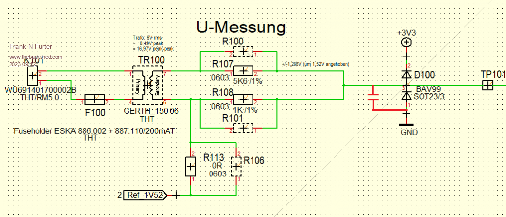

  Quote  There I used a 47µF for stabilization. Do you think I should make it bigger?
47µF should be enough.
  Quote  You mean I should connect the second capacitor here?
Yes, experiment with values. Too high and it may reduce the voltage accuracy yet it must be much larger than the capacitance between the windings to be effective.

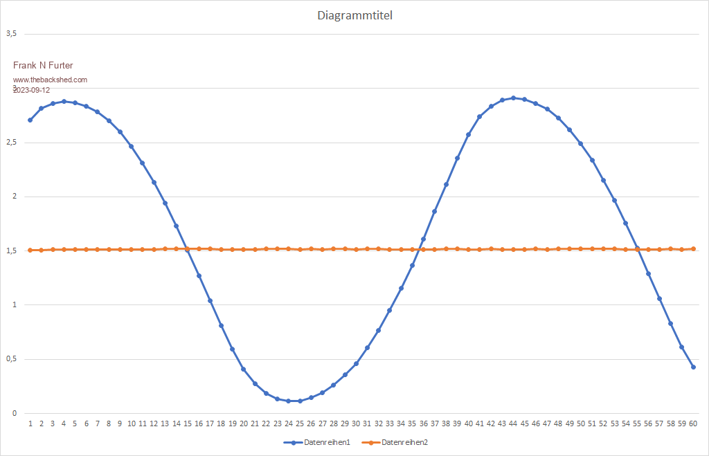

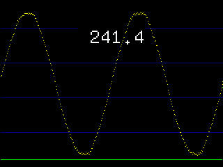

Frank N. Furter
Joined: 28/05/2012
Posts: 1143
Posted: 12:05pm 12 Sep 2023
@Volhout:
  Quote  Your opamp (TLV272) phase margin versus capacitove load shows that the maximum capacitive load is 300pF (the 0 ohm series resistor curve).
? ...that's just a voltage follower with amplification, isn't it?
@phil99:
I have now inserted a 10µF at this point:
The voltage measurement looks quite acceptable now:
The red line is the measured voltage reference - it is stable up to the 2nd decimal place - only the third decimal place changes. So I measure 1.51XXX every time.
Frank
Frank N. Furter
Joined: 28/05/2012
Posts: 1143

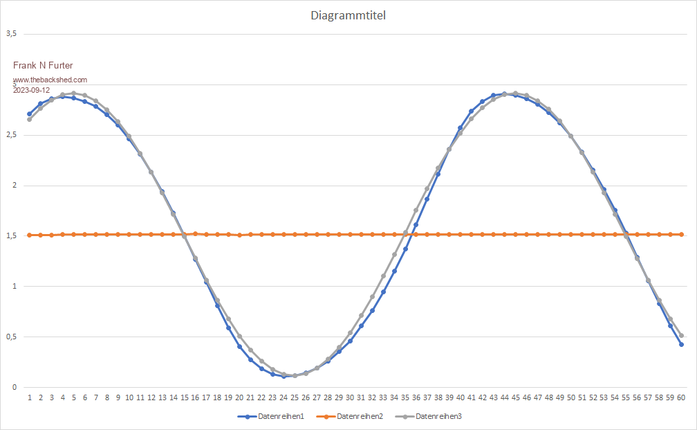

Posted: 12:25pm 12 Sep 2023
I have drawn an ideal sine curve (grey) here:
Do you think that is accurate enough???
Frank

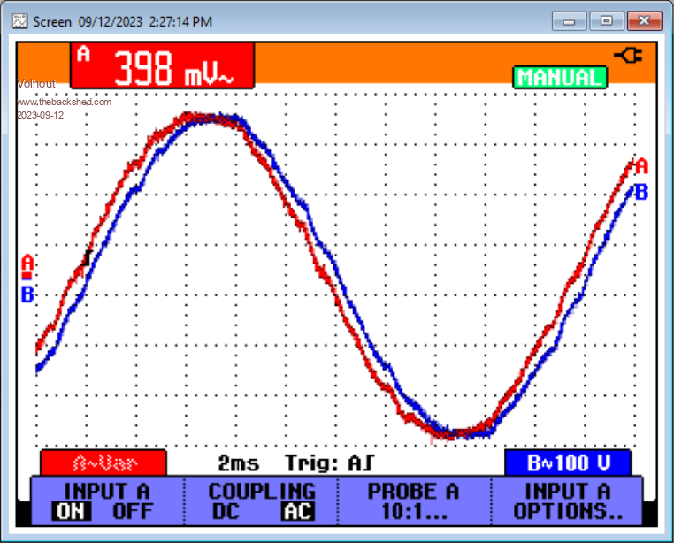

Posts: 5998
Posted: 01:14pm 12 Sep 2023
Hi Frank,
You have not given any pass-fail criteria. Is it good enough ...? I cannot judge.
You have put the zero crossing of both waveforms on top of eachother.
- The second zero crossing is roughly 3/4 sampe period wrong (at 40 samples per sinewave is 6.7 degrees).
- At this exact moment the amplitude difference between the 2 waveforms is almost 5% of the peak-peak amplitude. This will show up as harmonic distortion in the spectrum.
If you run an FFT on the samples it gives you a number for the harmonic content.
But the most important question is:
Is the waveform the same as the actual mains waveform. The actual mains waveform may show the same distortion, or it may not....
Your transformer does not have to create a perfect sine wave, but it needs to be a good copy of the input signal.
This is the input (blue) and the output (red) of my common mode choke circuit. The input is the 230V mains voltage. I used a scope with isolated input channels to prevent lethal voltages on the scope.
P.S. the output is leading in phase, not lagging as I would normally expect...
Edited 2023-09-12 23:30 by Volhout

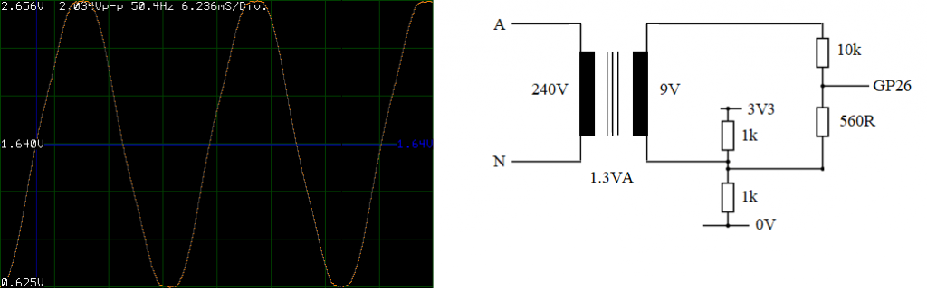

Posts: 3324
Posted: 01:52am 13 Sep 2023
That such a large capacitor was needed after the voltage divider without entirely eliminating the distortion indicates I was wrong. It can't be winding capacitance so I tested a variety of transformers and the largest was less than 1nF between windings, so a 100nF should have fixed it.
That leaves core saturation as the most likely cause, which suggests that transformer isn't suitable for 240V 50Hz.
This idea can be tested by putting a resistor in series with the primary. Choose a value that reduces the primary voltage to 150V to 200V and see what the output looks like.
To see if this is common to small transformers I made the following test circuit using a tiny 1.3VA transformer.
The result is much better and is what yours should look like.
Edited 2023-09-13 11:54 by phil99
How can I measure that? I have an oscilloscope and an isolating transformer...
Your curves look really very good - I think I have to try your setup too!!!
Do I see correctly that you used 150V AC in your simulation? What is the power dissipation of your circuit?
I should still have a few Würth common mode choke here...
@phil99:
I used this transformer here.
This is a small 0,33VA transformer...
I could put a second transformer in series for a test - should that do anything?
Otherwise I have to look for suitable resistors here...
Frank
Posts: 8973
Posted: 07:43am 13 Sep 2023
If you use resistors put a series string of them together so that you don't exceed their voltage rating. If you take the input impedance of the 'scope (usually 1M) into consideration then you can make up a potential divider so that the output voltage can't exceed the 'scope's input rating. The current through the resistors will be low so they won't get hot. I used to thread HV strings through fish tank airline tubing when measuring a few thousand volts. :)
Posts: 3324
Posted: 08:06am 13 Sep 2023
  Quote  I could put a second transformer in series for a test -
Yes that would be ideal. With such a tiny transformer (0.33VA) the primary resistance will be very high, the 1.3VA one measures 1.9k and the smaller they are the higher it gets.
So you don't have to alter the rest of the circuit also put the secondary windings in series, making sure they have the same phasing or there will be no output..
