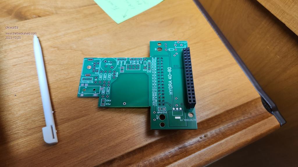

Hey Mick (&lizby) I soldered just the connectors for the display to the Hydra40-80 (revised gerbers) and shorted the links for the "old" dev board. I've noticed something unusual (at least to my understanding) that when I plug in the ips display the USB port disappears. I can connect through the serial console and then turn it off remove the display and I'm back to using the USB. Is there an explanation since I have not brought power to the Hydra from the dev board. Is that lack enough to explain this?
Posts: 8971
Posted: 10:03pm 24 Oct 2023
Good question.
The system is designed to normally take power from the USB. It passes through the 0R link on the F4 , feeds the on-board regulator to power the F4 and also through an external Schottky diode feed the 5V rail. It then feeds the display directly and a voltage regulator to give a second 3V3 rail.
A link is provided to power the F4 from the Hydra's regulator, but if you are powering from the USB don't fit it. That's only for powering the Hydra from 5V. You can't normally use the F4 like that without removing R5 or replacing it with a Schottky diode.
Another possibility may be that the backlight current is sinking the USB's 5V supply.
Any help?
If the F4 is powered but the Hydra (and hence the display) isn't then all bets are off. The data pins of the display could be holding pins down as it's not initialised.
Edited 2023-10-25 08:08 by Mixtel90

Posted: 12:06am 25 Oct 2023
I had a look and it appears there are 2 issues. the first is that without the power input to the hydra40-80 there is no power to the IPS display since the pnly power from the F4 board is 3.3v at the display connector. The other larger issue is I believe the connector for the IPS on the HYdra40-80 is not flipped to match the mounting of the display on the top side. I enclose a picture of my board as built.

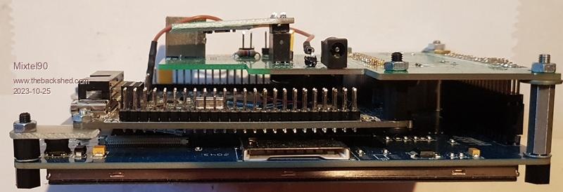

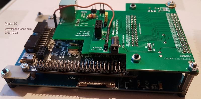

Posts: 8971
Posted: 07:22am 25 Oct 2023
Ah, you've assembled it wrong. :( The display connector goes on the bottom of the board in your photo, so both connectors are on the same side. This sounds weird until you look at he final assembly.
These pics are of the prototype. As I said, I haven't got an IPS display or a Hydra 40-80 board. It's the same idea though. The shape of the Hydra board lets you get to the pins of the Armmite F4.
The component silkscreen goes to the top of the assembly when the display is lying face down on the table, as shown in your pic.
5V from the Armmite F4 is best picked up from the serial port connector 5V pin via a link wire to the serial port on the Hydra. (Innermost pin, next to the diode, between the PS/2 and audio connectors). With this connection in the whole system is powered from USB. This is the brown Dupont wire shown in the pics of the prototype.
Spacers used in the above assembly are 5mm (6 off) for the end and front, 11mm (2 off) for the F4-Hydra join and 18/19mm (2 off) for the Hydra-display join. I used 18mm for the latter but had to pad it a little with washers to get the F4 parallel to the display.
Edited 2023-10-25 17:34 by Mixtel90
