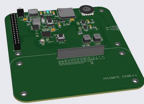

How is this possible given for compatibility with the Game*Mite you needed 8 specific GPIO pins free, were some of those not required by the standard PicoMite parallel display allocation?
Is there a manual/analog or a digital volume control? Surely the problem with the latter is that each program has to be adapted to deal with it. The former just works.
How big is it, it looks smaller than a Game*Mite with a less ergonomic "controller" ?
Posts: 11839
Posted: 09:25am 21 Oct 2023
  Quote  How is this possible given for compatibility with the Game*Mite you needed 8 specific GPIO pins free, were some of those not required by the standard PicoMite parallel display allocation?
Being in charge of the firmware allows a little flexibility to be added to pin allocation
OPTION LCDPANEL parallel_display,orientation [,backlightpin] [,DC pin]
So: the parallel display will always use 0-7 for the signal pins but the 4 control pins can be placed anywhere DC,WR,RD,RESET starting at "DC_in" and, of course that defaults to the previous mandatory configuration if omitted.
  Quote  Is there a manual/analog or a digital volume control?
Now manual - same pot as you are using but wired for stereo
  Quote  How big is it
100x100
If you want to supply them then once I have checked the design and published the gerbers then please do - I think the price is very good for a fully built unit. I don't and won't ever sell things - much too much hassle.

Hi Peter,
The schematic still shows an i2c bus expander but the connections from PicoMite to switches just seen to pass straight through it on a 1:1 basis ?
  matherp said  If you want to supply them then once I have checked the design and published the gerbers then please do - I think the price is very good for a fully built unit. I don't and won't ever sell things - much too much hassle.
Thanks Peter, but it's one thing to package up a few components and sell at close to cost to a few forgiving hobbyists but something entirely different to have to invest 125+ in stock and sell a more "complete" device. I suspect there are also regulations on sale of electronics devices, tax concerns and conflicts with my contract of employment that couldn't just be glossed over.
If your device (as impressive as it is, and as jealous as I am of your skills) is to have a future it will be with the existing 'mite vendors, and of those it looks like only @Grogster is still active .
Posts: 11839
Posted: 11:19am 21 Oct 2023
Just a label I left on the schematic by mistake - the chip has gone - the "expander" is just a header like on your board. The design is only possible smd because it needs the extra 3 pins on the RP2040 that are used on the Pico

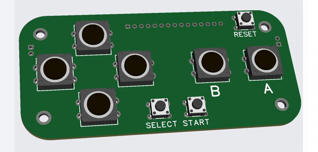

Peter, regarding your board I'll offer these thoughts based on experience with the Game*Mite ... even though I'm still a bit "put out" that it might stop @bigmik and I getting back some of our development costs :
1. Unless you've differed deliberately consider a direct copy of the Game*Mite's control area as it is ergonomically tried and tested, if nothing else just shift the buttons up a bit as it looks like they are too close to the bottom edge for comfort.
2. Consider how it might be possible via the 10-pin header and mounting holes to create a daughter board version of the control area (as an alternative option) that would then sit at the same level as the LCD module. You'd need to add at least one more pin to the header to handle RESET and you need to be careful of horizontal clearance between the LCD and daughter board. I believe that such a design (LCD and controls at same level) will be easier for someone to encase.
3. I suspect people would want to mount the battery and speakers underneath, rather than via the terminal blocks on top, check that is catered for.
4. Assuming it will make very little difference to the cost consider adding a "push-push" type uSD card (on the same pins as the LCD one), a full sized one sticking out of the LCD is liable to be accidentally snagged. Less of a problem for your design of course because of the bigger flash.

TBH I like to have both options open. On one hand there's the kit, which I love (I've always loved building electronic kits!). Even if the final spec is lower it's the one I would choose first. On the other hand there is a SMD alternative, which is great if you want a Game*Mite but aren't into the delights of solder fumes and singed fingertips. Having them both in the same form factor - and still being able to see the "bits" is great. My grandson recently begged a faulty game-thingy from my wife so that he can take it to pieces to see what's inside. I think seeing my Game*Mite might be having an influence on him. :)
Peter, I agree with Tom on the thumb button positions. It would be nice if they were in similar positions. Perhaps no need for a PCB, a sketch would be close enough. It would give a closer look to the "family". Incidentally, from early experiments I think a sub-pcb for the "Chinese" buttons would be on 5mm spacers. I've still to confirm this.
My overall experiment is to lever the whole system into a Hammond case for those who don't like their electronics to serve dual purpose as dust magnets. :) It's too early to say how well this might go. I don't see 3D printed cases as a serious option.

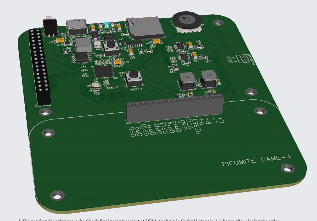

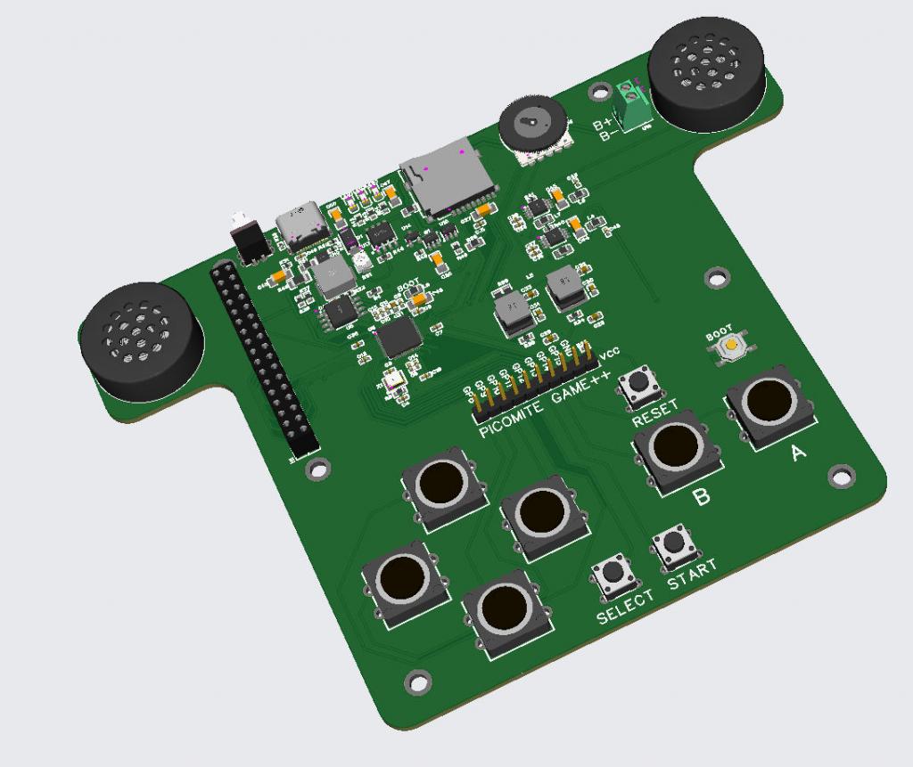

I've taken on board various comments and the result is
Schematic
4f2bc1ad-a3a1-4e76-a19d-0b97ed4f405b.pdf
Changes are:
All user switches now on a daughter board together with the terminals for the speakers
10k pot added to the charge circuit
micro-SD slot added
Volume control, switch, USB-C, LEDs, and sdcard all on top edge for easy access in a "box"
Unfortunately the main board is now 110mmx100mm which has a small impact on price (GBP6.77 vs GBP1.65 for 5) but there simply isn't room for a decent switch layout below the 3.2" 8-bit parallel ILI9341.
Edited 2023-10-29 01:01 by matherp

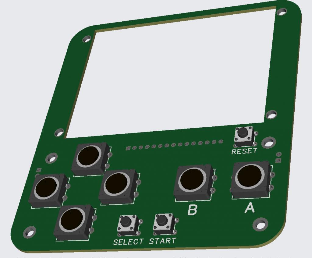

Here's an idea. Why not make the switch PCB a bezel for the screen?
Posts: 9124
Posted: 04:33pm 28 Oct 2023
Because, if you use the Chinese buttons that Tom used, the buttons may be too high. The top clips onto the switch base and has a lip round it, intended to come up against the inside of the top plate. I discovered that putting the button board on 5mm spacers brought the lip up to about the same level as the front surface of the display. Of course, you can't fit a SIP connector in the 5mm gap.
Posts: 4395
Posted: 04:55pm 28 Oct 2023
I like the bezel (I had/have similar ideas for the Game*Mite), but like Mick says you would need to make sure you used SMD buttons on the "daughter-board".
I was going to suggest that you could get the main PCB back to 100x100mm by having the daughter-board overhang the main PCB by 10mm, though that isn't compatible with using it as a bezel, unless the bezel is then "outsize".
Looking good,

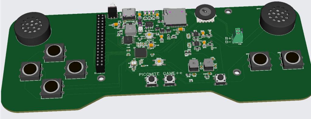

Courtesy of Mick's PCB design
LCD will mount direct without a connector and a top bezel cutout will hide the battery with the display, speakers and switches poking through
Edited 2023-10-29 07:50 by matherp
Posts: 9124
Posted: 07:32am 29 Oct 2023
I wonder why that appeals to me?  ;)
Did you need to scale it up for the 3.2" display? I didn't design it round that one.

Here's the final version. Because the display will mount direct to the board the level of the switches and screen should be good. I'll get a couple made and then release the gerbers. When they arrive I'll also do a 3D print box design
4683d882-0388-4721-a757-f82ebdc0fd66.pdf
All parts are in stock at JLC but it probably makes sense to fit the switches yourself so you can chose the exact type and the two headers should be omitted (included for clarity)
Cost for 5 boards with all components as shown GBP98.4 plus shipping and any relevant taxes. Cost with all through hole components omitted GBP74.88

Looks like C5 is missing in the current PDF.
 Will there be gerbers for
