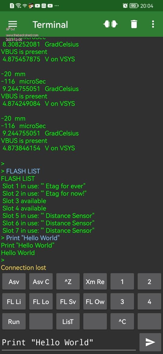

After Linux at page 7
Android
Use the 'Serial USB Terminal' app.
Select Coniguration/Import from the right menu.
Save this as your coniguration file UsbConfig.txt into the Download folder.
 "package": "de.kai_morich.serial_usb_terminal",
 "date": " 20230321-034009",
 "config": {
   "pref_auto_scroll": true,
   "pref_baud_rate": "115200",
   "pref_break_duration": "100",
   "pref_char_delay": "0",
   "pref_charset": "UTF-8",
   "pref_clear_send": true,
   "pref_data_bits": "8",
   "pref_device_hash0": 1661018981,
   "pref_device_hash1": -537333423,
   "pref_device_port": 0,
   "pref_device_position": 0,
   "pref_driver_mappings": [],
   "pref_font_family": "0",
   "pref_font_size": "14",
   "pref_keep_screen_on": true,
   "pref_line_delay": "0",
   "pref_m101_action": 0,
   "pref_m101_mode": 0,
   "pref_m101_name": "FL Li",
   "pref_m101_value": "FLASH LIST",
   "pref_m102_action": 2,
   "pref_m102_mode": 0,
   "pref_m102_name": "FL Lo",
   "pref_m102_value": "FLASH LOAD ",
   "pref_m103_action": 2,
   "pref_m103_mode": 0,
   "pref_m103_name": "FL Sv",
   "pref_m103_value": "FLASH SAVE ",
   "pref_m104_action": 2,
   "pref_m104_mode": 0,
   "pref_m104_name": "FL Ow",
   "pref_m104_value": "FLASH OVERWRITE ",
   "pref_m105_action": 2,
   "pref_m105_mode": 0,
   "pref_m105_name": "3",
   "pref_m105_value": "3",
   "pref_m106_action": 2,
   "pref_m106_mode": 0,
   "pref_m106_name": "4",
   "pref_m106_value": "4",
   "pref_m1_action": 0,
   "pref_m1_mode": 0,
   "pref_m1_name": "Run",
   "pref_m1_value": "RUN",
   "pref_m201_action": 0,
   "pref_m201_mode": 0,
   "pref_m201_name": "Asv",
   "pref_m201_value": "AUTOSAVE",
   "pref_m202_action": 0,
   "pref_m202_mode": 0,
   "pref_m202_name": "Asv C",
   "pref_m202_value": "AUTOSAVE CRUNCH",
   "pref_m203_action": 0,
   "pref_m203_mode": 1,
   "pref_m203_name": "^Z",
   "pref_m203_value": "1A",
   "pref_m204_action": 2,
   "pref_m204_mode": 0,
   "pref_m204_name": "Xm Re",
   "pref_m204_value": "XMODEM RECEIVE ",
   "pref_m205_action": 2,
   "pref_m205_mode": 0,
   "pref_m205_name": "1",
   "pref_m205_value": "1",
   "pref_m206_action": 2,
   "pref_m206_mode": 0,
   "pref_m206_name": "2",
   "pref_m206_value": "2",
   "pref_m2_action": 0,
   "pref_m2_mode": 0,
   "pref_m2_name": "  ",
   "pref_m2_value": "",
   "pref_m301_action": 0,
   "pref_m301_mode": 1,
   "pref_m301_name": "Esc",
   "pref_m301_value": "1B",
   "pref_m302_action": 0,
   "pref_m302_mode": 1,
   "pref_m302_name": "  ",
   "pref_m302_value": "",
   "pref_m303_action": 0,
   "pref_m303_mode": 1,
   "pref_m303_name": "^C",
   "pref_m303_value": "03",
   "pref_m304_action": 0,
   "pref_m304_mode": 1,
   "pref_m304_name": "Ins",
   "pref_m304_value": "0E",
   "pref_m305_action": 0,
   "pref_m305_mode": 1,
   "pref_m305_name": "Home",
   "pref_m305_value": "15",
   "pref_m306_action": 0,
   "pref_m306_mode": 1,
   "pref_m306_name": "░↑",
   "pref_m306_value": "10",
   "pref_m3_action": 0,
   "pref_m3_mode": 0,
   "pref_m3_name": "LisT",
   "pref_m3_value": "LisT",
   "pref_m401_action": 0,
   "pref_m401_mode": 1,
   "pref_m401_name": "F1",
   "pref_m401_value": "11",
   "pref_m402_action": 0,
   "pref_m402_mode": 1,
   "pref_m402_name": "F2",
   "pref_m402_value": "17",
   "pref_m403_action": 0,
   "pref_m403_mode": 1,
   "pref_m403_name": "F3",
   "pref_m403_value": "12",
   "pref_m404_action": 0,
   "pref_m404_mode": 1,
   "pref_m404_name": "shF3",
   "pref_m404_value": "07",
   "pref_m405_action": 0,
   "pref_m405_mode": 1,
