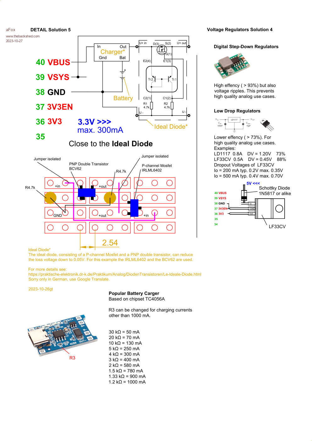

Cheat Sheet Update
Many thanks for your help.
I have changed the Mosfet part because I found a detailed Ideal Diode description.
For more details see:
https://praktische-elektronik.dr-k.de/Praktikum/Analog/DiodenTransistoren/Le-Ideale-Diode.html
Sorry only in German, use Google Translate.
I have not problem to get the suggested parts here in Germany.
What is in your country?
Comparsion Types:
P-channel Mosfet IRLML6402?
PNP double transistor BCV62?
Pico Power Supply Cheat Sheet 2023-10-26.zip
Any suggestions are welcome!
Gregor
Edited 2023-10-27 10:21 by aFox
aFox
Joined: 28/02/2023
Posts: 110
Posted: 12:28am 27 Oct 2023
I just noticed that the capacitors are missing next to the LF33CV.
Practical suggestions?
Gregor

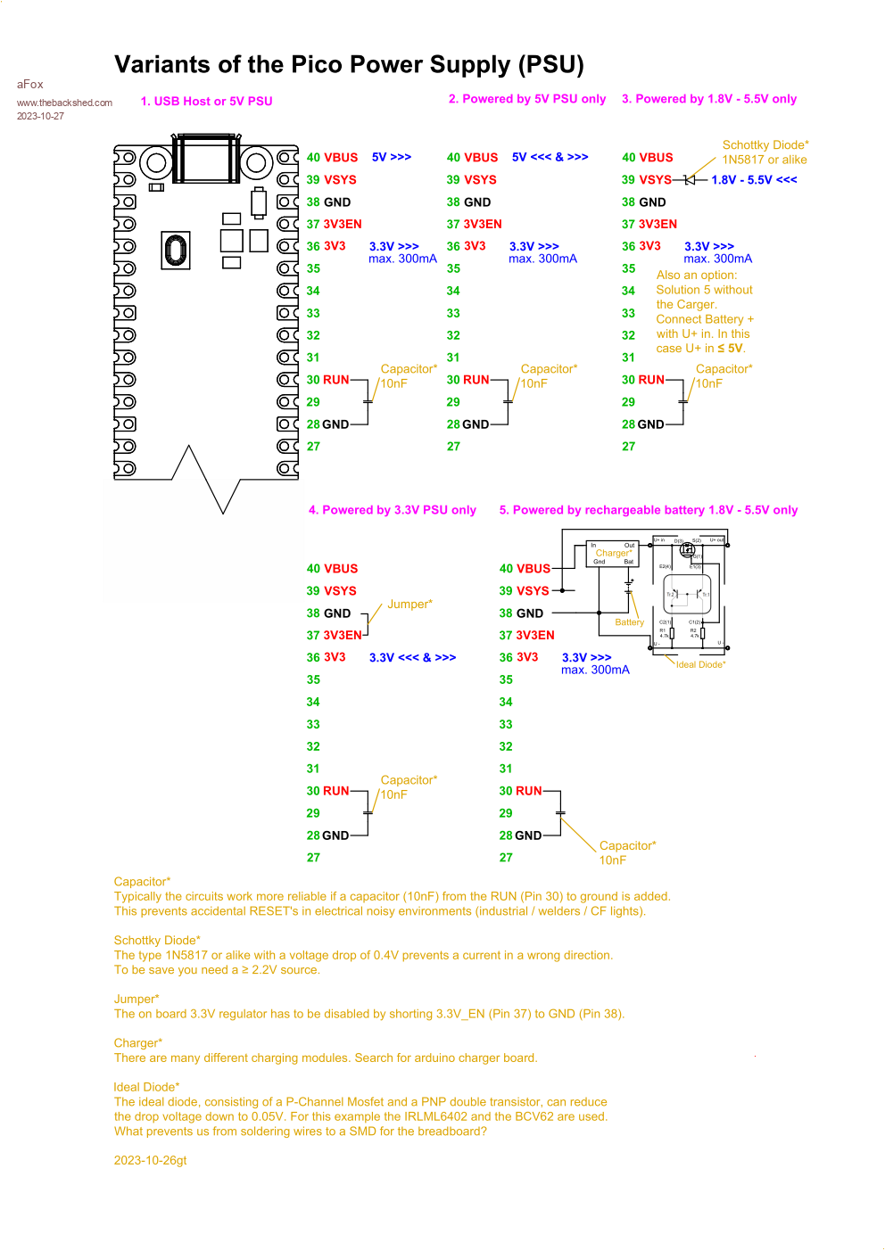

I think we have to talk also about the Jumper in Solution 4
because if we use the USB port for a program update.
Do we get in trouble?
Do we have 5V on the 3.3 port (Pin 36)?
Gregor
amigawizard
Joined: 15/08/2023
Posts: 43
Posted: 01:53am 27 Oct 2023
 " NO ! "
      Wayne  !
Posts: 3378
Posted: 04:52am 27 Oct 2023
Expanding the above answer, the jumper only inhibits the on-board regulator. It does not bypass it.
Solution 4 only runs from the external 3.3V supply while the jumper is on. Firmware loading proceeds as normal.

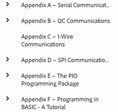

The answer to that is that the manual (like all the others) is about running MMNasic on a particular platform, not about the platform itself. It gives essential information such as the pinout and basic power supply requirements together with a few examples of how to use the GPIO pins. That's all. It doesn't need anything else.
We come up against this frequently. How much do you *need* in the manual vs how much would someone *like to see* in it. Space is limited and time to produce and keep it updated is limited.
Your PSU information is great, but IMHO it doesn't belong in a firmware manual about MMBasic. It belongs in a second manual that is specific to the Pico or PicoMite (it's a hardware subject that's relevant to both) or to just the PicoMite if you prefer. In fact, some of it, with different connections obviously, also applies to the Micromite and most of the boards in that family. Do you see what I mean about it being an electronics course?

  Mixtel90 said  Your PSU information is great, but IMHO it doesn't belong in a firmware manual about MMBasic. It belongs in a second manual that is specific to the Pico or PicoMite
Literally, the title page of the manual is:
PicoMite
A Raspberry Pi Pico Running
the MMBasic BASIC Interpreter

  JohnS said  Otherwise where do you draw the line? I2C, SPI, RS232, 1-wire, Ohm's Law, electrons, quantum physics, ...
PicoMite Manual:
Ok, no Ohm's Law or quantum physics, but I think this particular cheat sheet on powering the PicoMite would be worthwhile in an Appendix.
