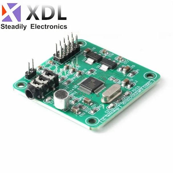

I'm trying to get a VS1053 running.  I'm confused as to what is required;
Homa posted am example where he included "option audio vs1053 GP2,GP3,GP4,GP9,GP8,GP7,GP6.  but your post says
PLAY VS1053 XCSpin, XDCSpin, DREQpin, XRSTpin [, fname$ [,interrupt]]
do I wire mso msi and sck to gp2,gp3,gp4 or do I wire them to option system SPI
GP10,Gp11,GP12?

  crazycloud said  I'm trying to get a VS1053 running.  I'm confused as to what is required;
GP10,Gp11,GP12?
I give you my config and use
it is aviable with cytron maker pi pico (same as card use by Pete - see on top of this topic)
PicoMite MMBasic Version 5.07.08RC20
OPTION SDCARD GP15
OPTION AUDIO VS1053 GP2,GP3,GP4,GP9,GP8,GP7,GP6', ON PWM CHANNEL 1
> play mp3 "b:track0002.mp3"
For VS1053, you need to use other SPI pins than system SPI (like SdCard)
And forget config and example of the first Pete's post, it is wrong because it uses the same SPI as the SPI System
the good connect pin's function is:
OPTION AUDIO VS1053 SPICLKpin, SPIMOSIpin, SPIMISOpin, CSpin, DCSpin, DREQpin, RESETpin

I tried this
WebMite MMBasic Version 5.08.00b5
OPTION WIFI NETGEAR57, **************, PICOE6616408437
OPTION TELNET CONSOLE ON
but it did not work.  I am watching all my pins with an oscilliscope. I get digital data on all the VS1053 lines, but only noise on the audio output. I have the audio
wired into the aux input of a bluetooth speaker.  I don't hear anything.
I uploaded a sample mp3 file of about 700K. I can tell its getting to the VS1053 because the embedded leds on my pico board show activiy.  I am using a pico carrier
board that doesn't have a built in SD card. I didn;t define option SPI GP10 GP11 Gp12
because of that.  Is that correct? I only need to define that if I have a 2nd SPI
device?
my wiring to the VS1053 is SPICLK=GP2  SPIMOSI GP3 SPIMISO GP4 CS GP9 DCS=GP8
DREQ = GP7  RESET = GP6.  In the past months I have gotten a camera hooked up and working with my pico. I got the speech synthesis board working too.  But this is much more confusing.

I just noticed that I don't have any digital data on GP8 which is the XDCS line.
I have a schematic of the VS1053 board.  according to the documentation XDCS is a chip select line and an active low signal. it should go low to activate the VS1053.
My pin GP8 is always high.  I wonder if I have a defective pico?
Does anyone else have a scope hooked up to their VS1053 board?

  crazycloud said  ...I have the audio
If you are using the VS1053 demo board (Aliexpress) you cannot connect it to powered speakers or amp as it causes a short.
You can only use the board with headphones. It must be modified to use an external amp.  See this site
It doesn't use a common ground, it uses something called GBUF which cannot be connected to ground. There is a circuit diagram on the above site that shows a workaround for this.

I have this board
https://www.aliexpress.us/item/3256805201102831.html?spm=a2g0o.order_list.order_list_main.29.412f18022vuP4L&gatewayAdapt=glo2usa
I also connected it to high impedance headphones. Still no sound.
