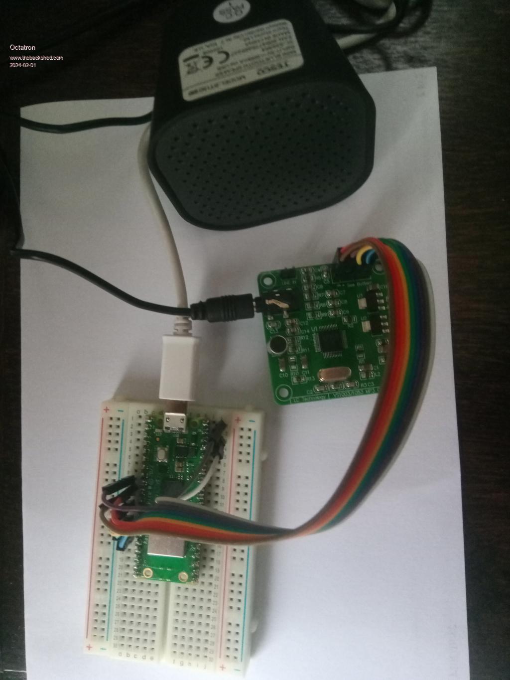

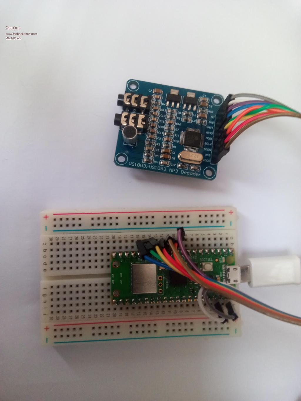

I had been thinking of putting together a web radio for some time and I saw these posts and thought go for it, simple, but I'm having problems. I've checked the program and connections to the V1053 board numerous time and can't find a problem. This is the fault I'm getting:-
> run
[18] Play stream buff%(),r%,w%
Error : VS1053 read failure
Anyone any ideas as to the problem?

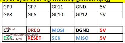

Posted: 09:41am 28 Jan 2024
Seen from the component side of the VS1053 board:
OPTION AUDIO VS1053 GP10,GP11,GP12,GP9,GP8,GP7,GP6

Are you using the same board as Matherp in first post of this thread?
No it's slightly different, see photo.

Is it VS1053 or VS1003 chip onboard? My earlier checks on AliExpress indicated thet the boards looking like yours are VS1003.
Octatron
Joined: 01/04/2015
Posts: 27
Posted: 03:17pm 28 Jan 2024
I think I have found the problem. The chip on the board is a VS10033 not a VS1053 and according to VLSI's website there are differences.

Posted: 05:04pm 31 Jan 2024
New VS1053 board has arrived connected it up and it works, wonderful.
Previous board was sold as a VS1053 but it had a VS10033 chip (should have spotted it earlier), now on the way back to the supplier for a re-fund. So I'm up and running, thanks for the help.
