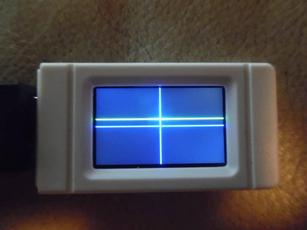

Posts: 2807
Posted: 10:23pm 06 Feb 2024
I got no idea how to set this up Volhout. strange errors. how to clear pins?
RUN
[9] ADC open 500000,3
Error : Invalid frequency
> C:\Users\stanley555\Documents\mmbasic programs\160x80trigscopev07.bas
Uploading using:  'target port\COM9:115200 s\picomite
Upload started
NEW
AUTOSAVE
Upload completed 1
Saved 862 bytes
Time taken: 2625mS
RUN
[9] ADC open 50000,3
Error : Pin GP28 is not off or an ADC input

[7] SetPin GP28,off
Error : Pin 34/GP28 is reserved on startup
 'SetPin GP28,pwm1A 'this optional test signal comment out
 'PWM 1,10000,50  'square wave ,this optional test signal comment out
'SetPin GP28,off
 dim c%,x%,samples!(480)
 SETPIN GP26, AIn
 adc open 50000,3
 FRAMEBUFFER CREATE F
 FRAMEBUFFER LAYER L
 FRAMEBUFFER WRITE L
 line 0,mm.vres/2,mm.hres,mm.vres/2,,rgb(blue)
 line mm.hres/2,0,mm.hres/2,mm.vres,,rgb(blue) 'draw cross to layer L
 'line 119,0,119,239,,rgb(blue)
 'line 0,119,239,119,,rgb(blue)
 FRAMEBUFFER WRITE F
 do
   adc start samples!() 'get new samples
   'trigger
   c%=0
  do:If samples!(c%) > 0.1 then if samples!(c%+1) < 0.2 then exit do
inc c%:loop while c%<160
math scale samples!(),239/3.3,samples!()'scale to 80 pixel height
FRAMEBUFFER COPY L,F
for x%=0 to 238 'screen width
     line x%,samples!(x%+c%),x%+1,samples!(x%+1+c%),,rgb(green) 'draw new sample from sample(c%)
next x%
FRAMEBUFFER COPY F,N
loop

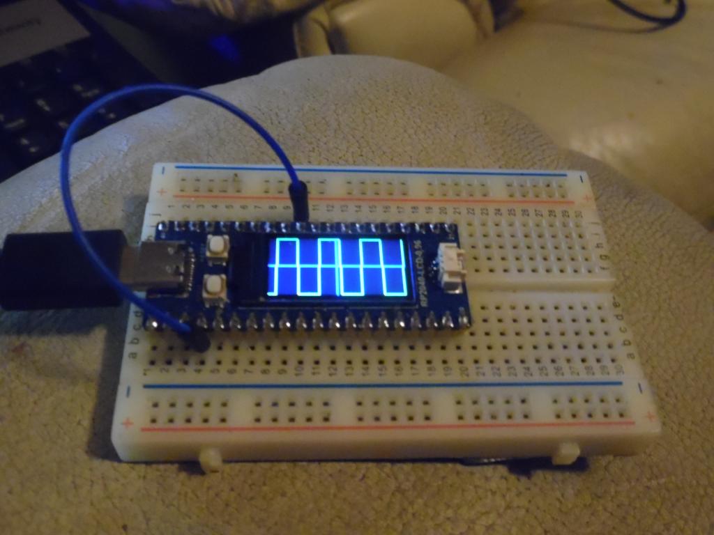

Posts: 8968
Posted: 10:39pm 06 Feb 2024
You can't use GP26 as AIN. You can't read it.
ADC OPEN accepts n_channels as the number of channels. You can't use the first two as they aren't available, so set it to 3. Then you'll get GP26, GP27 and GP28.
You'll have to use GP28 as the input.

Posts: 8968
Posted: 09:50am 07 Feb 2024
If you can't get GP29 to work then use OPTION PICO OFF to free off the pins that are normally dedicated to the Pico.
The I2C/ADC connector should work fine.
Make GP28 the input that you are using.
You MUST specify 3 ACD channels in the ADC OPEN command, even though you can't use ADC0 and ADC1.
You will probably also have to use SETPIN GP26 AIN and SETPIN GP27 AIN as well as SETPIN GP28 AIN or you'll probably get an error from ADC OPEN
GP26 and GP27 are still there but they aren't connected to anything. They will read but return junk values. You'll probably have to think of this as a 3-channel scope but only plot ADC2 (GP28).
Unfortunately, because ADC0 and ADC1 are also being read your maximum usable frequency will be lower. In the "round robin" automatic reading of the ADC channels you have to read ADC0 and ADC1 if you want to read ADC2 - you can't get away from that.
