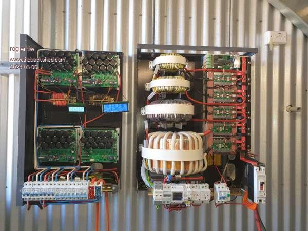

I've connected the earth wires between the MPPT's and inverter framework  ...  and hooked up the surge protectors in the combiner boxes. They will then be connected to the main earth inside the property meter box using the 3-core cable from the inverter.
Sooo  ...  the moment of truth comes tomorrow morning. The electrician is coming to fit the ATS and hook it all up in the meter box. Yahoo!!!
Then I need to complete the covers for both devices and hide all my work.
Cheers,  Roger

And it's all connected and running fine.
90+ amps coming in and house and workshop running off the Warpverter. Happy days.
Still plenty to do  ...  make up some permament battery leads  ...  mount another 6kW of panels on the roof  ...  make covers for both units
Cheers,  Roger

Brilliant work Roger, I love the effort that you put into winding those Toriods.
The MPPT controllers came out really well. At first glance that construction could pass for an expensive commercial unit. Certainly says it means business.

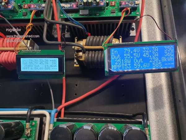

The inverter has been going well and I've been using far more power than normal for the last few days  ...  roughly 35kWh each day for the last three days. That had depleted the battery somewhat by late evening so I've applied a charger for a few hours last night and a couple hours tonight  ...  to make sure it survives overnight.
174.8kWh over the last 5 days.
We definitely need the additional 6kW of panels to be fitted and if it hadn't been so hot over the weekend I would have made a start. Three days of 41. Lovely. Autumn is here and we finally get some summer weather. Where did I read we were to have the hottest summer in 125,000 years. Pffftt!!! Certainly not here in SA  ...  been the least like summer weather I've seen in all my years.
With the heat I noticed the transformers started to warm up a little  ...  about 47-48 degrees at one stage. Because I Haven't fitted the fan yet, I've had a pedestal fan aimed at it during the heat of the day. The heatsink remains pretty much at ambient which amazes me. The only other thing that gets hot are the chokes in the mppt controllers.

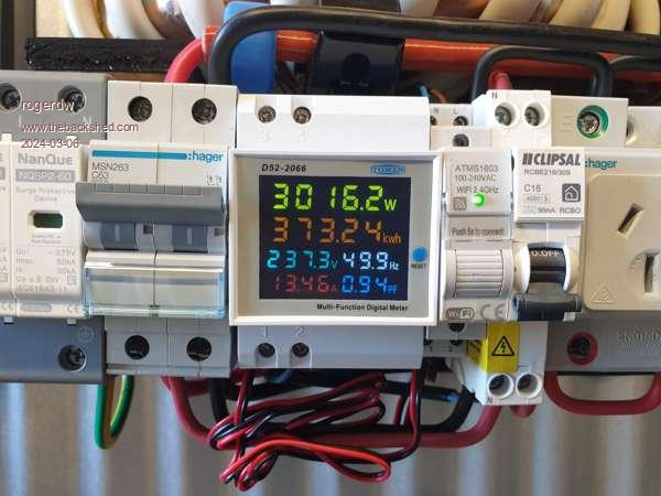

When I turned the inverter AC-out off this morning I took a risk and left everything on in the house. The ATS changed over quickly enough that the PC's all stayed on and all I noticed was a flicker to the fluros in the shed. No one has commented so far at home here.
This is the ATS I have here  ... the 100 amp version. The 125 amp one was not listed when I first bought mine.
When the electrician tested it when he installed everything I was amazed at how quickly it changed over each way  ...  so thought it was worth the risk  ...  plus the power goes off and on once in a blue moon and I have no control over that.
