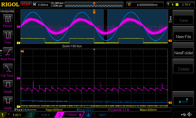

to see what is being put into the primary choke, all will be revealed
with a current probe in series with the choke.
You will see the "near DC" flowing through it, due to the AC load
and the toroid reactance and you will also see the PWM on top of this much slower
changing current.

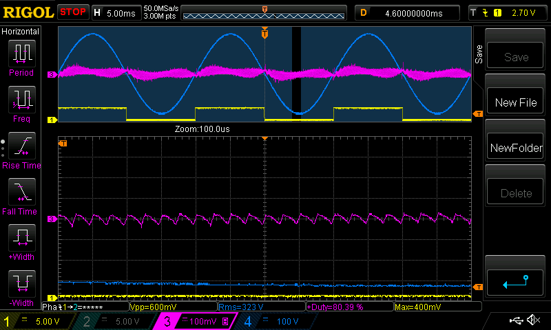

this is what I see with a current sensor in series with the choke and with
no AC load. (what I call "idle")
and here it is with a load of about 100W
it seems to me that the current ripple in the choke does not change
due to AC load, apart from a DC offset added to it.

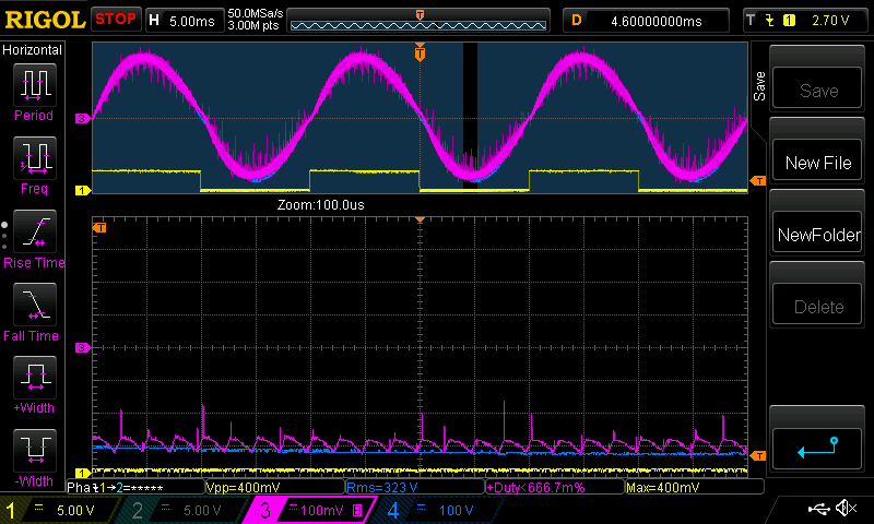

here it is with 200W load.
more offset, but same ripple (close enough for me to call it the same)

Poida, not sure what loads you have applied there or what increase the next picture is or what the current scale is (ie 100mV = Amps?) or what inductance value we are looking at or what the turn ratio of the toroid or the input voltage applied so the next comments are next to useless probably. You don't need to plug in all those unknowns but I would be more interested in the actual choke value you chose and how you chose that value ?
The p-p ripple will either have a fast rise leading edge and a longer slower fall - these are the delta I for the given choke.  When looking at a fixed point of the waveform this is less evident as the difference in slope is a small adjustment for the dynamic losses as we load the Toroid (mostly R losses).
As the load is increased for a well designed solution with more load the rising edge will be much longer and the falling edge will be faster but the P-P will not change a lot however if you look at the "hash" of the current waveform you can see the p-p level reduce a bit at the peak and quite a bit at the zero cross points.  This variation of rise and fall slopes should be more obvious also as you move over the 50Hz waveform and check out the rise/fall of the sawtooth magnified at various points from 0 to 90 degrees and back again.
The 50Hz Dc current is in the sine shape of the current waveform, more obvious with more load, the p-p is riding on the varying 50Hz dc as there is definitely more dc choke current with the rising 50Hz Dc level.

Poida did you add a third picture in the edit with the 200W or was it off my screen  ?
If it was there all along - sorry I missed it until after my reply post. I also missed the 100W load between the first 2 pictures which may have been there. I will take a break from this for a while I think and get more needed sleep !

Mike,
I first posted it with two images then re-read to check if I was making the point
I wanted and added the 3rd image.
I thought it was a great way to see what the choke is exposed to.
