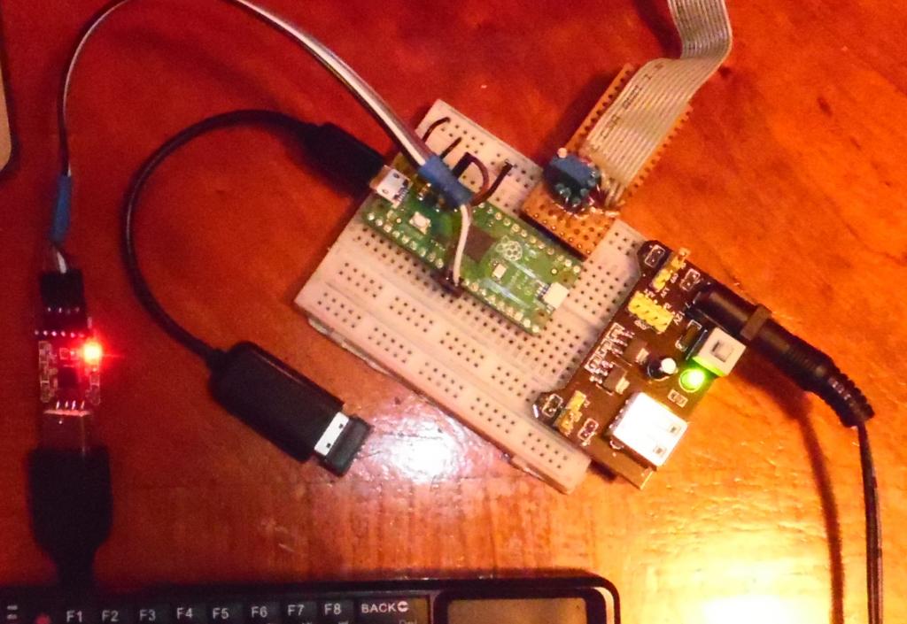

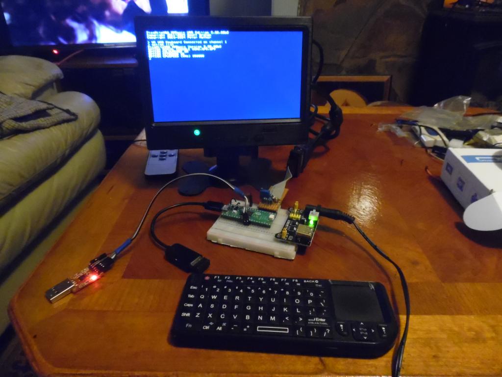

I loaded the vga usb rc and it works with micro wireless keyboard. impressed so posting. haven't tried the usb to ttl yet to program it.
It wasn't what I expected with like a console that takes keyboard commands.
I'm very impressed with usb, nice one, stan
I'm powering the usb to ttl at 5V, is that ok or use the 3.3V pin?
Edited 2024-02-09 06:22 by stanleyella
Posts: 9120
Posted: 10:18pm 08 Feb 2024
You need 5V into the VBUS pin as that's what the USB devices will be expecting. The actual TTL signals should be at 3V3 level.

I found connecting the usb to ttl to win pc the converter powered the picomite with no supply and it booted the picomite  and shows as com 10 but it crashes with mmedit. something wrong.
Posts: 2807
Posted: 01:02am 09 Feb 2024
Sorted usb to ttl. rx tx wrong but ran at 5V now 3.3V. dunno, didn't mess up the pico cos just flashed bubble universe from mmedit so the vga with 7" screen and micro keyboard works as I wished and the usb to ttl works. happy days.
If I turn the 5V to VBUS off, the screen just says usb keyboard disconnected, the pico still runs from the usb to ttl although it's powered to it's 3.3V pin to picomite 3.3V.
The usb to ttl will be powered by host pc 5V so will be 5V logic level??? blow gp??
should the usb to ttl be run through a bi-diectional logic level converter?
Posts: 6603
Posted: 01:39am 09 Feb 2024
Stan,
Set your USB-TTL converter to 3.3V
Connect the tx,rx and ground from the Pico to converter.
Do NOT connect the 5V/3.3V lead. The pico is powered separately.
Posts: 2552
Posted: 02:10am 09 Feb 2024
  stanleyella said  Sorted usb to ttl. rx tx wrong but ran at 5V now 3.3V. dunno [...] blow gp?? should the usb to ttl be run through a bi-diectional logic level converter
DO NOT ATTEMPT TO POWER YOUR USB TO SERIAL BRIDGE FROM THE PICOMITE!!!
USB to serial bridges are designed to be powered ONLY from the PC that they are plugged into. the chip (in your case it looks like a Silicon Labs CP2102) itself contains an onboard 3v3 regulator, and that regulated 3v3 is what is used for the TxD and RxD serial transceivers as well as the USB DP and DM transceiver; if you connected a multimeter to the TxD pin on the module you will see the pin sitting at around 3v3.
if you try feeding 3v3 power back into the USB to serial bridge from the PicoMite you risk blowing up the CP2102 controller chip.
if you try feeding
5v power back into the USB to serial bridge from the PicoMite you risk blowing up the USB port on your PC.

Posts: 9120
Posted: 08:13am 09 Feb 2024
If you don't mind having the console powering the setup you can use the 5V from that to feed VBUS and get rid of the external supply. You may have less current capability but that probably won't matter.
The 3V3 output from a CP2102 isn't usually used as it's only low current output (100mA absolute max, but it needs some current itself. Say 90mA for the user). I do use it now and again.
Posts: 2807
Posted: 02:21pm 09 Feb 2024
I plugged the usb to ttl (that's what is printed on the board) into win pc and scoped tx/rx and 3.6xxx volts. Too high? need logic level converter?
Found external 5V not needed, runs from usb to ttl adaptor.
the 7" monitor and micro keyboard work nice. I code on a pc with full size kb.
mmedit is fine and teraterm.

Posts: 9120
Posted: 02:37pm 09 Feb 2024
The USB-TTL converter has a link on it to select 3V3 or 5V. That powers the TTL output  from either the USB 5V or from the CP2102 internal 3V3 regulator so you need to set that to 3V3. The Pico can accept up to 3V6 - a bit more if the current is very limited. You should be fine at 3V6.
The 5V supply from the converter comes directly from the USB port of your PC.
You can connect EITHER the 5V from the USB-TTL converter OR the external supply, but never both as there's a danger of damaging your PC..
Edit:
What you are seeing is right.
This means that the PC has created virtual COM port COM10 for the connection.
COM10 Silicon labs CP210X usb to UART Bridge(COM10)
is MMBasic configuring which pins to use for the console.
