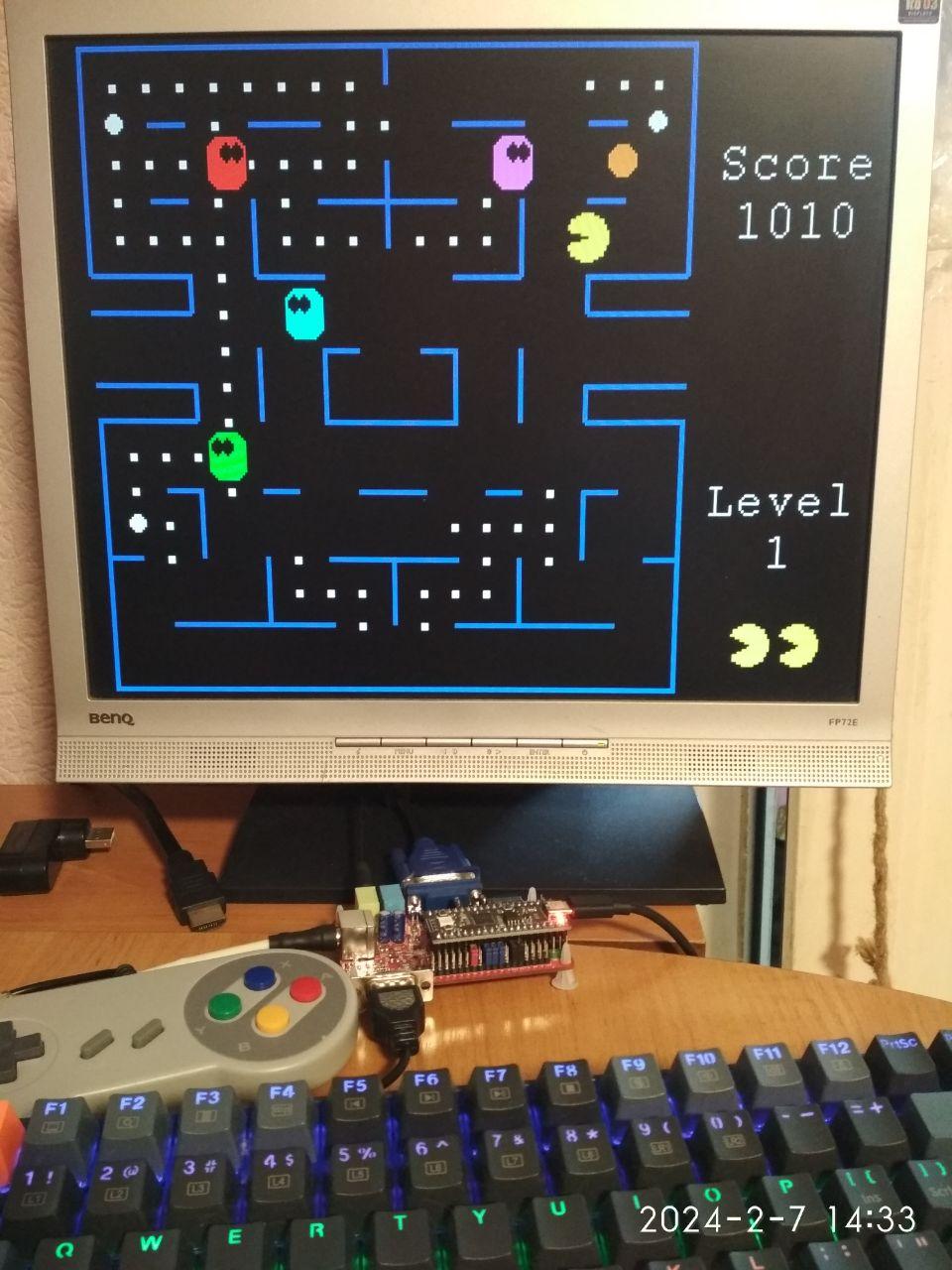

Posted: 12:56pm 07 Feb 2024
  matherp said
Please update your source and try again
Thank you! That helped :))
I would also like to ask what needs to be done to assemble the PicoMiteVGA USB version from these sources?
Posts: 11657
Posted: 01:08pm 07 Feb 2024
  Quote  I would also like to ask what needs to be done to assemble the PicoMiteVGA USB version from these sources?
Just use the cmake file in the PicoMiteVGAUSB repository. Does'nt come up in the first 6 but it is there
NB: you won't get PicoMan working unless you can reduce size as the USB buffers reduce program space to 96K from 100K which was the problem with the VGA first posted

Posted: 08:17am 08 Feb 2024
  matherp said
  Quote  Just use the cmake file in the PicoMiteVGAUSB repository. Does'nt come up in the first 6 but it is there
Yes, thanks, I found it...
And also, in order for it to start building without errors, I had to update the TinyUSB 0.16.0 library in Pico SDK 1.5.1
To file CMakeLists.txt
I added a line to print memory usage statistics
target_link_options(PicoMiteVGAUSB PRIVATE  -Xlinker --print-memory-usage)
The output was:
[build]            FLASH:      692368 B         2 MB     33.01%
[build]              RAM:      251584 B       256 KB     95.97%
[build]        SCRATCH_X:          0 GB         4 KB      0.00%
[build]        SCRATCH_Y:          0 GB         4 KB      0.00%
[build] [100%] Built target PicoMiteVGAUSB
You do not have two areas of memory used, maybe this would help with the lack of memory?
I know that other projects use this memory somehow.

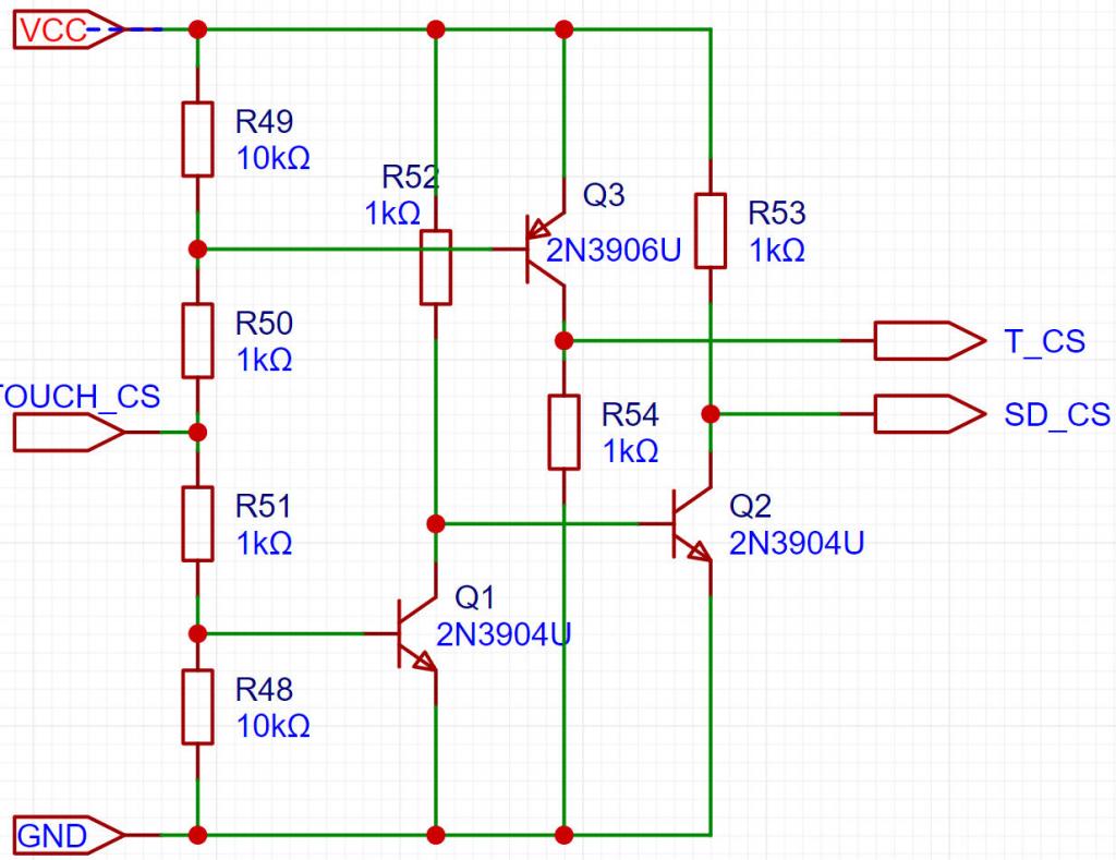

New command for initialising an SD card (not VGA versions)
OPTION SDCARD COMBINED CS
If this is specified the touch chip select pin is also used for the SDcard. In this case external circuitry is needed to implement the SD chip select.
The firmware uses the touch pin as follows:
TOUCH_CS  low: touch pin driven low
SD_CS low: touch pin driven high
TOUCH_CS and SD_CS high: touch pin set as input (high impedance)
A suitable tested circuit to implement this is as below:
Thanks to Turbo46 and Volhout for design and simulation of the circuit
