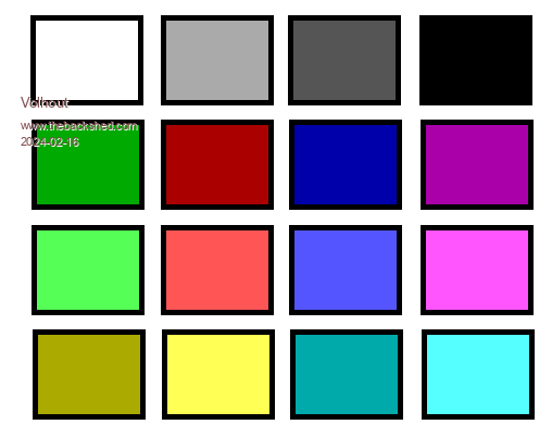

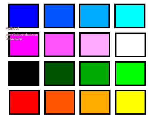

If you want to get closer to the C64 palette, I would advise to change the hardware.
Original Palette
R, G1 and B with 390 ohm resistors to VGA R,G,B
G0 with 820 ohm to R, 820 to G, 820 to B on VGA (G0 drives all pins at same time)
Looks closer to C64, and has 2 different grey tones, but misses out on pure R, G and B.
And (for Peter) is not so easy to convert from RGB 8:8:8 to RGB 1:2:1. You need a lookup table, and new color names.
Volhout (always looking for "grey / gray" tones to better mimick real life/Windows95)

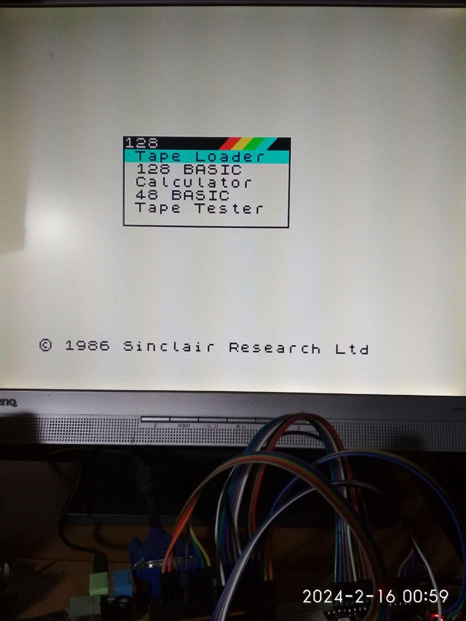

  Martin H. said
The colour values come closest to the spectrum colours in the "normal" RGB 121 for PicomiteVGA or LCD.
ZX_Spectrum 128k on PicoGAME VGA !!!
To begin with, I ported the fruit-bat/pico-zxspectrum project to the PicoGAME VGA scheme.
https://github.com/fruit-bat/pico-zxspectrum
Can you check it for yourself?
For now I made the sound single-channel on GP6
I changed the palette as you described, and yes, there is no gray!
If this topic is interesting, then there are at least two more ZX-Spectrum projects for Piro RP2040 whose authors I know.
What I don’t know is whether it makes sense to tinker with the limit of these projects for the VGA121 scheme since they use VGA222?
ZX-Spectrum_PicoGAME_VGA.ZIP

Posted: 11:38pm 15 Feb 2024
You need to place the folder from the archive in the root of the flash drive, enter the menu using F1 key.
Other information on the project's GitHub
By the way, the USB keyboard and some of the gamepads should still work.
Edited 2024-02-16 17:04 by javavi
Yes, as it turns out, the gray color of the ZX-Spectrum palette is the only thing missing from this VGA121 color scheme from PicoMiteVGA

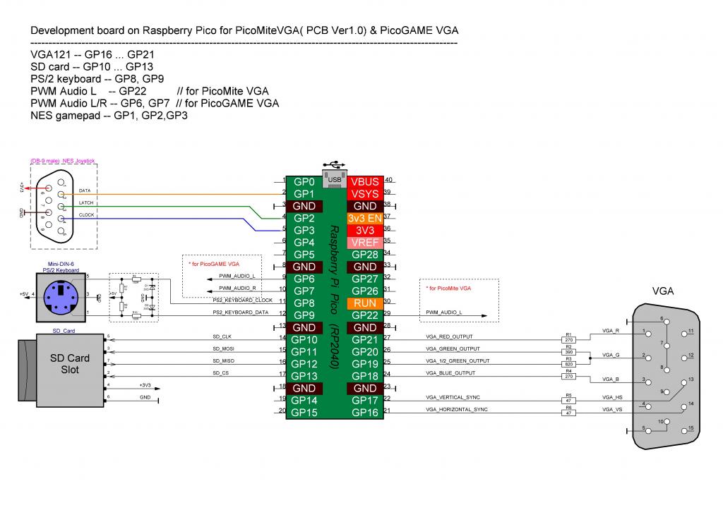

javavi
Joined: 01/10/2023
Location: Ukraine
Posts: 568
Posted: 09:25am 16 Feb 2024

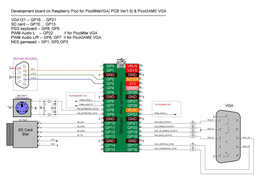

My Development board on Raspberry Pico
Edited 2024-02-16 20:10 by javavi

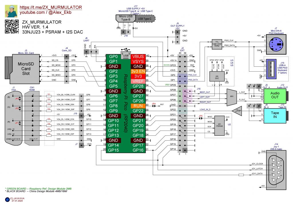

  Mixtel90 said  I'll get back to the new PicoGAME, I think.

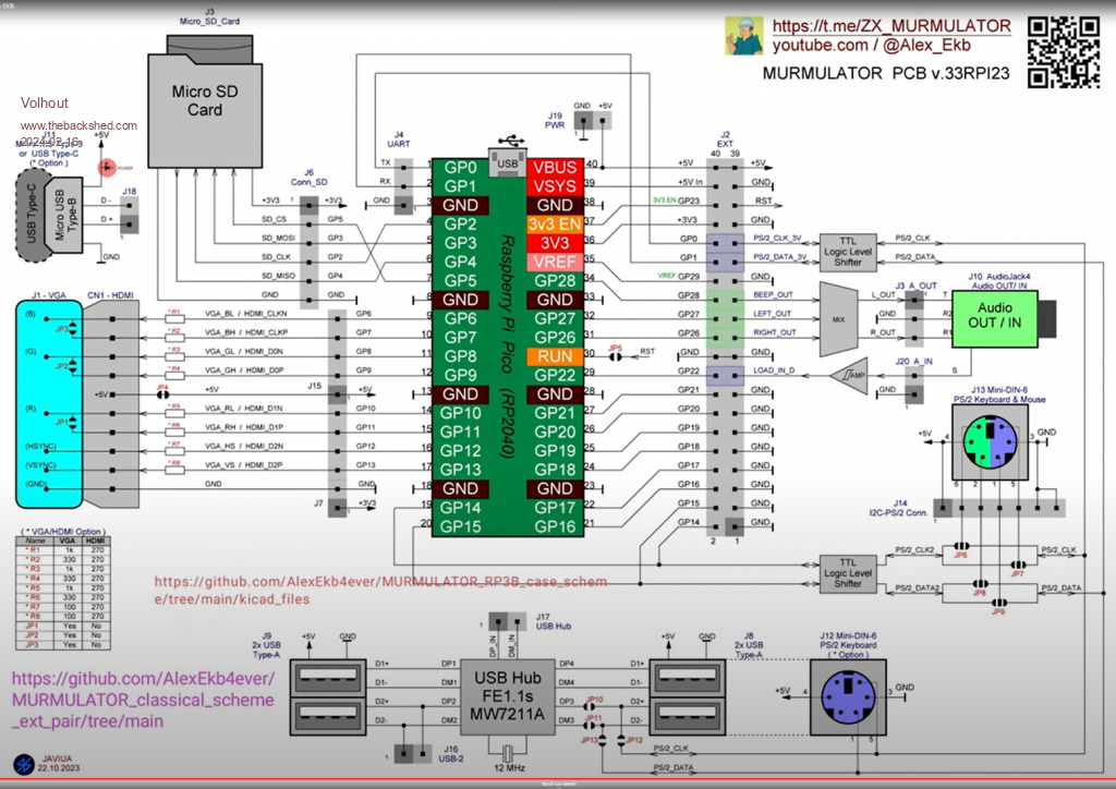

The intention was to include the guts of a VGA-hdmi converter
I am using a development platform called MURMULATOR already version 1.4.
It uses a VGA222 video output combined with HDMI and can connect an LSD screen and a composite video output adapter, and all this is connected to the same pins (but not at the same time :))
It turns out to be a very universal connection of video outputs.
Also in the latest version, I2S sound chip and an 8MB PSRAM RAM chip are optionally added.
Currently working on it:
- Four different ZX-Spectrum emulator projects
- NEC emulator
- GB and GBC emulator
- PC XT emulator
and other projects including PicoMightVGA were ported.)

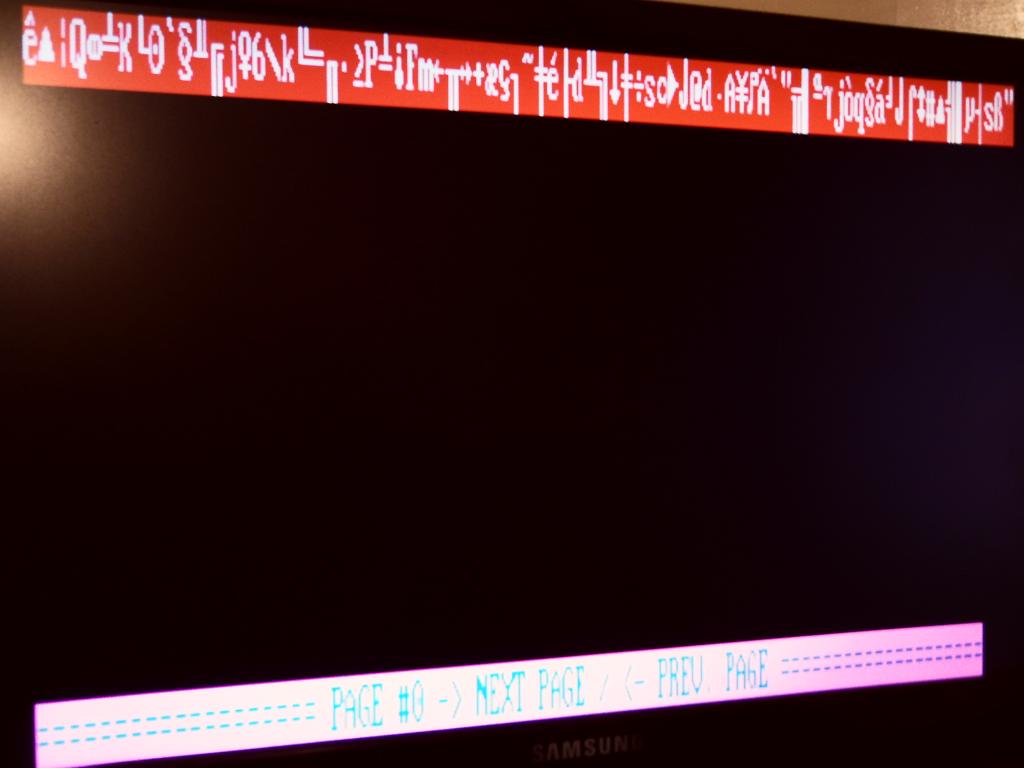

Posted: 05:54pm 18 Feb 2024
I built a new PicoGameVGA from scratch and tried again with the gameboy emulator and this is what I got.
The keyboard seems to be trying to do something but pressing the "Z" or the "X" key puts the Pico into BOOTSEL mode and gives a black screen/monitor goes into standby.
I have the GB Folder on the SD card but nothing seems to work.
Thanks.
Dave.
Also the Horizontal and Vertical are the wrong way around on the VGA socket.
Edited 2024-02-19 03:59 by cosmic frog
javavi
Joined: 01/10/2023
Location: Ukraine
Posts: 568
Posted: 06:39pm 18 Feb 2024
Hi Dave,
This is the picture that will appear when the GameBoy emulator cannot read files from the SD card.
There may be several reasons: there is no contact, incorrect connection, and not all SD cards may work here. You need to try other SD cards formatted in FAT32.
Yes, I corrected the VGA connection diagram.
Thank you!

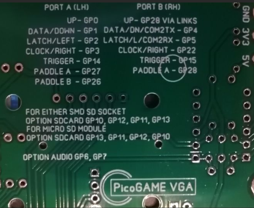

Posted: 07:20pm 18 Feb 2024
I get the same picture as Dave with the GameboyEmu on PicoGameVGA.
Please note that there are different options for SD socket and MicroSD module as the pins are switched in a different order.
I have inserted a standard SD card and it works fine with PicomiteVGA.
option list
PicoMiteVGA MMBasic Version 5.08.00
OPTION KEYBOARD GR, 0, 0, 0, 0
OPTION CPUSPEED (KHz) 252000
OPTION SDCARD GP10, GP12, GP11, GP13
OPTION AUDIO GP6,GP7', ON PWM CHANNEL 3
OPTION MODBUFF ENABLE  180
cheers
Martin
Edited 2024-02-19 05:34 by Martin H.
