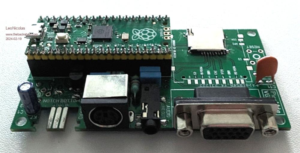

LeoNicolas
Joined: 07/10/2020
Posts: 604
Posted: 04:58pm 18 Feb 2024
As described by Turbo46 and Volhout, I'm trying to connect a modern mechanical USB keyboard to a PicoMite VGA with a PS2 connector. The direction is:
USB KEYBOARD ==> PicoMite VGA PS2 Connector
I don't have a PS2 Keyboard, and buying one is my last option.
Edited 2024-02-19 03:03 by LeoNicolas

By default the incoming 5V supply feeds the Pico via a regulator onto the 3V3 rail and the switcher is disabled. I'm not sure if this is how Leo has built it? You can take the GND off 3V3EN and leave the regulator out.
The barrel jack socket powers VSYS via a diode.
There is no connection to VBUS, but it could simply be linked to VSYS to get 5V out of the USB.
Isolating GP8 and GP9 might be a little awkward but you might be ok to just dab wires onto them for a USB-TTL converter. If that fails then the mosfets might have to be taken out or the traces to their source leads cut underneath the board.

Leo, Can you please tell me which one of of Mick's many boards you have. I can't find it and I want to look at the circuit diagram.
Bill
