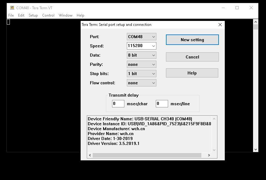

Posts: 10037
Posted: 10:41pm 02 Mar 2024
I've flashed the correct FW into the board, but I can't connect to the terminal.
I assume I use the USB-C port.
Assumptions again!
This time, I did check the bottom of the board, in case it mentioned something about how I have to setup the terminal.
I'm going now to re-read the thread about this board to see if I can pick up something there.
Posts: 9120
Posted: 10:52pm 02 Mar 2024
You connect to the terminal using the USB-TTL converter after flashing the firmware. You'll have to set your terminal to 115200 initially (it's not via USB into the Pico so the setting has to be done manually), but you can change that setting with an OPTION later if you wish.

Turbo46
Joined: 24/12/2017
Posts: 1694
Posted: 10:58pm 02 Mar 2024
I found this from Peter's exchange with Bleep:
  Quote  Option Serial Console Com2,GP8,GP9
MAKE SURE THE TERMINAL PROGRAM IS SET TO 115200. It tells the CH340 what baudrate to use on the TTL side over the USB descriptor. This is not the same as a CDC port where the baudrate setting doesn't matter

Posts: 10037
Posted: 11:09pm 02 Mar 2024
I am connected using the USB-C cable right now, but setting 115k2 baud does NOT result in any talking.
This is how I am setup right now - no talkie....

Posts: 10037
Posted: 11:17pm 02 Mar 2024
Is it permissible to short out pins 2 & 3 on the CH340, to perform what they used to call a loopback test?
I just want to make sure that doing that, would not upset the 2040 chip in some way.
But doing a loopback test would allow me to find out if the 340 chip is actually working or not.
