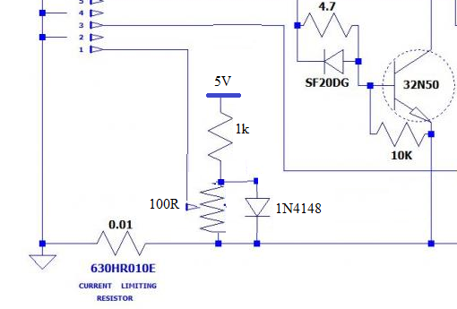

EG8010 over-current protection will trigger when it see 0.5V or higher across the sense resistor.  So, you need to scale the resistor based on the max surge current (should be well above the max continuous current) you want to allow.
Ex: Vocp=Iocp * Rsense => Rsense=Vocp/Iocp
  Vocp=0.5V
  Iocp=10A
  Rsense=0.5V/10A = 0.05R

Posts: 3412
Posted: 03:50am 08 Apr 2024
A possible work-around to allow the 0.01Ω shunt to achieve the 0.5V trip point at an adjustable current. The voltage divider adds a bias voltage to the voltage across the shunt. With the pot wiper at the top the current limit should be about zero, increasing as it is moved down to 50A at the bottom.
As the 0.01Ω shunt is rated at 5W this could be used at up to 22A without overheating the shunt.
Others with hands-on experience with these modules can advise if this will work the way I imagine.

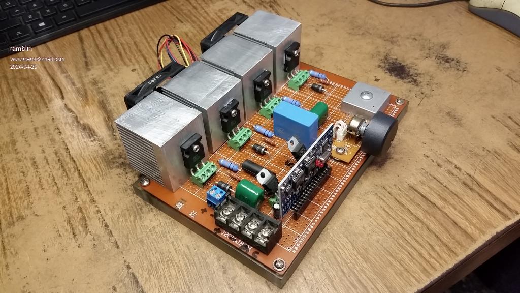

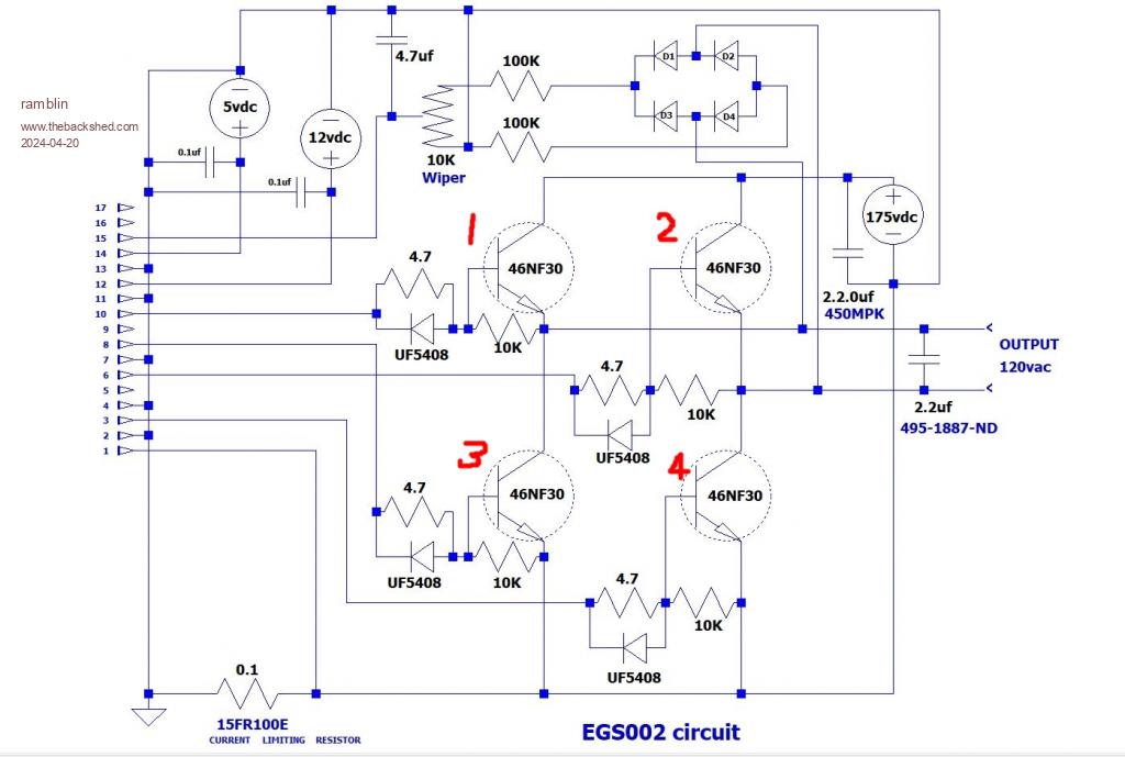

OK Guys, I have completed my inverter build. I have not yet hooked it up and applied power. I have to the best of my ability followed my schematic and doing a final check for any mistakes I made. I`m hoping the gurus here will do the same with my schematic. Any final additions or changes please. Do not assume I know anything. Thanks guys, Have a look.

Since this is on proto-typing board, and the bottom is not shown, I hope the high current paths are beefed up. It is a very nice arrangement.
Edited 2024-04-20 12:07 by tinyt

Posted: 02:22pm 20 Apr 2024
Everything with any current is Teflon coated silver plated copper 18ga. Light stuff is 20.

im not sure if anybody mentioned it yet, but make sure you remove U4 and short C19 on the EGS002 board, or it will destroy your fets if you trigger the overcurrent protection

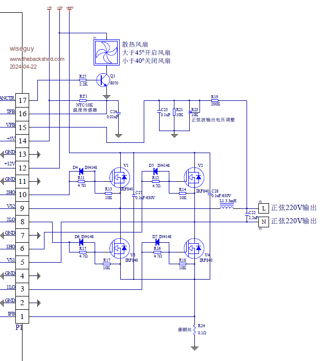

There are a few major issues with your schematic, I have posted a reference schematic from the EG8010 data sheet.  You dont have connections (or they are not shown as connected) from the bridge to the EGS002 pins 9 or 5.  The next problem appears to be the feedback you have used. If you implement the feedback - note it only uses the one bridge connection that connects to pin 9 of the EGS002 AFTER the missing choke on your board and the schematic (L1 -3.3mH), that should be between the 2u2 mains filter and the bridge that joins to pin 9.
It looks like you are aiming for 110/120VAC so change the value of R21 in the reference schematic to 56 or 68K to have a similar range as the 220V one.  Also note they do not use a 4u7 for filtering the feedback but a 100n.
From their data sheet;
"Figure 8.1b is the actual testing wave under unipolar modulation. EG8010 uses the peak point sampling to output voltage, which has advantages of accurate voltage stabilization and short voltage adjustment time. If output voltage is deviated by some reasons such as change of load or input voltage, EG8010 can recover to expected output voltage in one to three AC cycle."
With those changes you have a better chance of making it work, good luck!  To get it working, after making the connection changes, you could remove the 2u2 from your board then put the choke and 2u2 after the terminal block, but you would also have to then feed back the voltage from the choke/capacitor node of what is then the new ac output node. (if this doesnt make sense to you dont worry just make the above changes)
I have not studied your work in depth so I am not saying all else is right - it might be, I just noticed a few glaring issues, but if problems persist post again with whats happening.

also i believe you need the 5v, 12v, 175V grounds connected directly to ground, not through the current sensing resistor. else the egs002 will not see any voltage drop and wont know to shutdown for overcurrent. the current sense resistor is only inline with the mosfet bridge source returns
i use a small 240v/5v transformer for voltage feedback, 5v side connects to full bridge rectifier, then to a 10k pot, then to the 4.7uF or 100nF will work too as mike suggested. that way the ac output is fully isolated from battery negative, that way you can connect any output and/or battery negative to your solar system ground and not affect ac feedback circuit

Might as well add the voltage feedback ground to the list of things Rusty mentioned, to go to the other side of the current sense resistor - just cut the line below the 175V power supply and the 2.2.0 ? uF connection (on the schematic) and reconnect it to the LHS (ground) of the current sense resistor.  Note their schematic uses 2 x 100n capacitors across each leg of the bridge top drain to bottom source.  Why have you drawn the bridge semiconductors as transistors instead of FETs, when I put in the part number 46NF30 it returns a FET.
Now for the really really sad part, I think you will be very lucky if the FETs and maybe other parts are still alive. It looks very much like you have wired the gate drives to the drains of the FETs and the other FET connections are not right.  Very easy to unsolder the gate/drain connections you made and shift them to the left (check on that it gave me a headache doing reverse upside down 360 orientation to my tired head),  and then fix the remaining connections, if the centre of the 3 pins are the Drains the rest should be pretty easy to sort.  The FETs gate/source votage has probably been exceeded you should disconnect the 4 FETs totally and check them for correct operation - I hope you know how to do that.....
After seeing that enormous bridge rectifier too I had to check the date in case it was all posted on 1st - I hope you get it sorted and not too many parts suffered!  If you are really getting some sort of output - it has me a bit stumped how - there must be some trickery that is hidden.

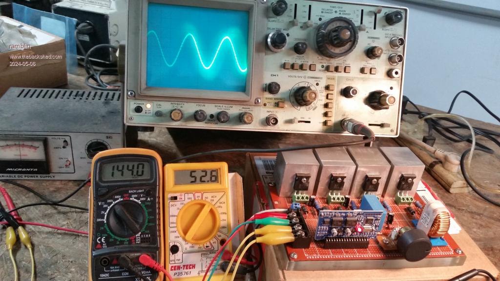

Well folks, I`m at the point that I may not be able to solve my problems on my own. My board seems to work correctly up to about 145vdc input and AC output about 50vac. Pushing beyond that only results in blown mosfets. Many blown mosfets. I believe everything is exactly correct as per the drawing posted by wiseguy.   It was suggested a 100k at R19. It was suggested a 56K or 68K at R21. Originally, I had a 56K at R21 with some control. I tried a 68K and it was worse. I then tried a 50K and seem to have 3.4 to 4.2 vdc throughout most of the working range. Much consideration is give to chokes on all the circuits discussed here. Not sure I have that right as I don`t understand chokes very well. I used a 3.3 mH @ 10 kHz... 2 Line Common Mode Choke on 1  side only. I experimented adding in the other side, even bifiler but best just 1 side. I thought my generator might be passing some weird harmonics through ( you could expect that @ at over 500 Hz.) so I set up my variac and FWBR and powered it up that way with exactly the same results. I tried with a load and without. A 40watt bulb will glow slightly at up to 40+ vac but will only blow fets if you try and get more. I tried without the 1000uf cap and blew the (2) 0.01uf caps on the board. I have lost 1 EGS already although that may have been due to faults early on. Nothing even gets remotely warm. I have studied the data sheets and many threads on this site and really don`t know where to look. Could some one here give me some ideas ? All outta fets !

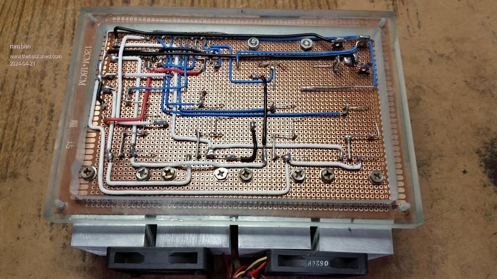

I can be wrong, but A quick look at the  bottom of your PCB and the position of your gate resistors/components indicate wrong connections, they appear connected in de drain instead of the gate, the longer I look at it the more mistakes I see, check the data sheet of the MOSFETs again.
Please check the connections again.
Also, I would place a h side and low side MOSFET next to each other and put a capacitor close between high (drain) an low side MOSFET (source), also connect the gate drive with twisted pair wire from the egs module.
