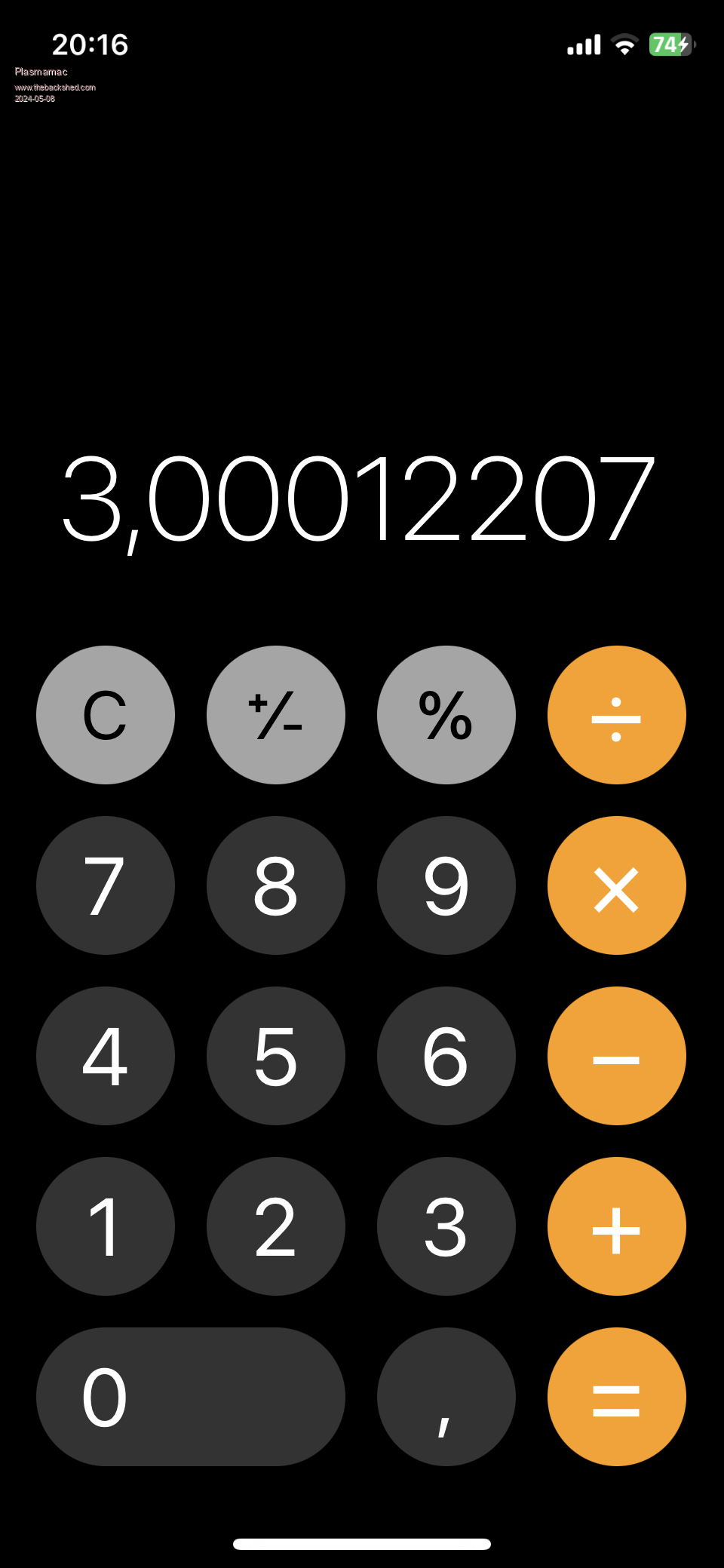

Plasmamac
Joined: 31/01/2019
Posts: 620
Posted: 06:19pm 07 May 2024
Edited 2024-05-08 04:21 by Plasmamac
Plasma
zeitfest
Joined: 31/07/2019
Posts: 701
Posted: 11:32pm 07 May 2024
Interesting thread.  What is the result on maximites or early micromites  ?
@Plasmamac, what is the screen ?

toml_12953
Joined: 13/02/2015
Posts: 720
Posted: 02:16pm 08 May 2024
  matherp said  3 + 4 * 2 / ( 1 - 5 ) ^ 2 ^ 3
is calculated by MMbasic as 3.001953125
However, if I convert that to reverse polish I get
3 4 2 * 1 5 - 2 3 ^ ^ / +
which evaluates to 3.00012207
Converting the reverse polish back to infix gives
3 + (4 * 2) / (1 - 5) ^ (2 ^ 3)
Note the 2 ^ 3 is now bracketed hence the different answer. Is the MMBasic operator precedence wrong or right?
UPDATE Wolfram Alpha also gives 3.00012207 so I suspect MMbasic is wrong
Most BASICs (and other computer languages) do exponentiation left to right.
2^3^4 = (2^3)^4 = 4096
Mathematicians, Wolfram and Python do it right to left
2^3^4 = 2^(3^4) = 2.4178516E+24
Python: 2**3**4 = 2**(3**4) = 2417851639229258349412352
Which is right? They both are! You have to decide ahead of time which system you want to follow.As long as you're consistent, you're right.
Edited 2024-05-09 00:21 by toml_12953
