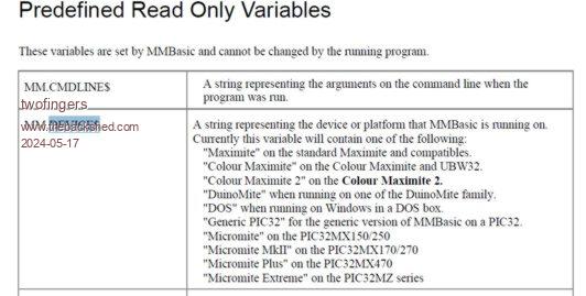

Posted: 09:45am 17 May 2024
  Martin H. said  ...
My question is, what String does CMM2 and MMB4L return if I use mm.info(device)?
MMB4W = MM.Device$="MMBasic for Windows"
CMM2  = MM.Device$="Colour Maximite 2"
From CMM2 Manual p52:
Best regards
Michael

Posted: 09:53am 17 May 2024
Hi Tom.
  thwill said  "Colour Maximite 2" or "Colour Maximite 2 G2", so use:
That's interesting! The manual should get an update.
Best regards
Michael

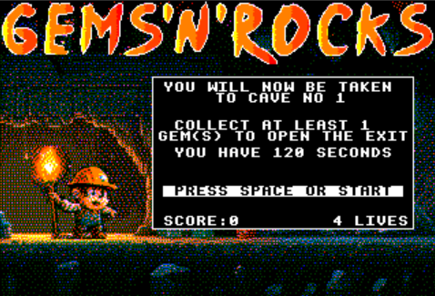

Posted: 09:45am 20 May 2024
So here we have it:
* GEMS 'n' ROCKS *
a vintage maze puzzler in which player collect diamonds before time runs out.
Principle based of the BoulderDash published in 1984 by First Star Software
Game and Music written by Martin Herhaus 2024
Game-Controller support by Thomas Huga Williams (thwill)
For picomiteVGA V5.0708 or later and supports PicoGameBoard NES Controller on Port A
Game*Mite, CMM2 and MMBasic for Windows 5.07
Terms of use:
This program is free to use software and may be redistributed as long as this
text is not modified or deleted but feel free to cange or add Caves
  Quote     WELCOME TO GEMS'N'ROCKS!
GET READY TO NAVIGATE THROUGH INTRICATE CAVE SYSTEMS, COLLECT PRECIOUS
GEMS AND OUTSMART TRICKY OBSTACLES.
SHARPEN YOUR REFLEXES AND PREPARE FOR AN ADVENTURE LIKE NO OTHER"
   PRESS SPACE OR START TO LET THE FUN BEGIN!
Have Fun
GemsNRocks.zip
Martin
Edited 2024-05-20 19:55 by Martin H.
