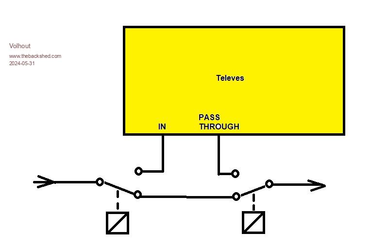

Posts: 6101
Posted: 07:39am 31 May 2024
Grogster,
I have no idea about the size of the network, and if the back channel is used as well (internet), or that it is only 1 direction.
In case it is one direction and a relatively small network (20 houses or so) you may be able to beef the signal at the input (the antenna's, the head-end) and use passibe -20dB pickups (splitters) at each extension (input of the Televes)(*). These are passive, and will pass signal to the next regardless the Televes is powered or not.
In case the network it is larger you can use a similar topology, but you need active splitters. I know these exist. The active splitters can be powered from a DC voltage that is added to the RF on the COAX. This is common technology in satellite connections (1-2GHz) but will also exist for TV signals.
Another option could be to add a coax relay to the pass-through connection of the TeleVes. Power the COAX relay from same 230V (phone charger) that poweres the Televes.
Once the Televes looses power, the COAX relay will switch to pass the input signal of the Televes to the output. The next houyse will get a slightly weaker signal, but it may solve the issue.
(*) since the signal gets weaker due to cable losses and signal being routed to Televes units along the run, the first houses may need -20dB pickups, the later houses -10dB or -6dB or -3dB.
Edited 2024-05-31 17:49 by Volhout

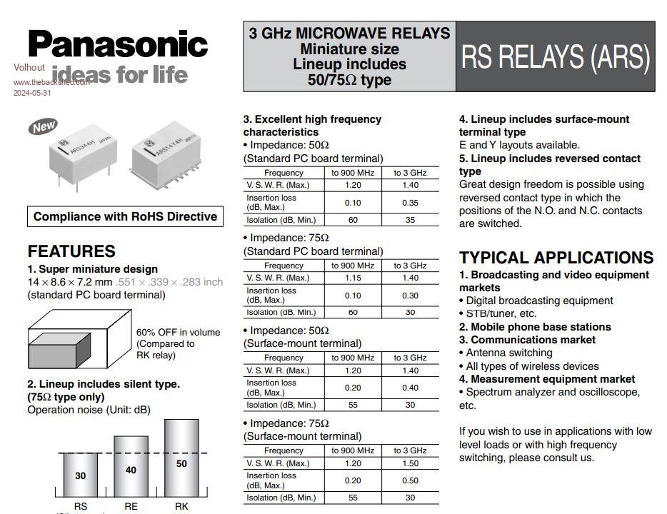

Posts: 6101
Posted: 08:15am 31 May 2024
Something like this (make a small PCB, but make sure you design for 75ohm tracks, and use suitible connectors).
And this circuit:
Posts: 10036
Posted: 11:06pm 31 May 2024
Yes, that is another good idea - had not considered coax relays.
Something else to think about.  Lots of lovely ideas being thrown around here - thanks chums!

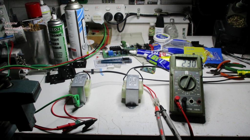

Posted: 08:46am 06 Jun 2024
BENCH TESTING:
This is the very standard HV-LV-LV-HV transformer arrangement. (sometimes called HV-LV-HV)
A happy 230vAC at the other end of the 100-meter link of speaker cable. (no load)
Yes, I laid the entire roll out flat, I did not leave it all coiled-up on the roll, which would affect the results.
Please ignore the direct 230v outlet to the clips of the "TX" transformer - this is NOT something anyone not competent with using live 230vAC should EVER use, but I have been using "Hot leads" like this for years, and due to my training, I know what I am doing.  Note I still wrap the phase up in PVC tape.
...but I digress in the name of safety...
There is nothing special about this photo - it is basic transformer theory from the days of old and when we ALL learned about the benefits of AC power distribution.(vs DC)
These transformers are single-phase 230vAC input, and 30vAC output @ 1 amp.
The next thing to try, is seeing if a relatively modern switch-mode PSU of 15-20W, can start using the relatively high-impedance "New" 230v supply.  I plan to use a Video Cassette Recorder as an experimental load, as it is about the same 15-20W load I am expecting at the far end for the TV amps, and therefore any "INRUSH" start-up current should be something of or about the same figure.
Enough of this!
I'll keep the thread updated!
Beer time now!

Posts: 10036
Posted: 11:38pm 06 Jun 2024
  Volhout said  Hi Grogster,
A system like this would present a relatively high mains impedance for the Televes units. Especially including the long wiring runs.
Totally agree, and that is why I wanted to do at least a basic bench-test of the concept before I do anything on-site so to speak.  As you say, the "RX" 230v for the amp, is going to be relatively high-impedance compared to connecting directly to the mains(which is relatively low impedance), and so I just want to see what happens on the bench first.
The first test will be the VCR - if it starts and runs OK, I will then do some AC-clamp-meter current testing, followed by a TEMPORARY connection to one of the Televes amps that feeds the smallest number of units, then I can also put my digital TV and/or spectrum analyser on the output of the amp, and see if there is any dramatic change in output or signal level - QC check etc.
All of this is just experimental at this point - nothing set in stone - don't worry!
Posts: 10036
Posted: 05:22am 08 Jun 2024
UPDATE:
Despite the relatively high-impedance of the "New" 230v out of the receiving transformer, the test VCR started up just fine with no issues, and it is a SMPSU based unit.  Current in the 30vAC side of the link, is around 350-400mA, which sounds about right.
I might try loading it up with more stuff, just to see how far I can push it!
But this is encouraging, so the next step will be to connect this arrangement temporarily to a phone pair, and see if I can start one of the Televes amps on it.
I have more testing-and-monitoring to do yet, but the initial test worked well, so that is a plus!
I was kinda expecting the VCR PSU to not start due to the high-impedance of the "New" 230vAC.  Most(if not all) SMPSU's have an initial inrush current that can be upwards of 20A or more, just for a fraction of a second while the PSU gets running.  The low-impedance of the normal mains handles that without issue, but the high impedance of this kind of setup can often prevent SMPSU's from starting at all.
Mains inverters had that as a common problem for YEARS, but it seems that the pure sine-wave inverters are much better at handling startup surges.  But historically, many an inverter flatly refused to start anything with a SMPSU in it!
