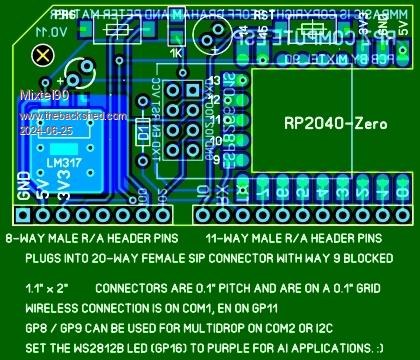

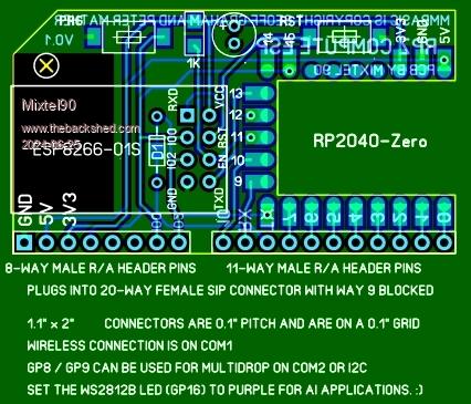

So, that's a ESP8266-01S version done.
RPZ COMPUTE ESP
Has a RP2040-Zero with a ESP8266-01S wireless modem module connected to COM1. The ADC connector and GP11-GP14 are omitted. GP15 is connected to the INT signal. Buttons are provided for the RST pin and IO0 to assist with programming.IO2 is brought out on GP11 pin of the module and IO0 on GP12 pin.
If anyone wants any of the modules in this series, or would like me to produce another version, please let me know. I'm not publishing further design details at the moment as I'm still playing (as you may have noticed...). :)

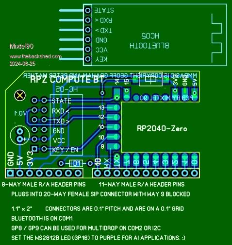

I'm considering putting four modules together on a single PCB so that one order will get you five of each. Probably the original, VGA, BT and ESP but I'm open to any ideas. Unfortunately I can't really get any more than four on - and you'll need to cut them, although JLCPCB would almost certainly cut the notches for the RPX2040-Zero.

For the ESP: it needs far more 3.3V power than the regulator on the ZERO can deliver....

Posts: 8967
Posted: 08:56am 25 Jun 2024
The ESP is specified as taking a maximum of 170mA. I've included for an electrolytic cap on the 3V3 rail to help with higher current spikes. The regulator on the RP2040-Zero is the RT9013, which is rated for a minimum of 400mA (under ideal conditions!). Allowing for around 50mA for the Zero, that should probably allow at least 200mA comfortably for the ESP. There'll be just about nothing spare for any external loads, but it would be ok for using the GP pins as inputs.
I'll sort out some piccies. :)

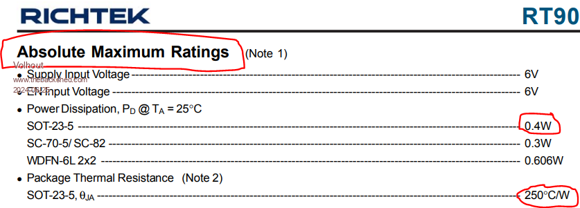

Posts: 5995
Posted: 09:30am 25 Jun 2024
Hi Mick,
170mA + 50mA = 220mA (pico = 50mA when running 133MHz)
5V - 3.3V = 1.7V
1.7V * 220mA = 375mW
It is within spec, but I would not rely on it. It will get extremely hot, and when it reaches thermal shutdown, you will loose both WIFI and Pico, or they run very unreliable.
Edited 2024-06-25 19:31 by Volhout
Posts: 8967
Posted: 09:44am 25 Jun 2024
Oh well, it is what it is. :) There's no way to get it's own regulator on there. The only place for it is directly under the antenna, which isn't going to help the range in the least. Of course, you *should* be running it at lower power to keep within most countries RF regulations...
As I've never had any success with these anyway I'm not too fussed. It's unlikely that I could test it. lol
Having said all that, here's V0.11 with added LM1117 goodness. (Yes, I wrote the wrong number on the silkscreen! It's not important, the connections are right.) The antenna ends up about 10mm away from the back of the Zero so it might be ok.

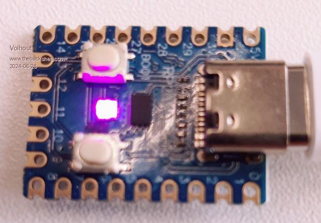

Just received my first ZERO, and it is running AI...;)
Posts: 8967
Posted: 12:51pm 28 Jun 2024
Oh yes, they are good at that!  :)
But why, oh why does it have castellated holes when it's so awkward to surface mount, and the YD-RP2040 would be great for surface mounting if it had castellated holes? Sometimes I just can't win. :)

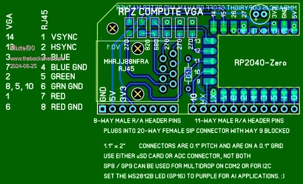

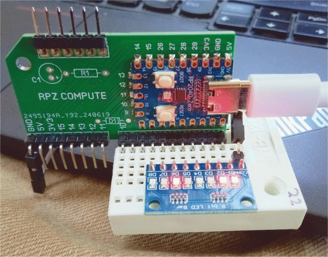

Posts: 3820
Posted: 05:59pm 19 Jul 2024
First time seen in the wild?

Posts: 8967
Posted: 06:23pm 19 Jul 2024
Yep, AFAIK that's the very first. It looks rather cute.  :)

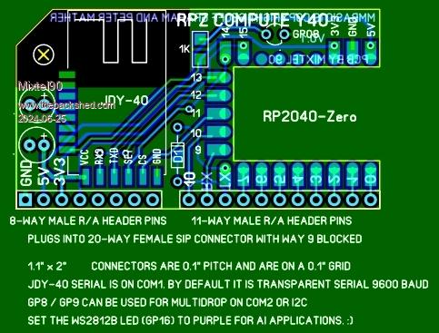

I'm putting together two 100x100 boards with multiple modules on them. They'll need cutting. It'll be a very cheap way to set up some experimental setups.
Board 1 has a 3-slot expandable motherboard and a RPZ compute module
Board 2 has Bluetooth, ESP8266, VGA (over RJ45), a short board with indicator LEDs and one spare position at the moment.
Now, what do I populate the spare position with? There is a choice of:
1 - JDY-40. One of my favourites which is a wireless modem in this case (no access to the GPIO pins).
2 - isolated COM (like a MIDI interface). I thought this might be an interesting substitute for RS-485 over shortish distances, with the bonus of isolated supplies.
Those are the only other options I've come up with at present.
Unfortunately I can't quite get 6 modules on a 100mmx100mm board, only 4 and a short one (which isn't long enough for a Zero to be useful). Doing a third board shoves the cost up.
I've not priced it up yet, but I wonder if it would be worth trying all the lot on a single board?

The JDY-40 now has pins GP01, GP02, GP03, GP04 and GP05 brought out on the GP10, GP11, GP12, GP13 & GP14 pins of the IDC connector. GP08 drives an LED as before. This allows it to be used as a remote control by operating pins GP01 to GP05 to get a remote device to operate its pins. This operates independently of the Zero. It can also receive a byte and bits GP01 to GP05 can be fed into GP pins of the Zero. Of course it can still operate as a 2.4GHz wireless modem too.
