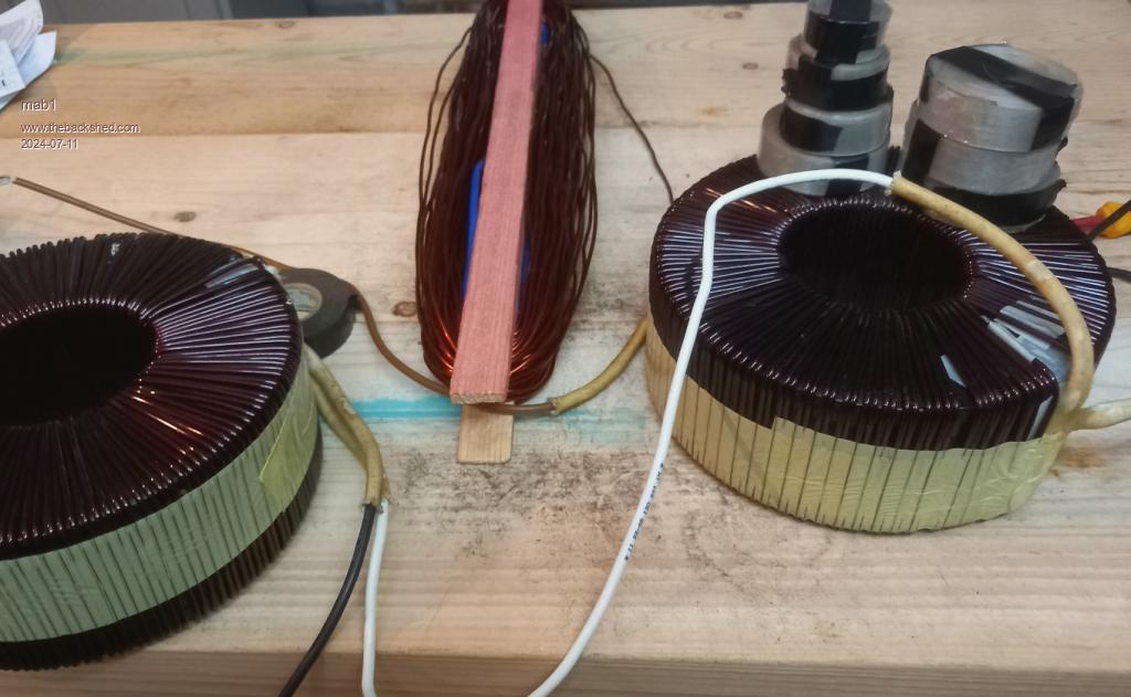

Well this is interesting:
The toriods were tested one at a time when verifying each individual output. The three stack obviously had a different primary winding. I was simply looking at the power on an AC mains meter, like the one on the front of the Inverter. I was only checking for a steep transition in power and looking for an indication of the beginning of saturation and simply noted the power for each voltage.
Each winding is 93vac on the series three stack, and the first winding on each core.
I looked at power at a nominal 230V output when wound for the same AC input design voltages I would use for my inverter, again using a variac.
When built, I then looked at the DC input power to the inverter at idle for the three stacked toriods, and it was close to the same power as a single smaller aerosharp in the inverter, and the same as, and in many cases way below other single toriod inverters, both toriods were wound to produce the same AC output with same input as above, and the power just happens to be within a few watts with my crude testing with a variac for both.
I cannot tell if my inverter is running three toriods or a single toriod by looking at inverter Idle power.
Hopefully you can document the correct method that we should all employ, so ongoing individual tests will all compare like for like, it's all a learning curve, and that would also be valuable for future reference.
Perhaps a procedure for both inverter idle power and initial variac testing comparisons would be of great help.

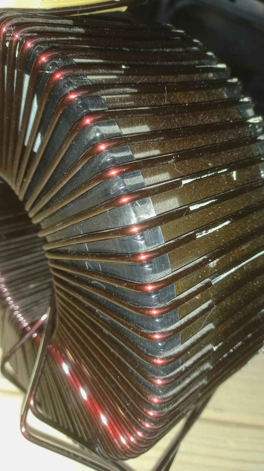

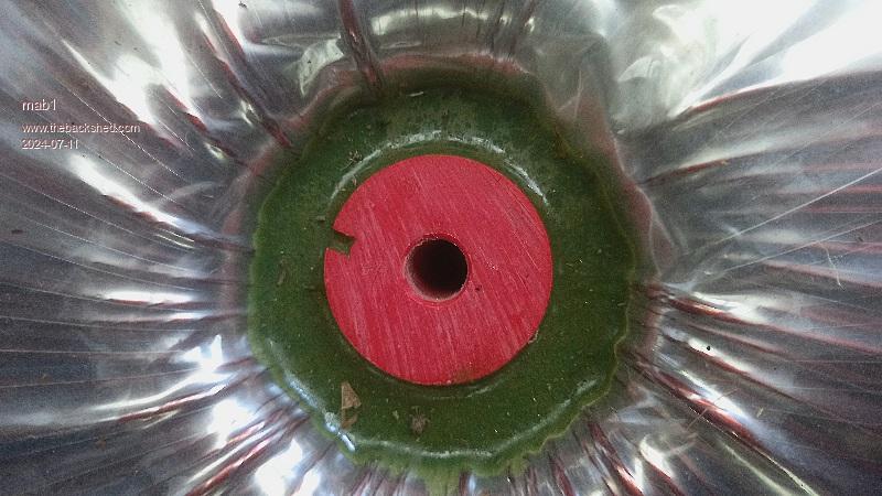

Slow progress: i forgot how hard the green potting in the transformer centre on the 1st santerno was - I'd swear it's harder than concrete
But once I'd chiseled a bit of the splayed edges out i was able to drive it out with a hammer, although i will need to grind a new tip on the chisel.
So unwound the mylar tape, the outer 230v winding, and about 6 more layers of mylar tape, and now have a matched pair, each with 155 turns.
So after a pause to recover from unwinding, i can start unwinding for 121 turns each, which would leave each core with 1 1/2 layers of winding and the wires coming out on opposite sides
Although, there is a little (purist) voice suggesting i could unwind them completely, stick them together and wind just 61 turns back on - probably depends on how masochistic I'm feeling

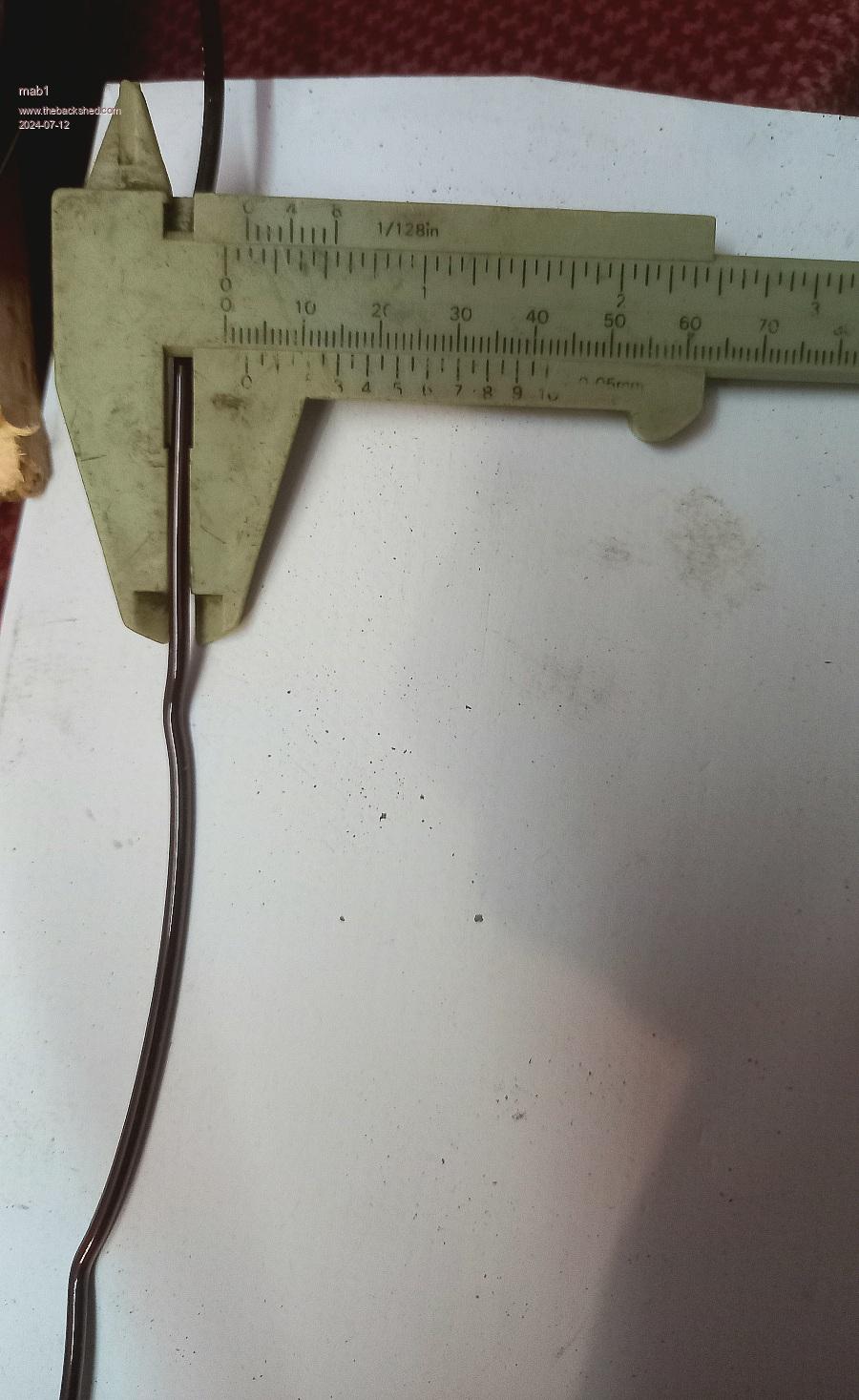

 I'm still procrastinating as to which way to go. I am leaning towards unwinding completely, but if i go that way i must un-kink the wire to rewind.
I've unwound this one to 121 turns:
I've been looking at old posts to see what others have done and there seems to be a method of pulling through three bearings to flex and straighten the wire (oztules?), but that presumably work hardens the wire, and it looked to be thinner wire than these (the 230v winding is approx 2.5mm diameter; the 180v 2.8mm diameter).
I managed to mostly dekink the 2.5mm with my thumbs but the 2.8mm is kinked tighter and doesn't unkink so well   so I'm wondering how much of an issue slightly kinky wire is - with just 61 turns it doesn't have to pack tightly
These cores actually have black plastic 'end caps' (see pic above), approx 1.5mm thick so i was thinking they might be re-used for corner protection?
I certainly could add a temp probe - although with a double stack i shouldn't ever get it hot.
Edit: actually i can still remove most of the kinks if i 'reinforce' my thumbs - but  dekinking is a slow process

I haven't had much experience unkinking anything over 2mm, so not sure how much extra effort is needed.
I do understand the concept of reinforcing your thumbs  ...  that is exactly what I did for winding the toroids I have done. I bought a few of those rubber "thimbles" they use for ??? counting money or  ???  ...  and put them on my thumbs and a couple other fingers and then a pair of gloves  ...  which enabled me to put a lot more pressure on the wire.
Many years ago I wound hundreds of motorcycle coils with 2 - 2.5mm wire and my thumbs curl up everytime I think of the task  ...  so some extra protection is well worth it.
As far as unkinking the wire  ...  I anchor one end and walk along pulling a big wad of rag along the wire to get it straight  ...  and yes I might also have to go along using my thumbs to take out any severe kinks  ...  and then use the rag again.
I also sometimes grab the free end with some vice grips and physically stretch it. That also seems to help.
Being a cheapskate, I reckon the extra time and effort to straighten it would still be well worth the saving over having to buy new wire  ...  though there is no question, using new wire is a lot easier. Good luck with your decision.

I have 'unkinked' 2.5mm wire and yes, it's not easy.
I use a 3 roller device, the rollers are the sheave type for rope, they keep the wire captive as you pull the straightening device along it.
It won't straighten in one pull, for that size wire the process needs to be repeated 3 or 4 times before the wire is good enough to wind around the core.
Loop the straightened wire not less than 30cm diameter to transfer onto a winding hoop. But with that thick wire and not many turns a hoop may not be required.

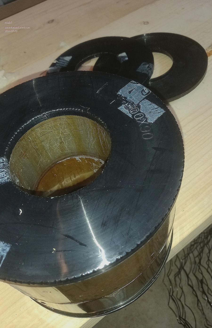

Posted: 11:28pm 12 Jul 2024
No going back now :
So that's 200 x 90 sure enough. That makes the iron x section 55 x 156 high = 8580mm2

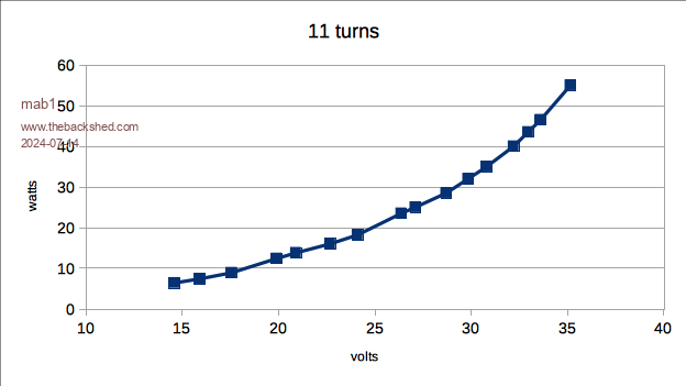

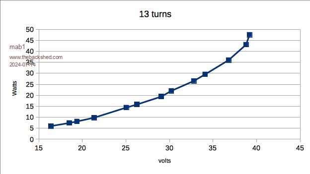

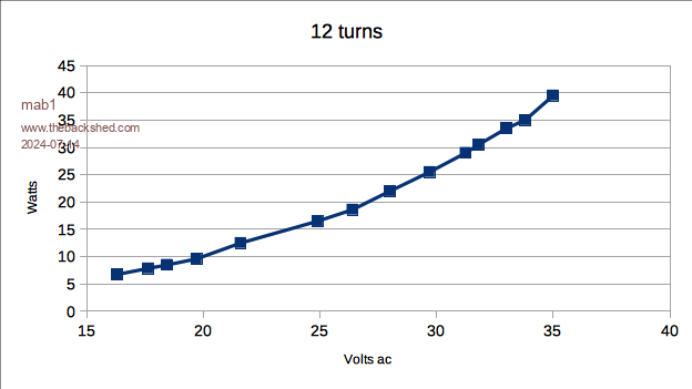

I was thinking about winding a test primary on the double stack when i realised I'd made a glaring error when i thought my secondary would be 61T on the double stack:-
61T would mean 4v per turn and a primary of 6 or 7 turns? For 48v? Wiseguy was estimating double that!
But I've worked out where I went wrong: i was thinking 121 turns on a single core = 61 turns on the double, but i was forgetting that 121 turns gives me 115v per core, and series connecting them in a keepIS stack for 230v. If i want 230v from my double core i still need 121 turns   , or thereabouts.

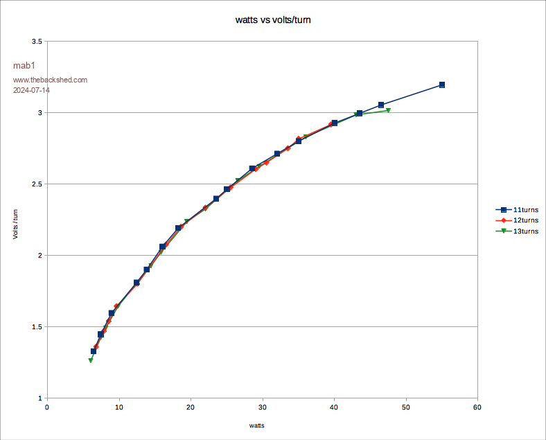

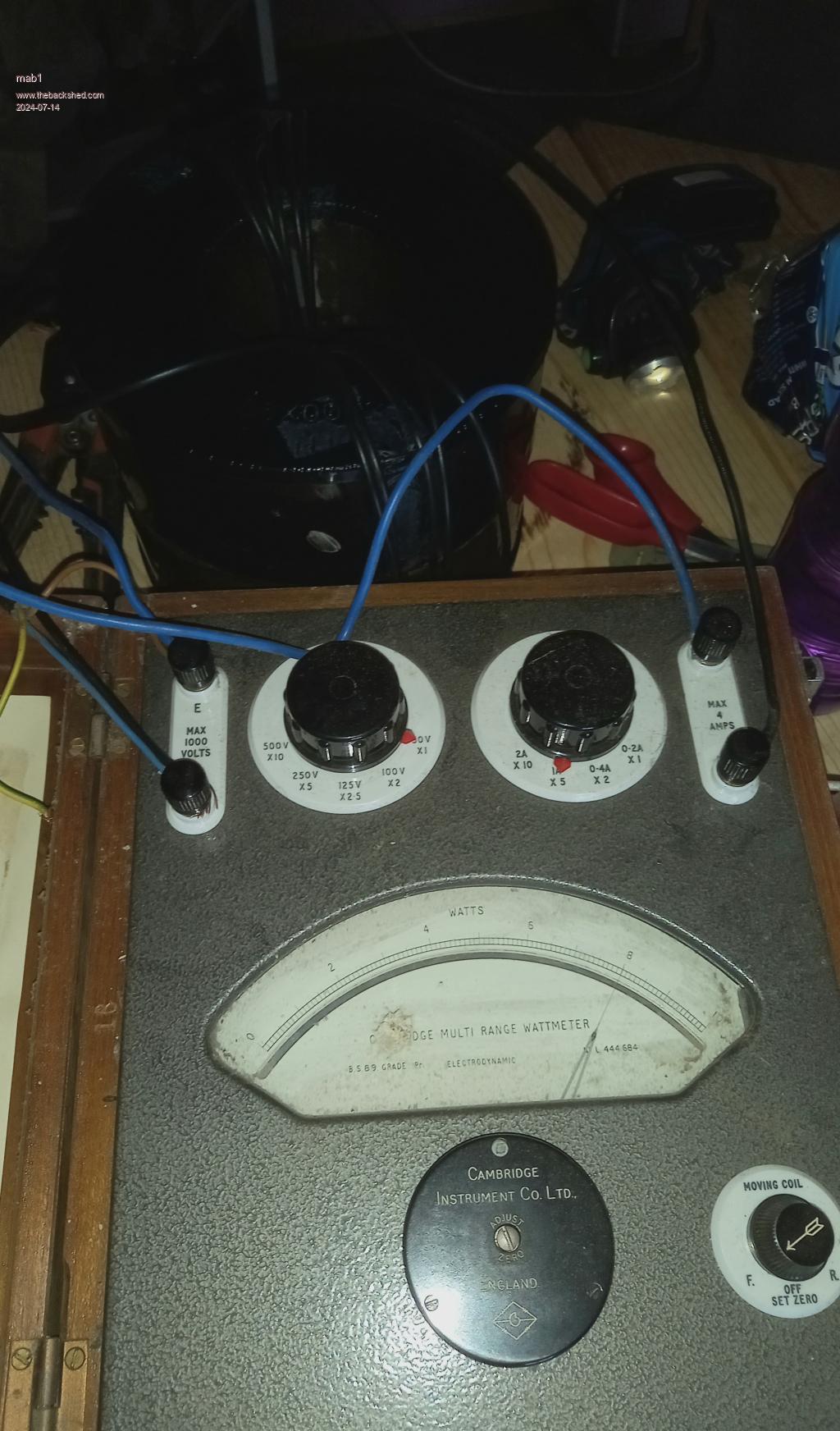

So I've done some variac measurements:
And even made some fancy charts:-
Then i realised i was just duplicating the same data: so i put it all on one chart scaled in volts per turn.
There's the odd dodgy result:- the diversion controller was turning the 3kw immersion on and off and if it switches between my reading the wattmeter and the voltmeter there'll be an error (if only i had a variac that didn't vary it's output volts with input  )
