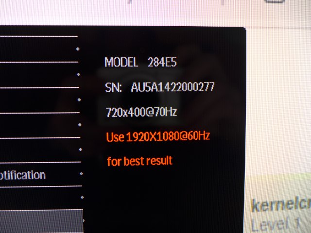

Posts: 2542
Posted: 06:36pm 15 Aug 2024
  matherp said  720x400 is an old vesa standard and I can find no evidence that it has ever been supported over hdmi. Lots of posts from people who want vga to hdmi converters for 720x400 and no solutions
works fine for me, on a relatively new 27" philips 1080p monitor over an HDMI connection:
the mode predates VESA, and is a part of the VGA and original BIOS specifications, accessible as modes 2 and 3. i suspect many motherboards would have required it to be supported to use a textmode bios setup.
but, a width of 720 pixels may still be beyond the abilities of the RP2350, and i am just offering it as a suggestion without any expectations; likely i'd be the only person who would use the mode!
rob   :-)

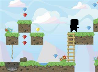

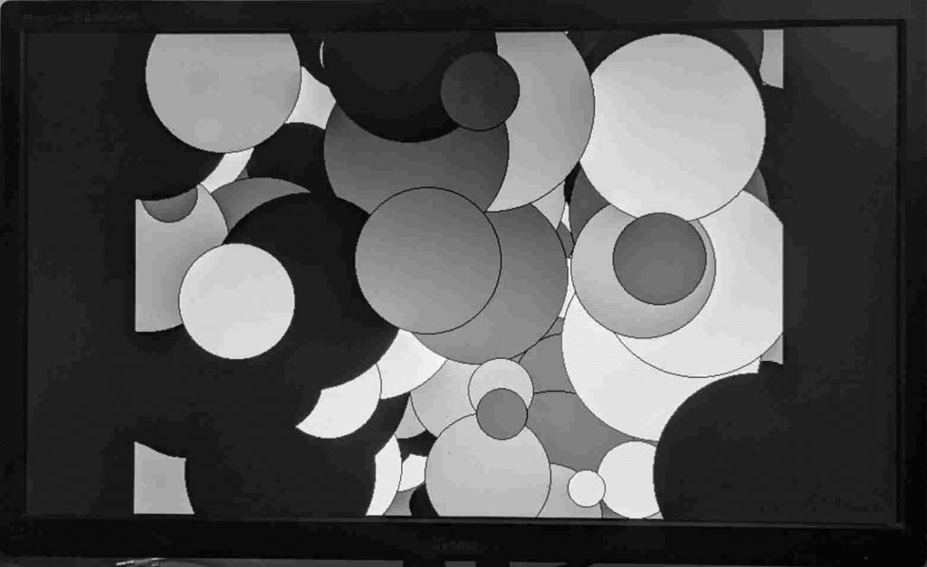

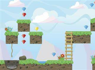

Posts: 11654
Posted: 04:49pm 16 Aug 2024
Demo of the five video modes on youtube

Posted: 05:08pm 16 Aug 2024
Looks great, thanks Peter, the colours used can be any of the 255 possible ie rgb332, so somewhere you have to define the mapping, of say the 16 colours to 16 of the 255 possible?
When will there be a alpha, ;-) looks like my new shiny pico will arrive tomorrow, (or the next day) depending on postie. ;-)
