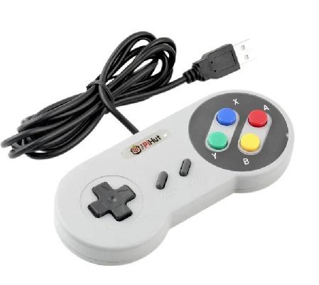

Nobody has actually said it, but I believe this is what we are talking about as an example of the generic USB controller at a reasonable price:
https://thepihut.com/products/raspberry-pi-compatible-usb-gamepad-controller-snes-style
Note it also has two shoulder buttons (L & R) that you can't see in this picture.
Edited 2024-09-13 21:52 by thwill
Posts: 8966
Posted: 11:57am 13 Sep 2024
I have a couple of those but I don't write games. :)
